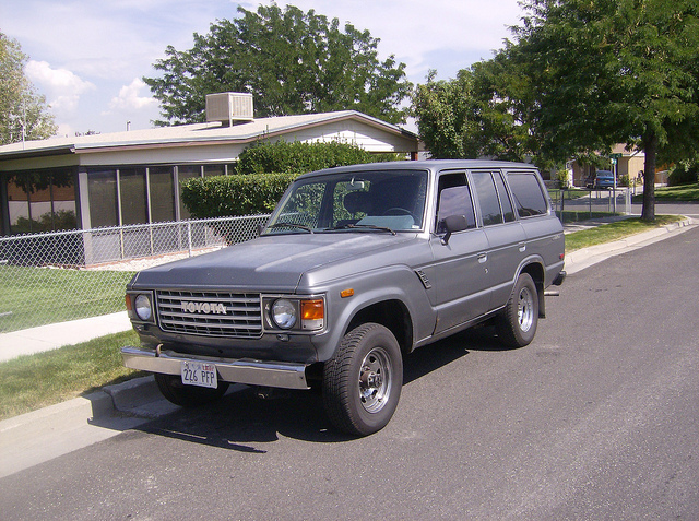

So here is BeBe the weekend I picked her up in 2012 (mismatched 235/75r15)
HPIM1267 by renofizz, on Flickr
And here she is today, new 31x10.50x15 Cooper Discoverer S/T Maxx
Untitled by renofizz, on Flickr
