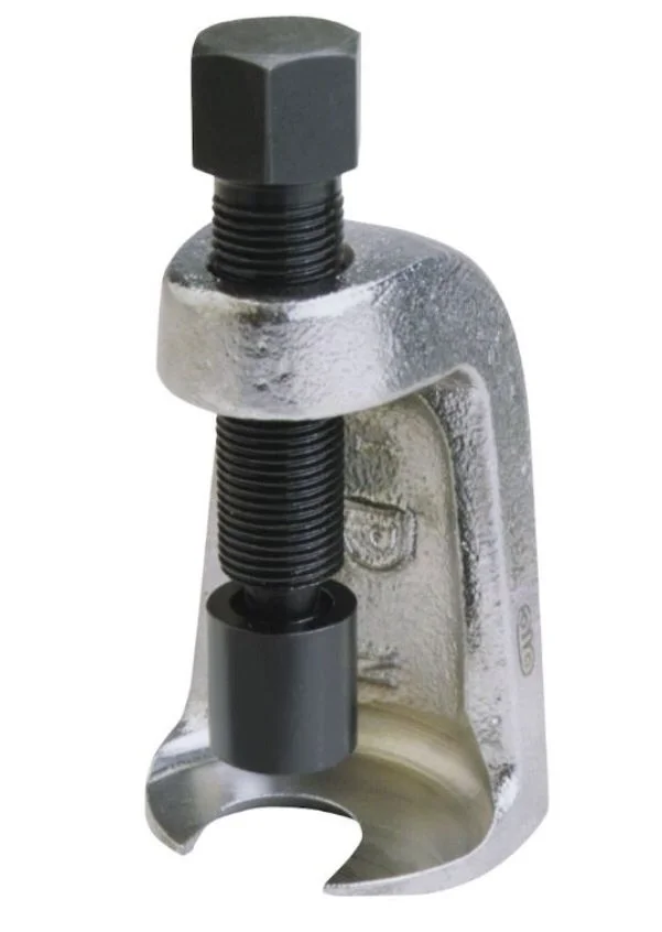

If they've been on since '83, you'll need lots of beer!
This puller, a big pipe wrench or two, some penetrant, and some heat will make it go fairly smoothly.
