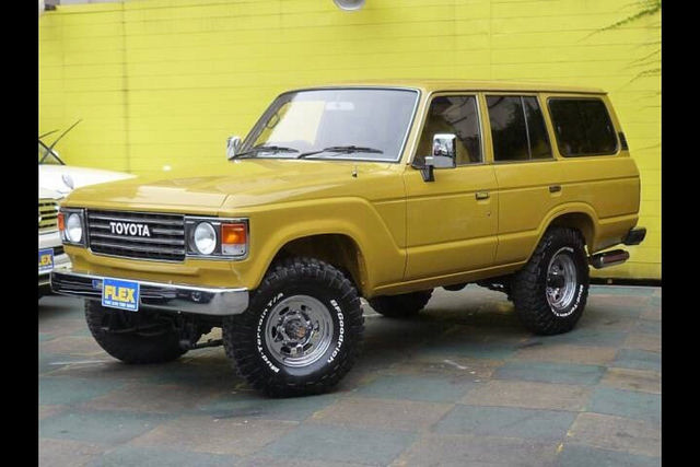

Well spank me silly and call me Sally! Everyone of you know how much I love the 464 Beige color and had always wanted to get one before I got BeBe. Well with the need of a paint job I have always contemplated what the 60 would look like in the 40 Mustard Yellow color with a white top as that is another color combo I have loved (even though mine is 8B4 midnight blue, now gray from the PO). When I comes to actually purchasing the ML to do the entire truck it has been a toss up with just going with the standard grayish colors, or ML has their Midnight Special (dark blue) color that I have somewhat liked. Well randomly this morning I found a pic of an FJ60 that had been painted Mustard Yellow, and all I can say is DAMN!:bang:
Found this randomly online. Always loved the look of the Mustard Yellow FJ40 and wondered what it would look like on a FJ60. Now I know and think this might have to happen. by renofizz, on Flickr
