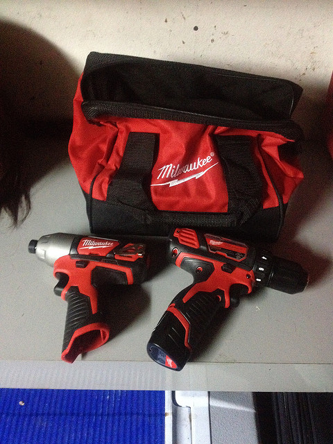

Well thanks to my BIL and buddy I got some new toys. The BIL, who is a master plumber and I had been talking about what tool brand to get and was looking to get either Dewalt or Porter Cable, just looking for something cheap at the time. Well he is a BIG Milwaukee fan and ended up showing up at my house with a late birthday present.

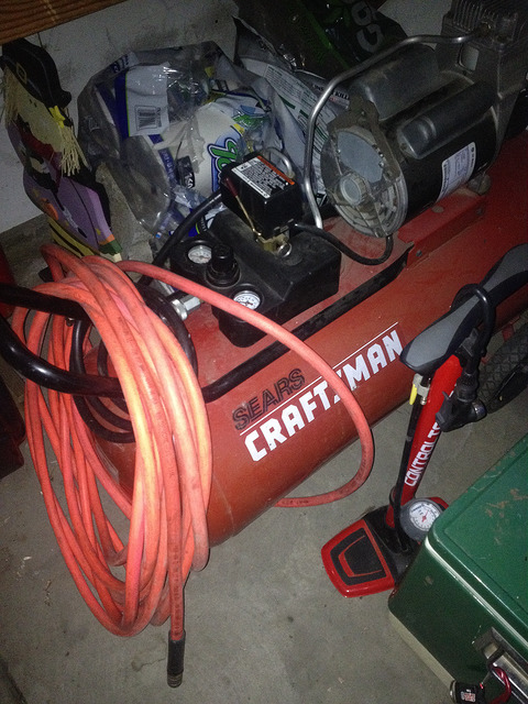

Then talking with my buddy who just bought a new house with a huge barn as his work space he gave me a new toy, his 16gallon craftsman air compressor to "mount tubeless tires with" on our mountain bikes (of course he bought a 60gallon standing unit for the barn).

I have Milwaukee, DeWalt and Makita cordless tools and always go for the Milwaukee.... My DeWalt 3/8" impact and drill (3 years old) look brand new...
One of the best tools I've bought is a Milwaukee 1/2" cordless impact.. other than my MATCO 1/2" (battery life SUCKS but much stronger) Once again my go to brand.... Milwaukee..
NICE SCORE G
J
Yeah the little M12 (regular kit not brushless) was a little monster at getting through the frame/nut/bolt/whatevermetal. Definitely glad I had it and he was trying to get me to buy the 18v kit which really I was more interested in the form factor of the M12 set more than anything. Great little kit so far.
I bought the Dewalt 12v kit and couldn't be happier. I've drilled many holes through my frame with that goofy Drill. I've never tried Milwaukee stuff, but the battery on the 12v set looked half the size of the Dewalt.
Plus the dewalt was 150 bucks with a sawsall Drill driver and 2 batteries.
Tools are one of my many financial weaknesses.
Thanks for the Milwaukee recommendation, I'll give em a go next time
Yeah the kit the my BIL got me, which I was looking at, was normally about $150 and came with drill, driver, two standard batteries and one XC (not the XC 4.0) extended life battery.
