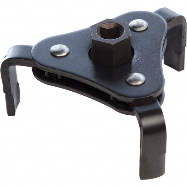

This is the oil filter wrench I use. Just used it this past weekend on my 1KZ oil filter, also works great on my big block Chevy's oil filter.
Make sure you have it set to tighten the jaws on the filter when you're turning counter clockwise. If it's not, open the jaws all the way and rotate the center hub to flip the arms the opposite direction. Mine came set the wrong way out of the box and would have been useless, loosening the jaws while turning counter clockwise. I'd expect anyone on this forum to be smart enough to figure that out, but some reviews mention this problem and apparently they weren't able to figure that out.
