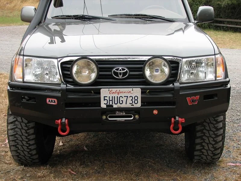

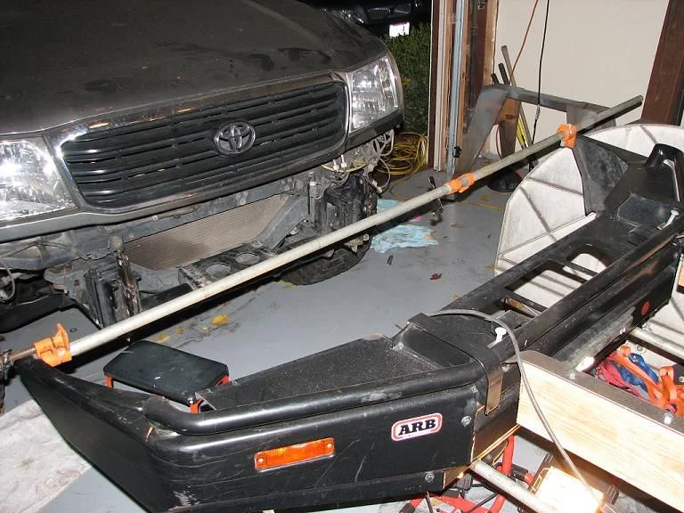

ARB Winch Bull Bar w/ custom tow hooks

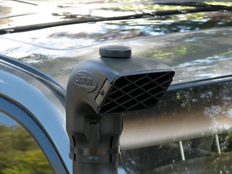

Safari Snorkel w/ GPS

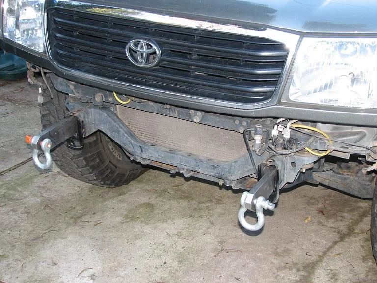

looks great!
can you elaborate a tad on the tow hooks if not found elsewhere?
I really like the mod'd ARB bumper!
You d'man Snook! Look'n good! And the on-board shower...too cool!
Great truck and nice choice of mods. Love the tweaked front bumper. Bye the way, your videos are killer!

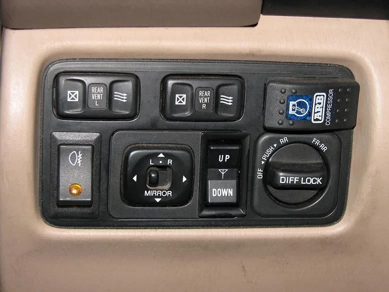

ARB lockers
After my front axle exploded at (moderate) Slick Rock trail. Duh, I forgot to enabled center locker but that's ok with me.
The ARB lockers was installed and regear to 4.88 (due to 35" tires) on both front and rear axles.
However I found the ARB locker switches a bit too cluttered on my dashboard and too close to my knee. Thanks to Rohitash, two ARB locker switches was replaced with single Toyota dual locker.

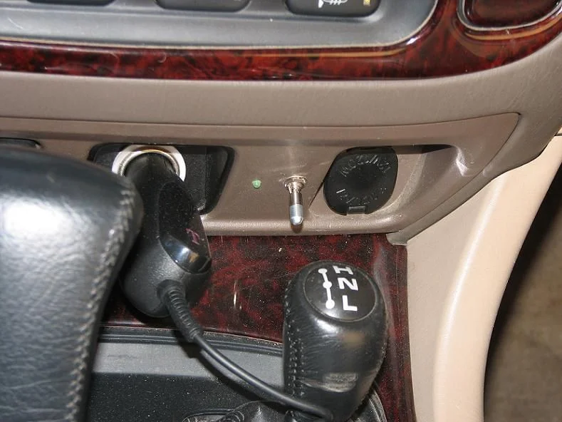

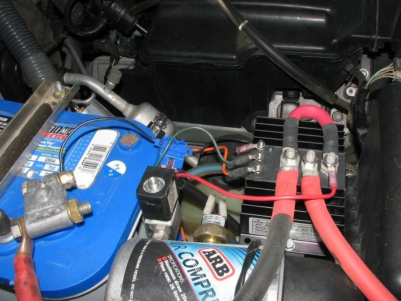

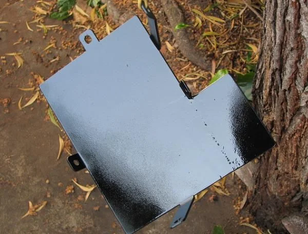

Hell Roaring
I always feeling uneasy with a single battery on my truck.
Everytime my wife borrowed my truck and returned (intacted), the next day the battery is dead. I don't know how she managed to that.
So I decided to follow Amando's dual battery setup so I ordered Hell Roaring unit.
As for holding the second battery, Slee battery tray was used but I decided to enlarged it by adding piece of sheet metal to the side of tray for fuse block.
Based on Amando's , the Hell Roaring switch was installed next to 12v plug on the center console since I know that every slots on the left dashboard will be taken.

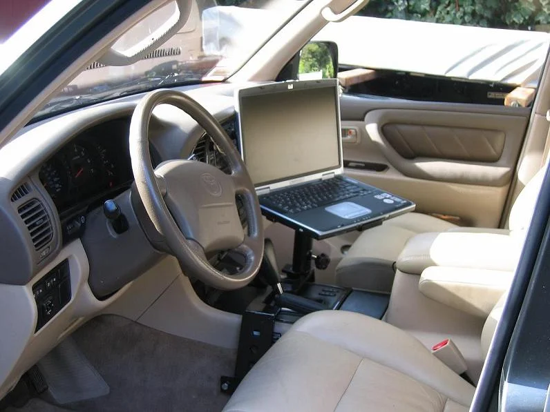

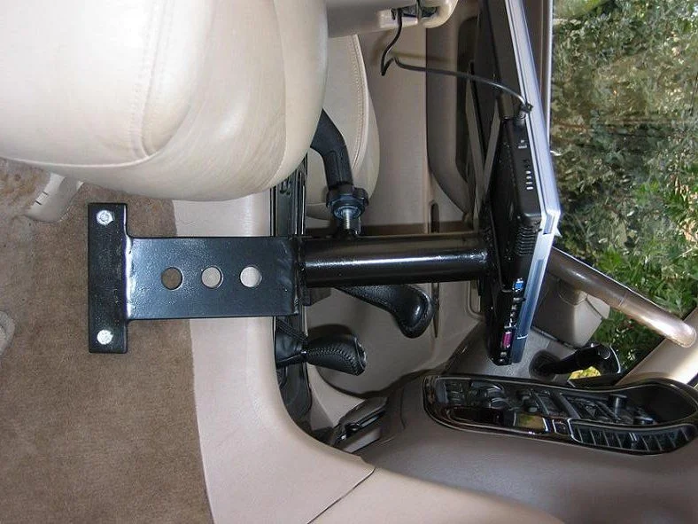

Laptop holder
I used my laptop for my work daily between six remote branchesa and want to use it for offroading trip, too.
The application is Google Earth Pro & Franson GPS Gate w/ Garmin USB 18.
Instead of drilling on the side of transmission wall (it is only a sheet metal), "very large visegrip" holding both side of transmission wall is preferred.
The tube is swivelable and removeable when not in use.

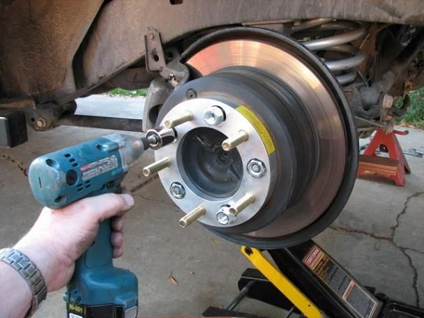

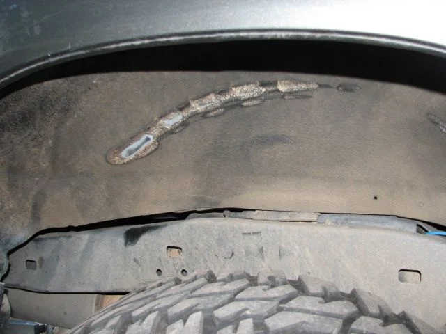

1" Spacer
During the tight turning with MTR 315, it is rubbing.
During the extreme frame twister, the rear tires is rubbing inside.
Not anymore for both after the installation of 1" spacers.( I still preferred 1/2" spacers but it doesn't work that way.
