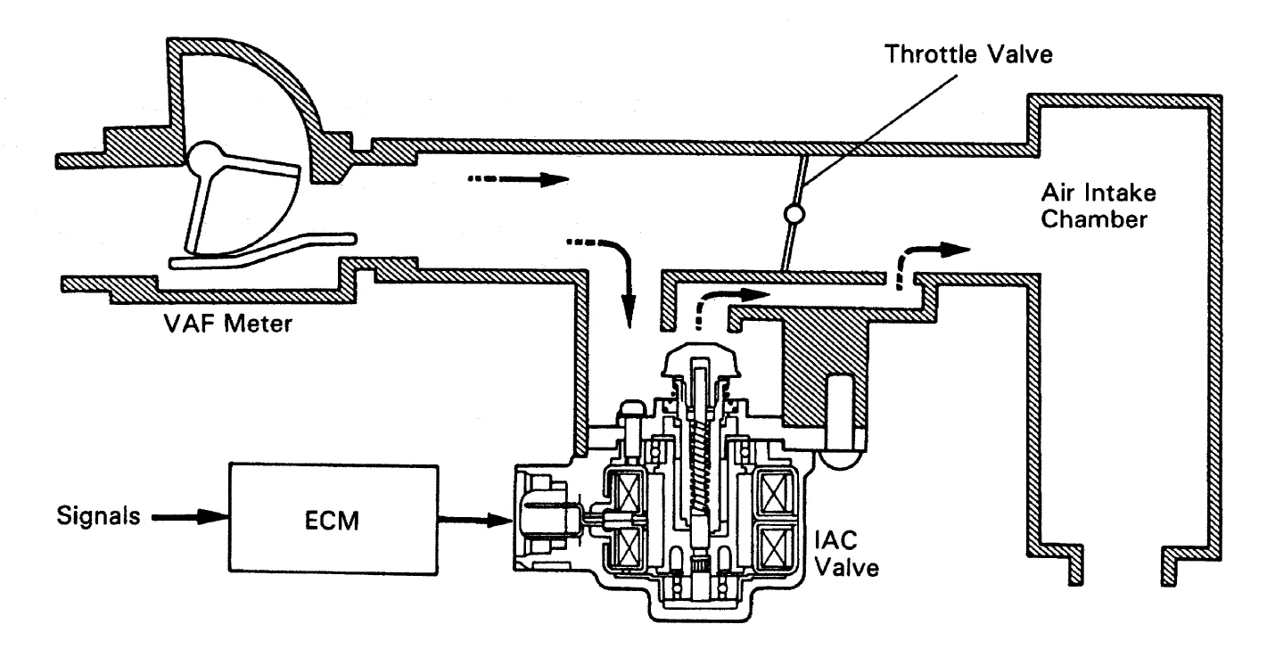

Plugged bypass in the throttle body?
The IAC plugs the bypass when it's closed (when the throttle is open), and allows airflow into the bypass when it's open, allowing airflow at idle, when the throttle body valve is (mostly) closed. If this bypass is lugged with oil/carbon, etc., and the throttle body vale is closed at idle, the engine will stall.
Could you elaborate on that more? I didn't know there was a bypass, nor where it is.
Does that answer your question? I'm pulling my son's TB tomorrow, hoping we'll find a clogged bypass that's killing the idle. If not, I'm swapping the IAC.

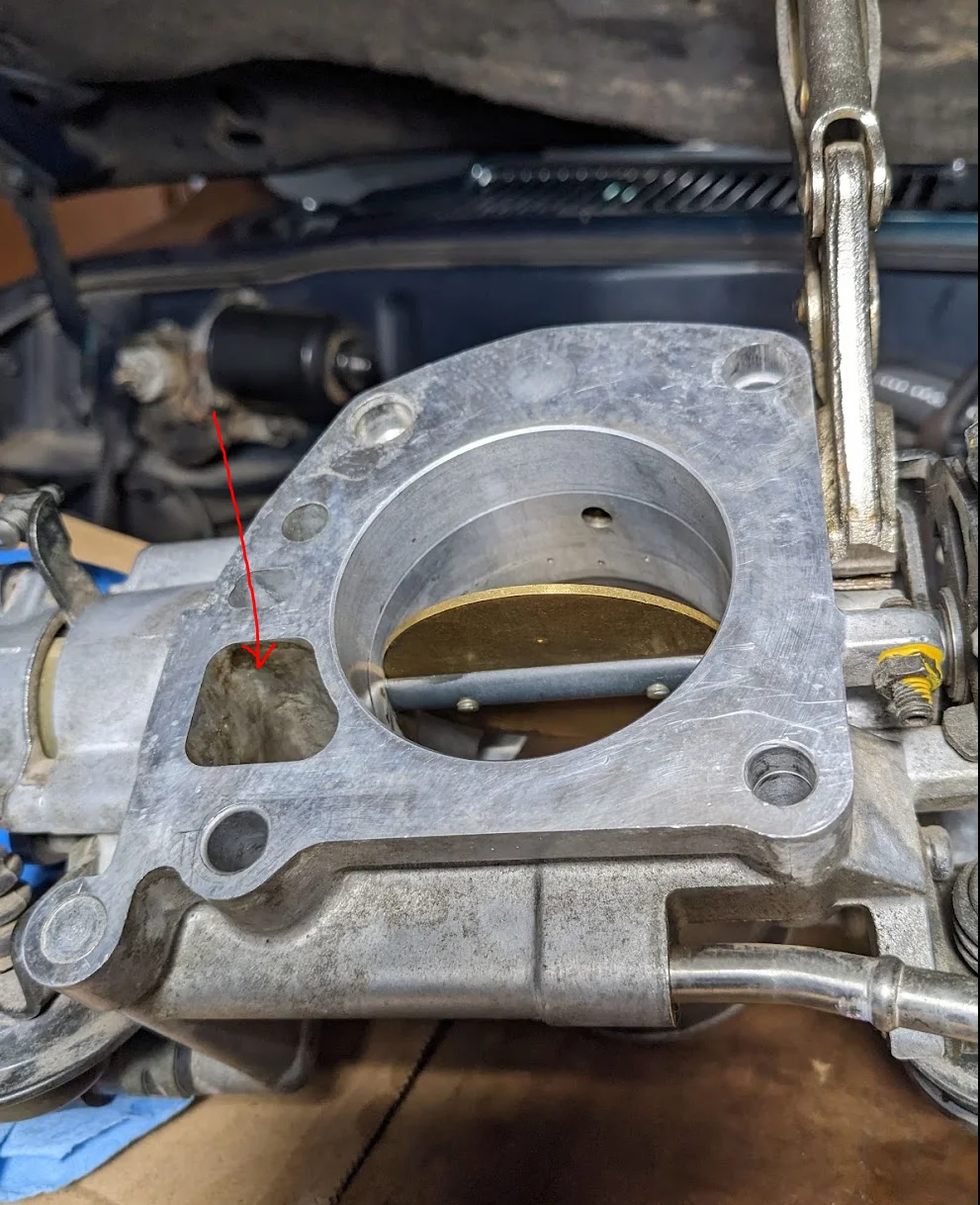

I had a really low idle and was expecting to find a clogged bypass - but it wasn't.
I ended up pulling the IAC valve and running the FSM checks to confirm it was working. I "stepped" it all the way in and all the way out a few times to confirm.
After that I cleaned the passage for the IAC and the throttle body to make sure the throttle would close fully. I found that the throttle plate was not closing fully because one of the cables was too tight and the throttle body was dirty.
Finally I adjusted the TPS using a multimeter per the FSM. Once that was dialed in my idle went back to spec and it does the high idle at startup.
Here's a photo of the bypass for reference. I ended up cleaning up the throttle body and passages with isopropyl alcohol and an old toothbrush.
Ah, that makes sense. I was thinking it might've been a different passage for some reason. Thank you!
