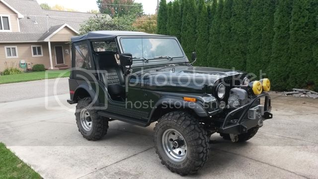

Oh, and Josh is narrowing down his color choices.
Jungle love monstaliner with Black Star Wars symbol on hood. I believe this is the general look less the J$$P.
Like green. Just not a fan of bedliner as exterior finish.
Natural Green Pearl. Depending on the light angle it can be green or almost black.
Personally, if he can be persuader away from the greens, I think his ride would look good in one of the many military desert tan finishes.
See if he can use photoshop to lay his design on this image.
