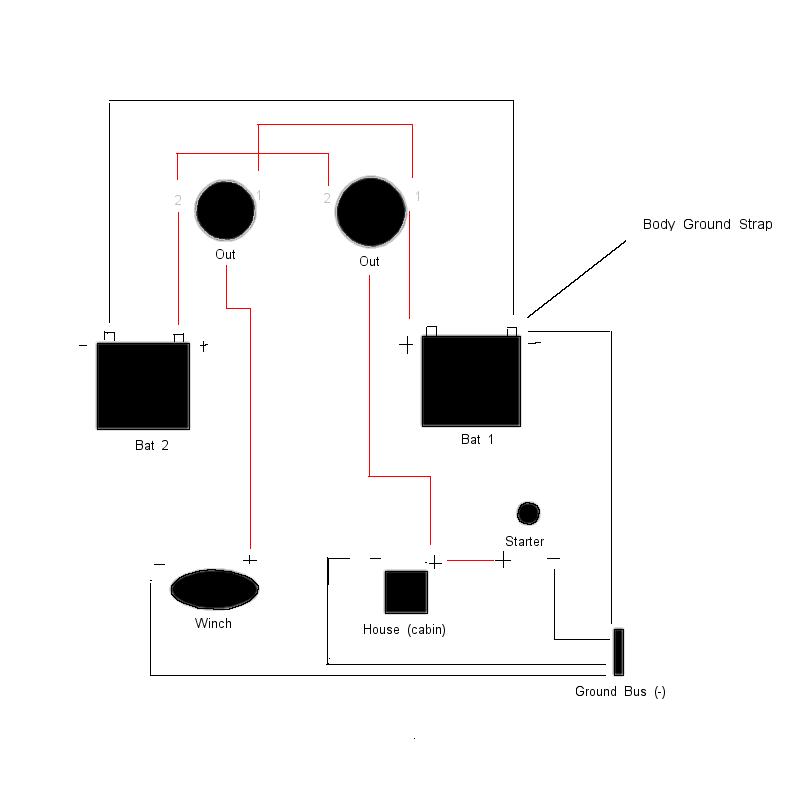

Can we get a schematic? There's a lot going on there.
Thanks,
T.
I can't draw very well... ANSI art
OK, I don't know if this will work/show up right, but what the heck. The whole thing started with a sketch on the back of a napkin and I've never built a formal schematic for it. Its pretty basic though. For the off chance of making it legible, I'll keep this as simple as possible.
Here's the basic idea.
Can't you put the two batts on parallel? I thought that you could! if not, why?
Yes, you can parallel 2 batteries. That is what the above diagram illustrates.
-B-
-B-
Ah!! now I understand the diagram!! thanks!
Yes. The marine switches (scroll back to the picture) have 4 settings. Up is off, turn it to the left and it is battery 1 which is the DS battery. Right is battery 2 which is the PS battery. Yeah, the left/right feels backwards when looking in the hood. Turn left to get the right battery, etc... I wired it considering 1 as primary and I wanted to keep the logical primary one in the stock location.
There is a 4th position on the switches that doesn't come into the phot because of my very tight install. Straight down is 'both' and puts the system into parallel.
If either switch is set to parallel and the other switch is not off, then the whole system is in effect in a parallel mode.
