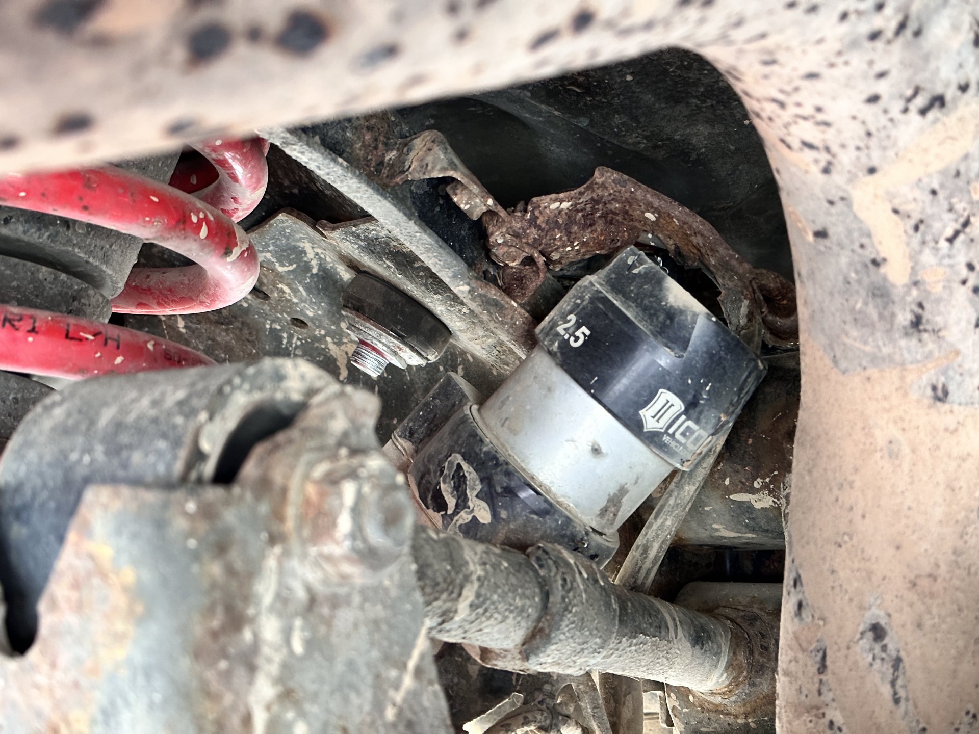

It’s been an on going issue of the threaded stud pulling out of the top of the shock. That’s the third time now for the driver side. The passenger side pulled out this summer 🙈

Shocks are too short!

Makes perfect sense 🤷‍♂️. Icon has only been repairing the failed shocks but they just said they were sending a new set with all of my issues. I know of one other 200 that bought an Icon suspension from the same vender and holiday sale as myself. Both of his rears failed on him. Hoping it was just a bad batch and the replacements work out.

Shocks were never meant to be limit straps, you need to figure something else out.

I feel like most the guys running icon on 200s don't do more than gravel road so they don't have any issues. Our driver side does droop more than passenger, time to give up on icon for something reliable man

What about a limiting strap? Especially if it’s just the one side that is problematic
200s don't flex that much to warrant limit straps. I've yet to have anything like that happen when ome. We have sway bars that limit travel already. Only people to post issues are icon owners
