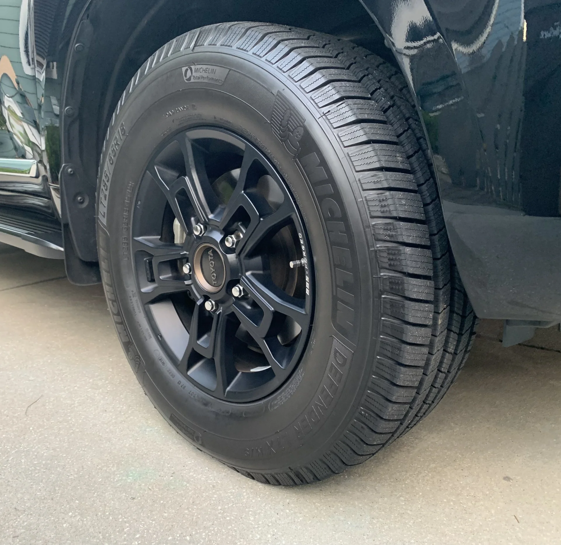

I have the Michelins you speak of in stock size.
They are excellent in snow and the ride comfort is superb.

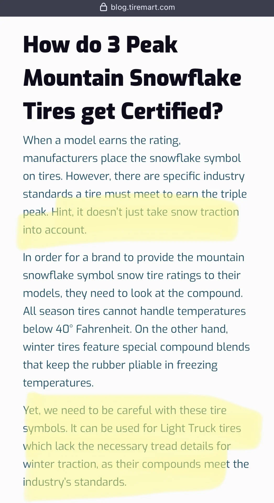

You two are correct that the defender Ltx does not have the 3pmsf snowflake. But, from my research this symbol is kind of crock. It doesn’t seem to mean much. Furthermore, most reviews (maybe all I’ve seen except your Oregon) is that the defender excels in snow and is better than all ATs in snow (except for maybe super deep/ skid plate deep snow)
I’ve been researching and everything I’ve found says the defender beats all ATs in road, wet road, snow, sand.

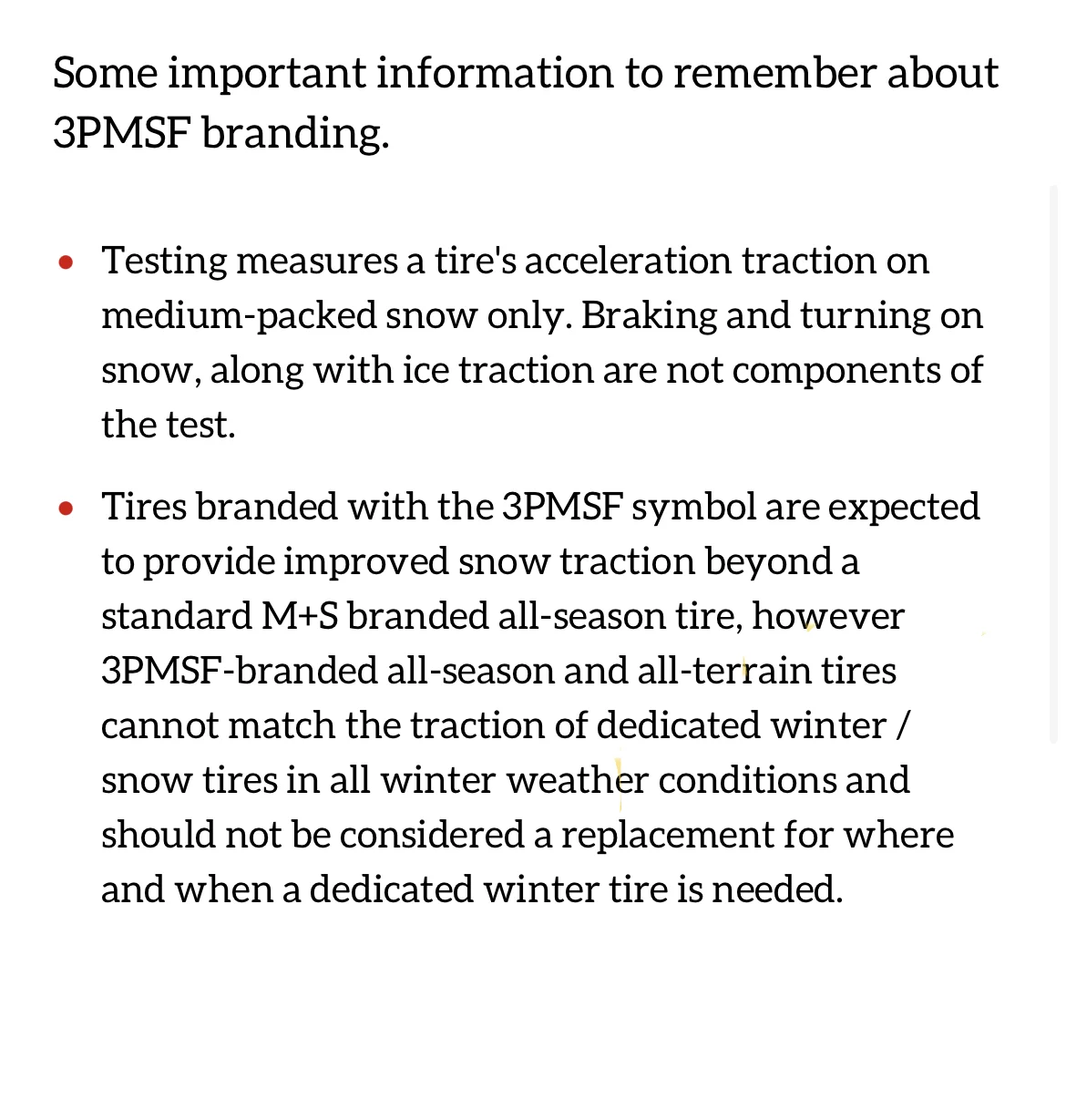

The way I’m to understand it is the 3PMS is sort of a next step for all seasons and not a grade for dedicated winter tires, for example my Hakka 7’s do not have the 3 Peak on them.
From tire rack.
