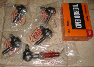

HI guys, needed a new drag link end and kept running into these OEM "kits" with all the ends for the front for a little bit more then just the one i needed. the part number i keep seeing on the box in the pics is 45045-60H00x. I thought it was strange that toyota would make a "kit" and called the dealership with that part number and they said they didn't have it in the computer. anyone know what the deal is with these? fake? legit?

That kit and the parts and everything about it are fake. Fugazi.
Toyota ends also include the rods. And they are all 4xxxx-60H0x.

Thanks for the insight. no ones mentioned of this fake number on mud anywhere. Parts guy at the dealership didn't know either. Toyota is making new parts for 40 series, people could be compiling their own sets of OEM parts... so lots of reasons to believe this is real, and lots of reasons my inquiry is legit and reasonable. maybe its generational, but can not wrap my mind around why people get so bent out of shape when they THINK someone hasn't searched the forum enough. lol, the search feature is not very good regardless of how thorough a search you do anyway. don't like the topic, don't like the question. dont respond? what am I missing?

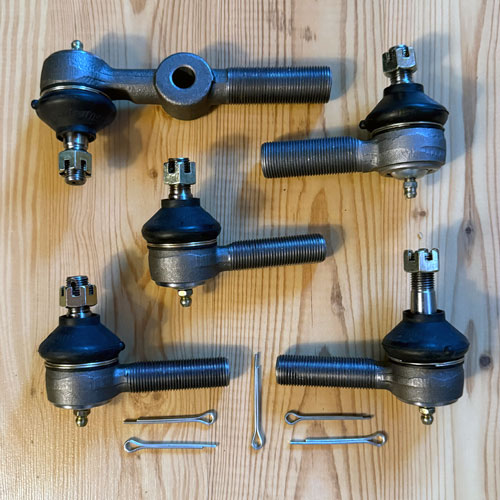

But 555 does offer a kit of Japanese rod ends, as linked earlier and sold by many of the forum supporting vendors.

And to clarify things for your Toyota button pusher at a dealership, the only part numbers that are applicable to 4x series trucks globally still available from Toyota are the following (applicable through EOP):
LHD:
45047-60H00
45046-60H02
45045-60H00
45046-60H00
45046-60H03
RHD:
45047-60H00
45046-60H00
45046-60H01
45045-60H00
45046-60H03
These are "kits" per the Toyota part numbering system: You get an end, you get the rod associated with that end, you get a cotter pin, and you get a castle nut. These ends will all have grease zircs already fitted to the end. The boots will be pre-greased. You need one part number of each.
The end at the pitman arm is discontinued from Toyota for both the manual gear box as well as the PS version gear box, so you will need to source that elsewhere @cruiseroutfit has aftermarket 555 iterations sitting on his shelves.
Kits are numerically designated by Toyota and are not ad hoc or generic; anything with a 04xxx in the prefix position is a kit of some sort (think engine gasket kit: 04111-66036, for example); anything with a 69xxx in the suffix position is a kit of some sort (think cylinder head assembly: 11101-69107); anything with a 60XYYY in the suffix position (X being a letter and YY being a numerical designation) will be a kit of some sort, (think, the 40 series head light kits: 81110-60P70). These are just some examples of kit numerical systems from Toyota. There are many more.
Anything else is either aftermarket or a fugazi. That's about the long and the short of it.
