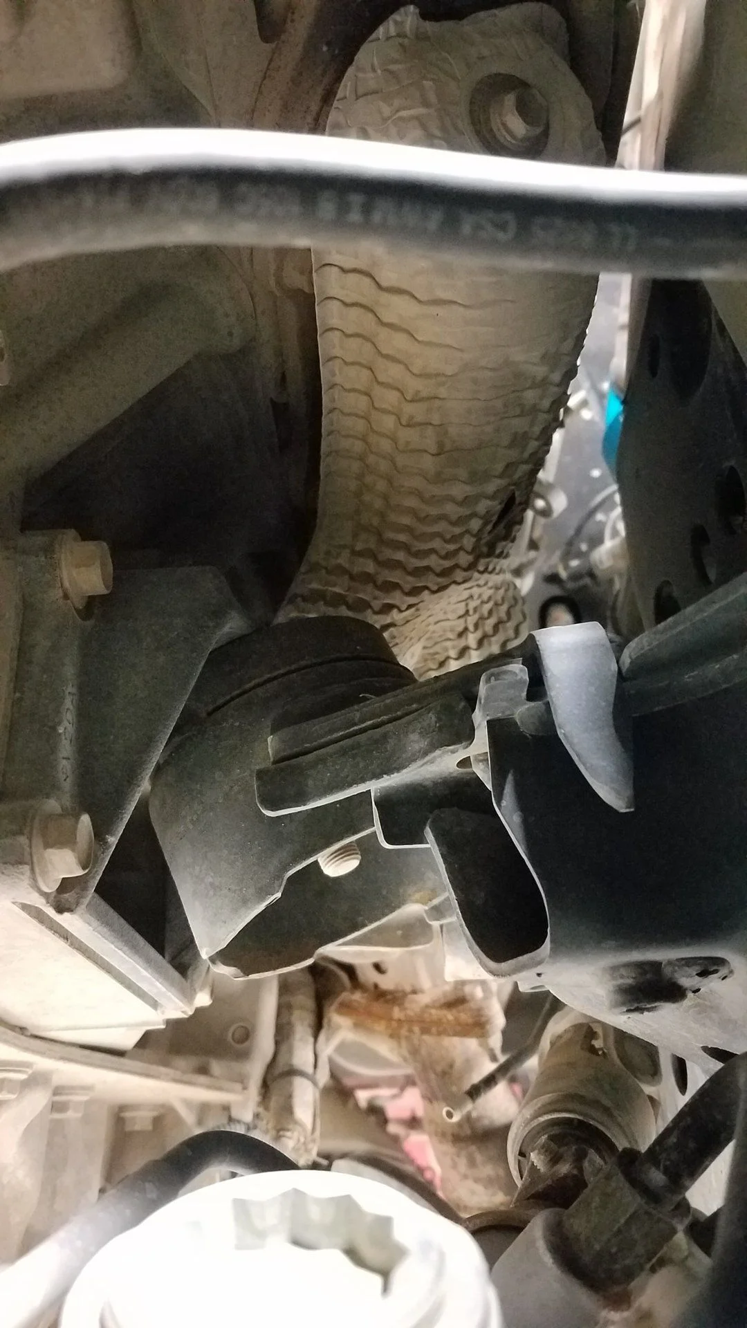

Confirmed, broken drivers side motor mount. I have no doubts the break is result of the way I drive :D
FSM calls for removing the motor (~18 hours :eek: ). On a dare I went through the wheel well, removed a bunch of stuff, raised the motor, lowered the front diff and was able to sneak it out. I'll post a pic of the failed mount tomorrow.
Failed mount...
Think its it's bad? :D

Gotcha. The 200 ones don't get that much heat, there is a manifold heat shield and even after running for a bit you can touch the mount. Given it's always the drivers side (lift side) that fails, I think it's most attributed to the torque. The passenger side (compression) fails less in my admittedly limited experience with them failing. Both are identical proximity to block/manifold. It will be interesting to see if/how they fail in the future as more and more get higher miles and more severe use.
