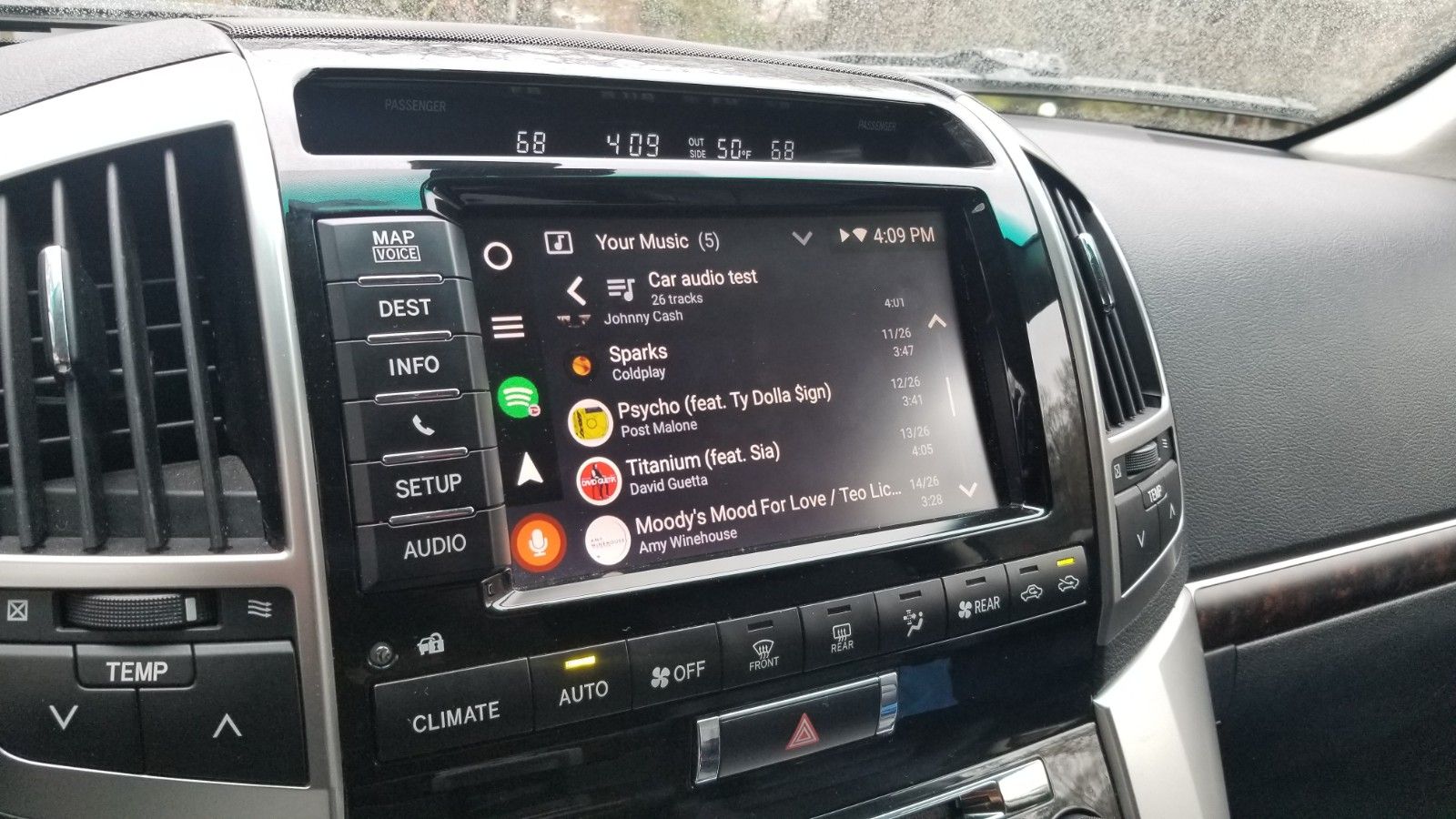

Re the GROM, it is amazing. Works perfect in my 2014. I know there are other threads on the forum going into detail about this.. but just want to highly recommend for anyone with 200 series (pre 2016).

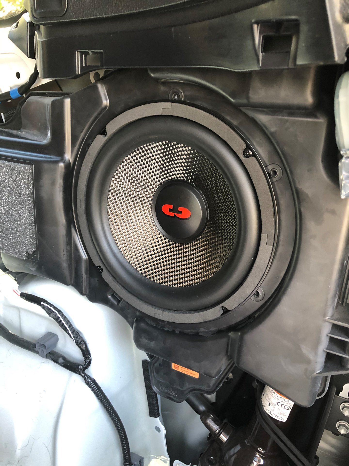

Got the CDT 8" subwoofer. Thanks to @Murckman for sharing info. Installed yesterday. I have to say this was very easy to do. And this sub makes a big difference, even being fed from stock amp. Definitely better sounding than stock. Very impressed.

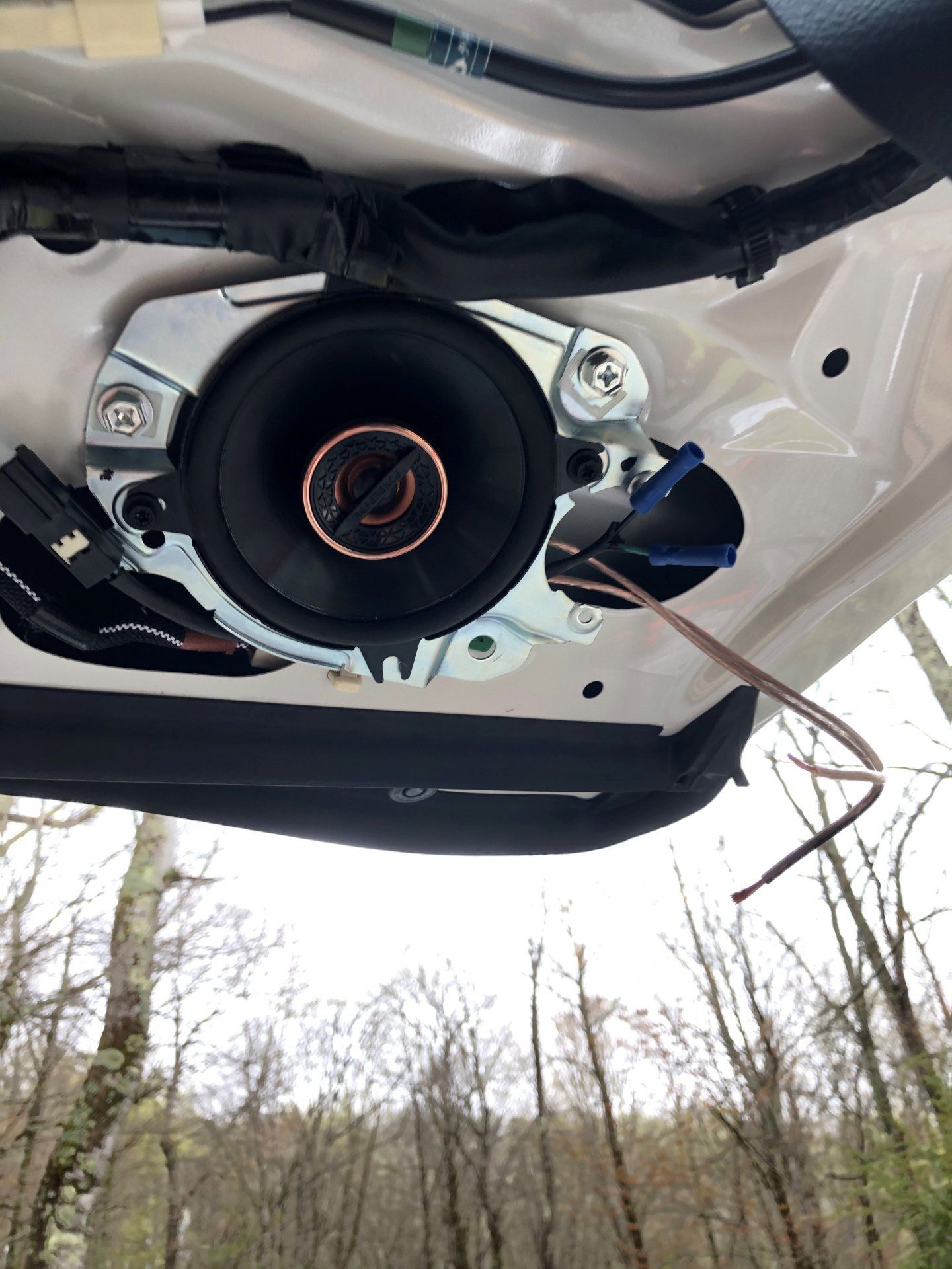

Also upgraded the rear hatch speakers to Infinity Reference 4032CFX. Sounds so much cleaner and clearer than stock, especially at higher volume. I think I will also change out the front corner dash speakers to these.

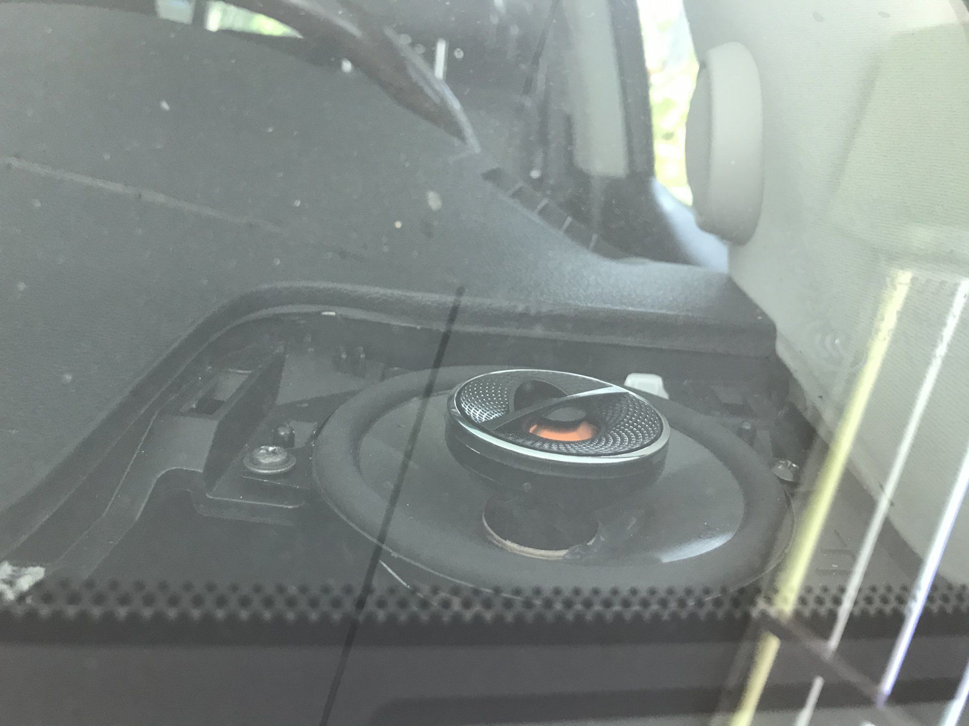

The side dash speakers are a little tricky, probably the most difficult of all the speakers. You will need to trim part of the plastic opening to get the new speakers to fit, and you will need to tap a new hole for one of the screws. If you have a small right angle Phillips that will help with the install. I went with the JBL GX series 2.3 ohm. It made a huge difference.
The side dash speakers are a little tricky, probably the most difficult of all the speakers. You will need to trim part of the plastic opening to get the new speakers to fit, and you will need to tap a new hole for one of the screws. If you have a small right angle Phillips that will help with the install. I went with the JBL GX series 2.3 ohm. It made a huge difference.View attachment 2294251View attachment 2294252
When you say trim, did you have enough room to use a Dremel like tool or trim by hand?
Also, do the factory grilles pop back in place or do the speakers stick up too far?
It’s only a couple of millimeters that need to be removed. I used really sharp snips and also a dremel. It was actually easier to use the snips in there as long as you have ones that are sharp. Just see where it has the restriction and cut just a little at a time. The bottom magnet will basically touch the AC ducting but it has a little play and that won’t be an issue. The cover will go back on as long as you get the speaker screwed down tight in both locations.
Also wanted to mention that you will need to take two of the four screw tabs off when you try to fit the speaker in on the dash sides. The ones that would face the front and rear need to be removed or it won’t fit, and the ones facing right and left will get screwed into place. If you take some pliers and bend the tabs back and forth they will break off pretty cleanly. Just make sure you break the entire tab off or it won’t fit in the opening.

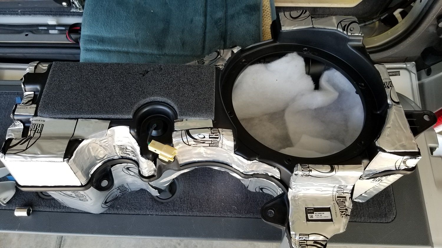

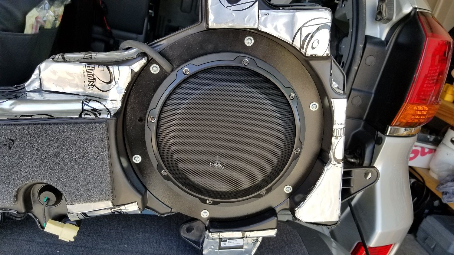

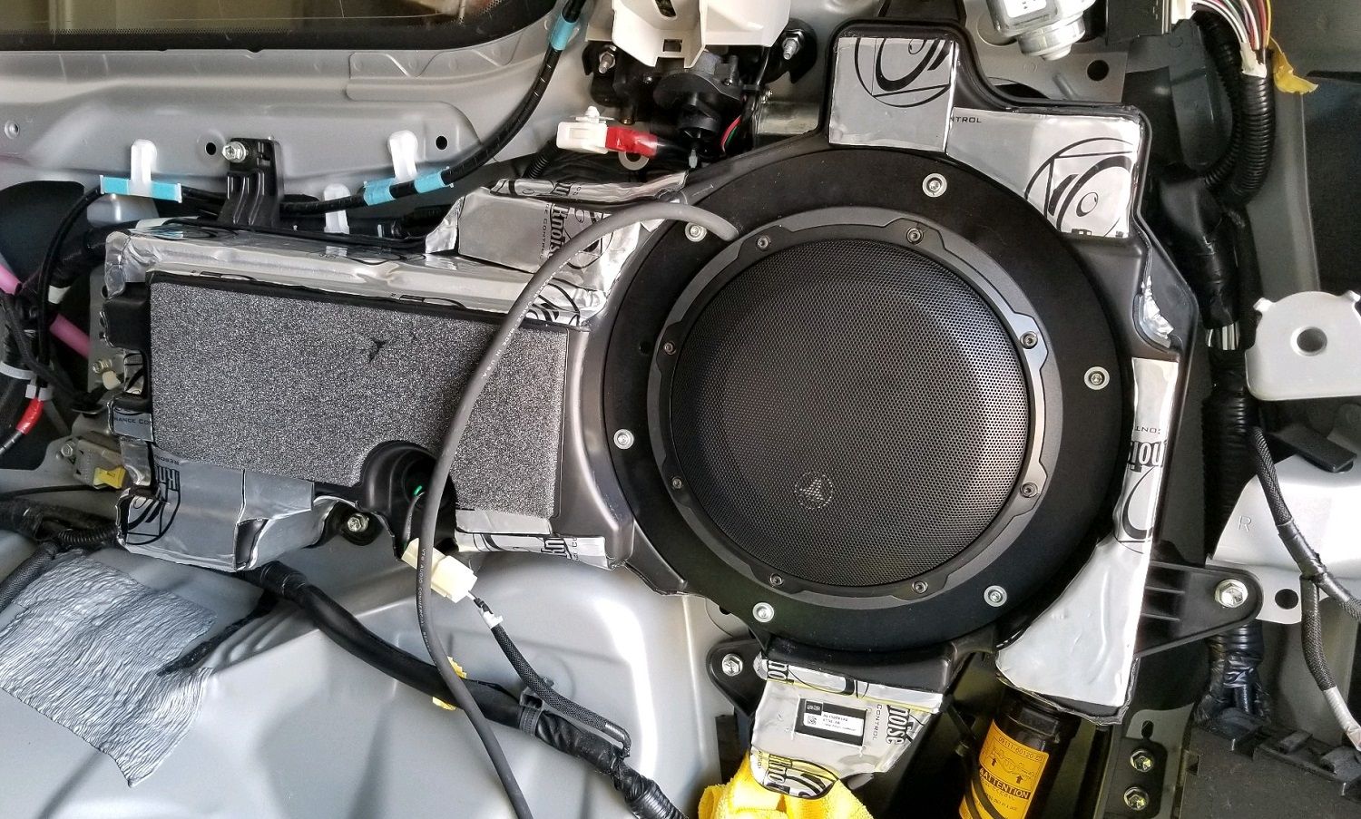

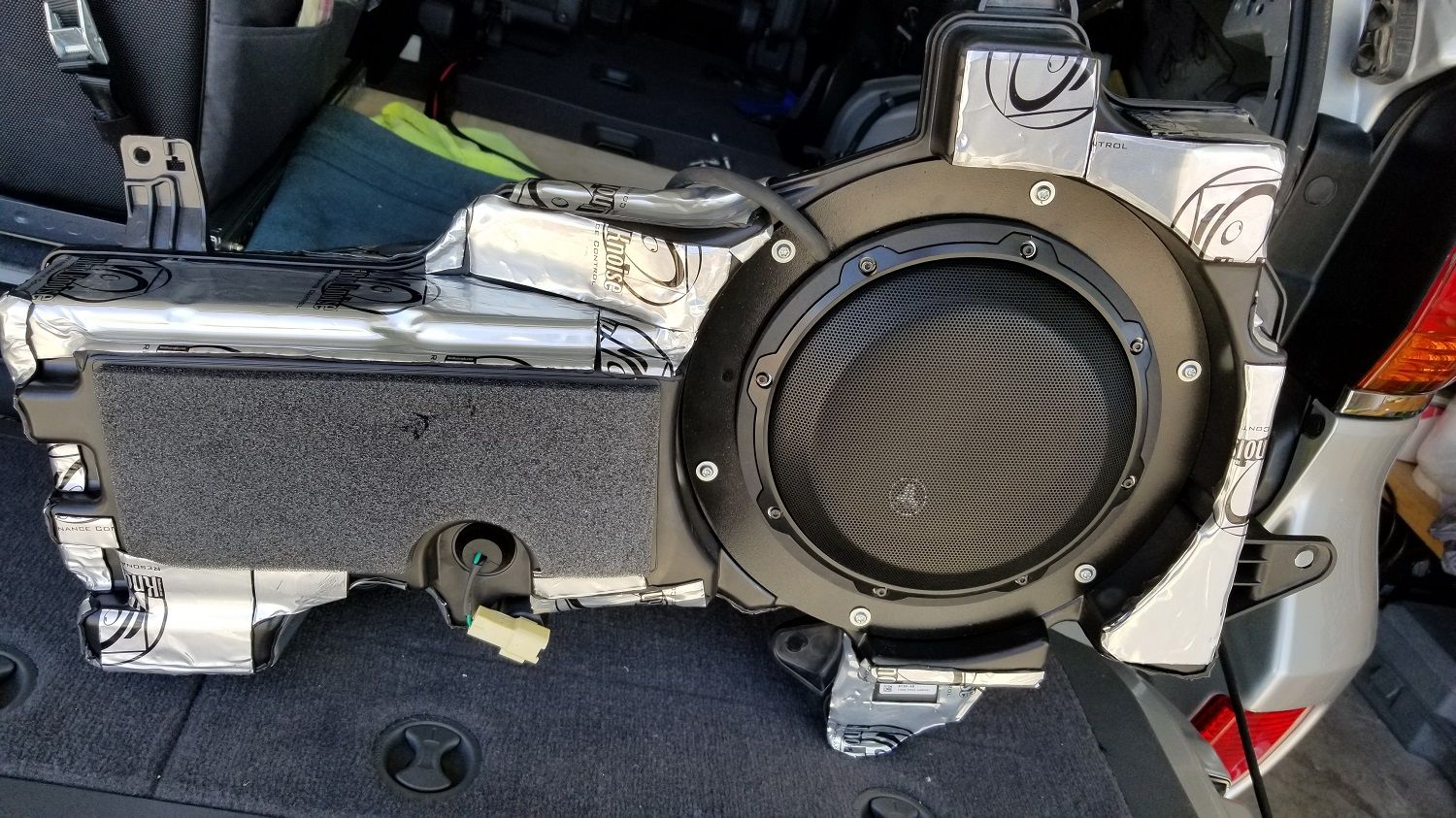

I decided it was time to redo the sub and mount it correctly so the panel would snap in place. I tried to make a new adapter from 13/16s MDF but the sub is just a bit too big. I routed it to counter sink the plate and then routed the other side to counter sink the sub. As I came around on the last cut you can see where I went through the remaining material. Just not enough to work with.
I thought about buying a new sub but couldn't find anything I liked that would fit for under $200 so decided to keep working with the JL I had.
I found a guy on ebay to make a plate out of steel for me. Drilled out a few holes and mounted it up. Used some weather stripping from Home Depot to make it air tight.
Had some scrap CLD left over from another project so added that to the box to try to reduce the flex and vibration. This was more than enough to make it a pretty solid box.
Got her wired up and everything put back together. Replaced a few broken clips and now no more rattling panel.

I need to go back in and update my mounting ring to, but I've got to space out instead of in as I used a 10" sub and it won't clear the top shoulder without the additional depth. I have the 8 gauge for the sub amp to the left hand rear quarter, just need to pull the seats and rear quarters and run it across. I had to trim the rear quarter cover as it was threatening to dent into the sub face . . .
Sweet! I want one!
Yeah, you need to make sure it isn't hitting the panel. I have a grill cover on my Alpine sub and one day I noticed bits of rubber at the bottom of it. Turns out the sub was hitting the guard and chipping away at the surround. Never thought the sub would travel out that far.
The panel definitely has a 'spacer' in a crescent shape that I cut flush. It interacts with the spacer that is mounted on our factory sub. No rubbing I can hear, but when I pull it apart it'll be interesting to see if there's some interaction. Thinking I might order some matting too . . .
