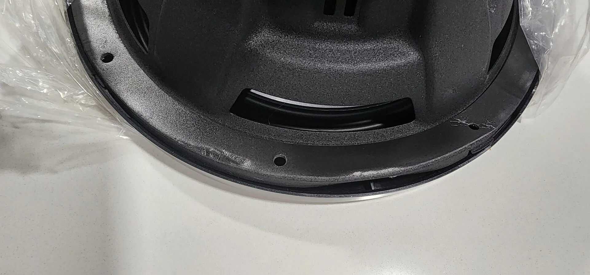

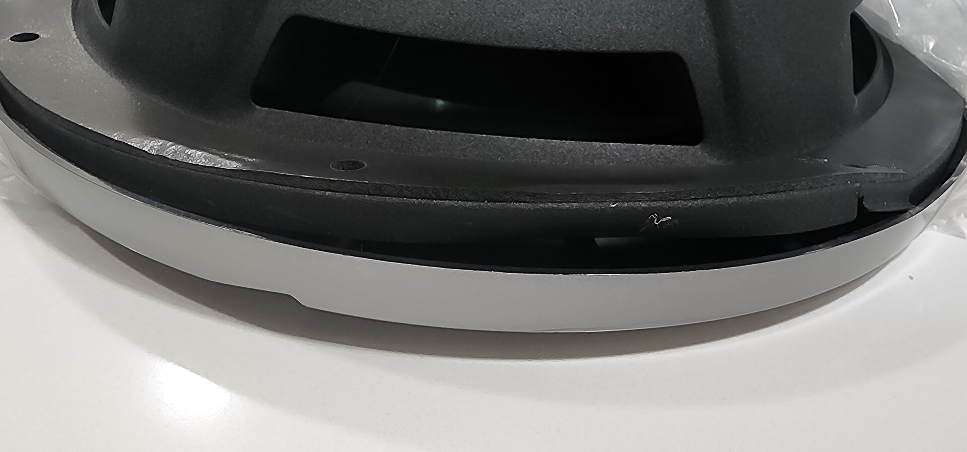

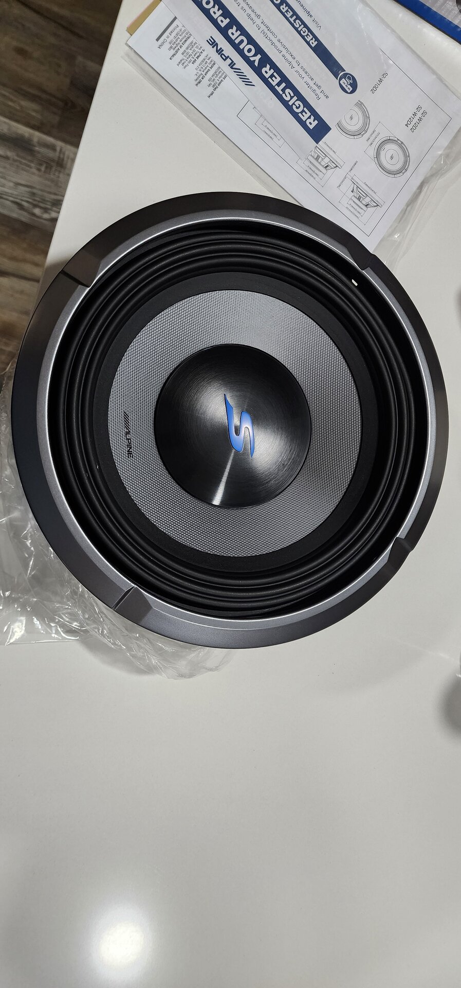

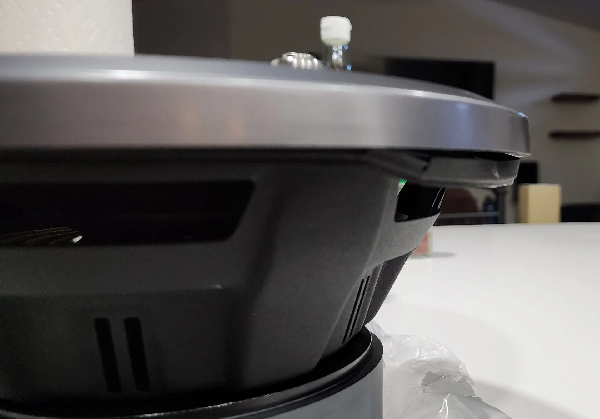

After 3 years of debating I finally decided on a sub to replace the 8" JL in the back. I have had several in my cart at Sonic for a couple of years, but stumbled on a new one. The 10" Alpine Type S S2-W10D4. I ran the older versions and hated them as they couldn't take the power. The new version is rated at 300w per coil, 600 combined and 1800 peak. Depth is under 5" so should fit fine. Price was $250 on sale for $160 and I had a $44 credit from when I bought my DSP a few years ago so delivered price was $116.
Pulled it out of the box and it is a solid piece of sound equipment. Weight isn't that far off from an older Type R sub I have.
Unfortunately as I looked it over I found some damage. The box was sliced open on 2 edges of one end and the woofer mounting surface has a huge bend in it. The trim ring is cracked and I can't even remove it. The shipping box looked OK so believe it was dropped before being shipped but may have been during shipping as well.
It was the last dual 4ohm they had in stock. They do have a couple more dual 2 ohm and my amp puts out 600 watts at 2 or 4 ohm so may just swap for one of those.
Will post up again once I receive one in usable condition and get it installed.
