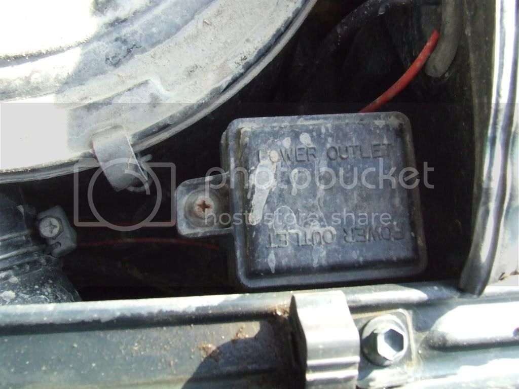

Factory fitted Aux. power outlet in engine bay

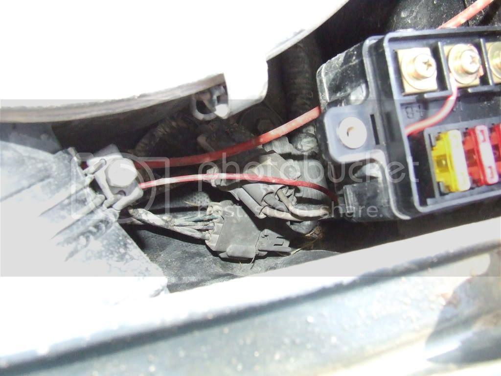

There's a plug union right there by the washer bottle, I wonder if this box would just plug in line?
Boyo, could you get better/closer pics of the plugs/wires running to and from that box?

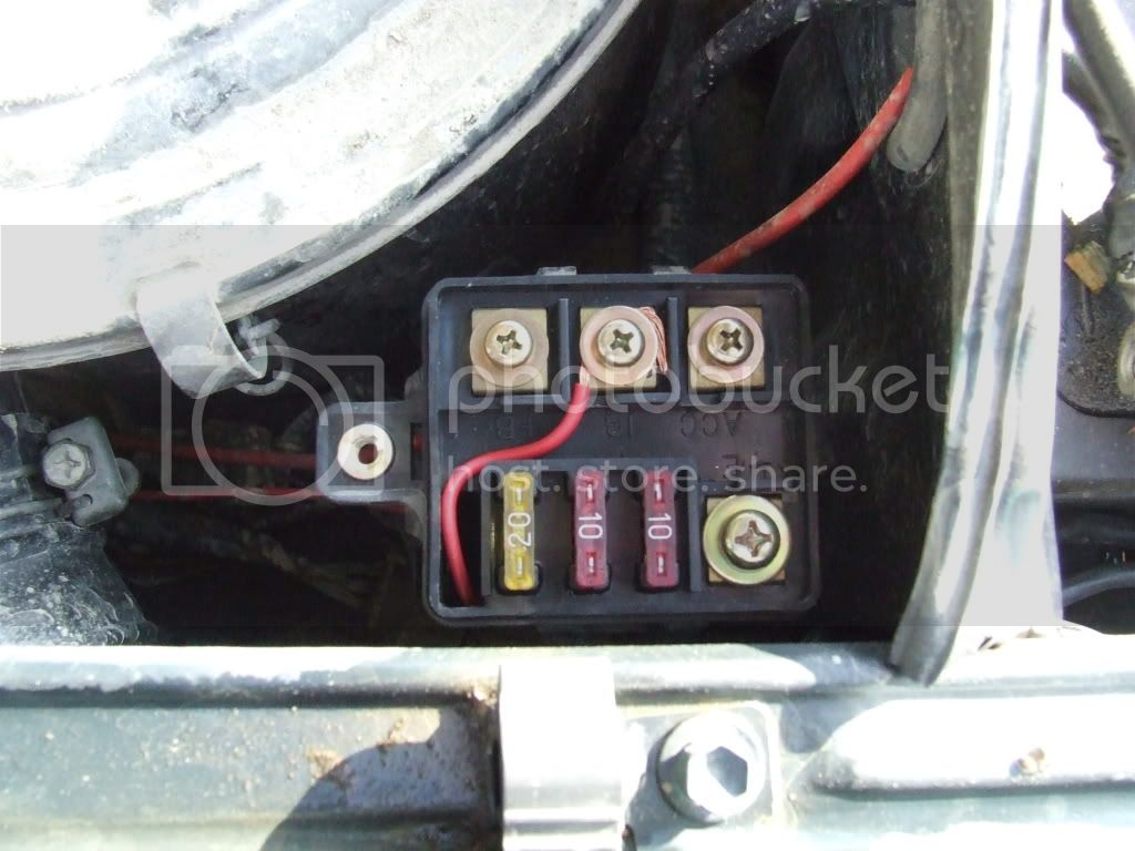

Pictures.
It looks like it just plugs into the loom.

I would think there would be 3 or more wires, one hot all the time, one hot on when the acc is on, the ground could be a tab to the mounting screw
Can you be more specific about the terminals on your aux box?
ACC= accessory hot only when the key is turned to acc or when the vehicle is running?
IG??? my guess is ignition but would that mean it is hot only while the engine is running? that does not make sense to me
+B Positive battery? always hot?
is the other a - E? it is hard to tell from the picture...is that the ground------oh I got it you guys call it "EARTH" and - so it would be "- Earth"

Hmmm - I think I need one of those.
Wow... that is one of the few spots left under my hood where I don't already have something mounted. I've been storing an extra quart of oil there.
Something like this... I wish we in NA at least had a plug for it. Having a ready source for ignition switched power would be nice.

Both my trucks have the Factory Auxilliary power boxes but I have seen a 94 80 here in NZ that did not have one so some get them and somw don't. I have also seen the outlet box aon at least 1 60 series truck as well.
Good to see that the pictures show that there is a way to get the wires into the box from underneath. I have actuall seen a couple where people cut a hole in the lid.
