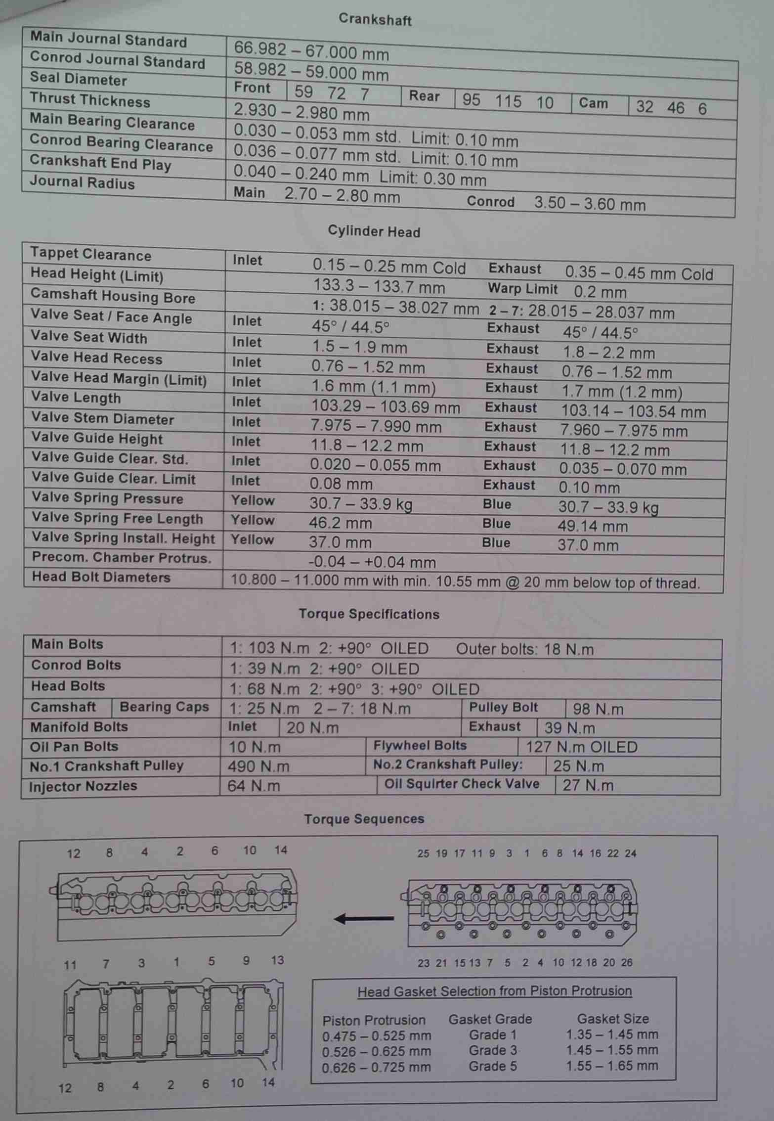

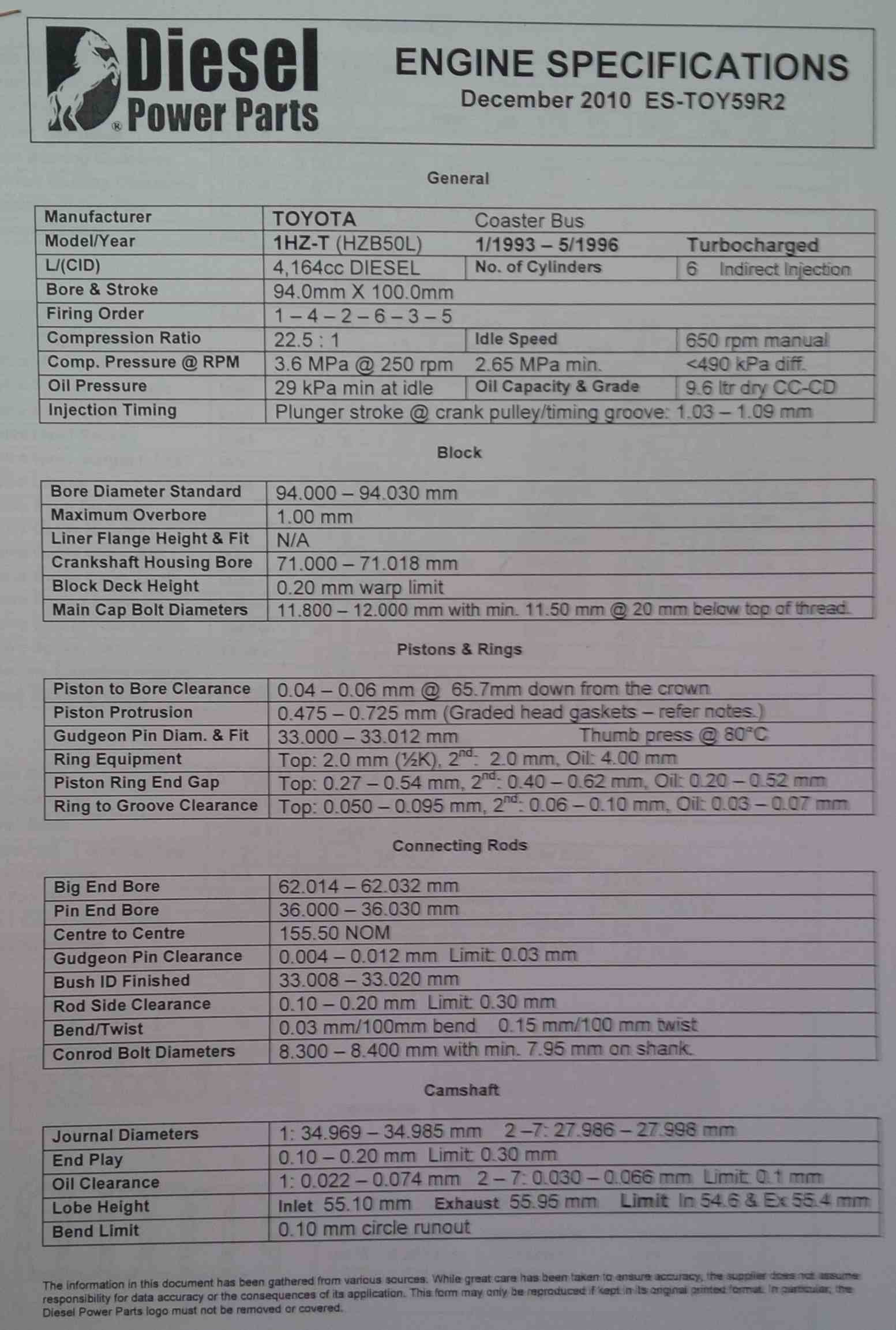

@damienperu thanks for finding a legit footprint of 1HZ-T unicorn

@BOOSTED80 pictures that i posted were for Caetano
I will post pictures of 1HZ-T parts as they come.

From what I understood the factory pistons are discontinued. Diesel Power Parts (through Engine Australia) make a both a pre and post 98 piston with al-fin insert (my post 98 pictured below), Hypatec (through Precision International) do one for the pre 98 only that i can't comment on, at least that's the way it stood according to those companies in July 2013.
