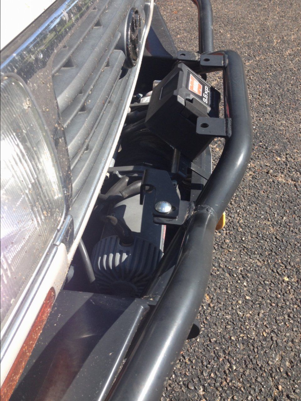

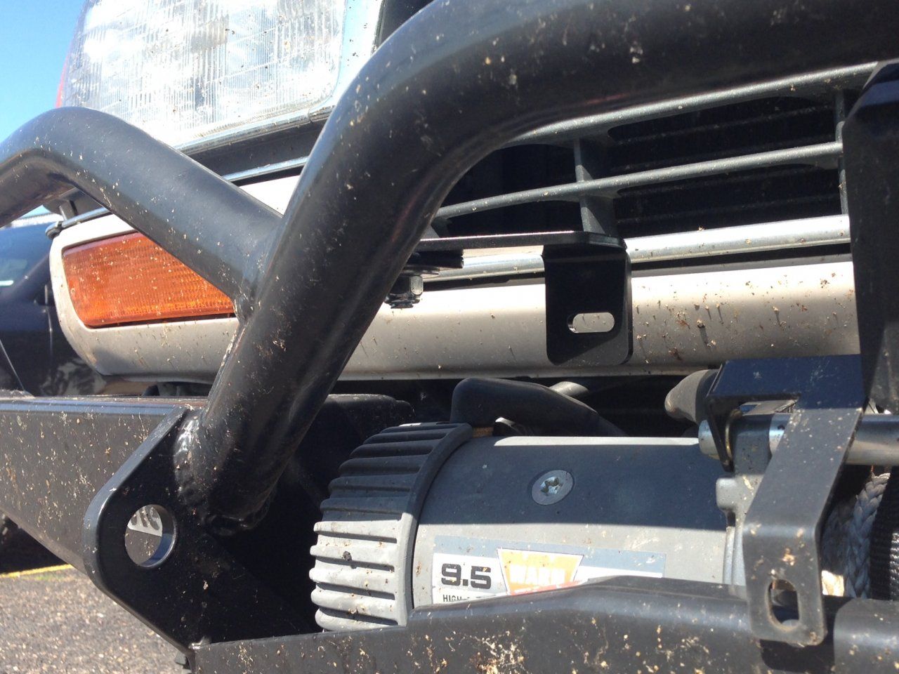

So I picked up a Slee Short Bus front bumper, Warn 9.5XP-s and a Ridged Industries 14" LED bar. I bought all this from Slee. On their website it shows these items being all used together. However, they are not plug and play, Slee didn't say anything about having to do some custom work either. I was hoping it was all plug and play but that is not the case.
First up, The Slee bumper is sweet, I always liked the looks of them. While not the strongest bumper I have seen it is fairly light weight which I like. It fits like a glove, very nice fitment on the frame rails. My only real complaint is that the recovery points are a bit light duty.
The Warn 9.5 fits great into the Slee bumper, however there is one major issue. To run the LED bar the winch control box has to be relocated. I searched on the internet and the only guy I could find with this combo is a dude who goes by "Treeroot" on forums. His truck is also the one pictured on Slee's site with this combo. He relocated the control box to behind the winch between it and the radiator, down low. I decided I didn't like that location so came up with my own method. I relocated the control box to my engine bay. To do this I had to make my own wire leads. So I went about soldering up some new #2 wire leads that are 5ft. long. I then made a mounting bracket to hold the control box, using stock mounting bolt locations in the engine bay. It worked out well but took some time and thought. I just bought the wireless upgrade/option from Warn as I plan to go that route with this winch. I honestly don't like the control box mounted on top of the winch anyways, it is just a preference thing as far as looks go.
Next, the Slee mounting brackets for the LED bar are no good, at least not for me. I screwed around with trying to use them for at least 2hrs and could not get them to work at all. So I gave up and just made my own mounting brackets, which all up took me about an hour to make.
Here is pictures......
The beginnings of my relocation bracket in the engine bay for the control box.
Control box relocated and mounted. Like I say, I am going wireless so this location will work out well for me.
Mounting tabs I made for the LED bar.
And the finished set up.....
All in all I am stoked on the new set up. I had thought about going in cab winch controls and almost bought the stuff to do that. But with the wireless option no need for that at all. Plus wireless means less wires to deal with and no switches mounted on the dash. I got pretty frustrated with the Slee mounting tabs for the LED bar. I am not sure if they sent me the wrong ones (look exactly like the ones on their website) or what but I could not figure out how to use them at all. They do not line up in any way shape or form that I could figure out. I could have saved a lot of time by simply making my own brackets from the start. I was also pretty disappointed Slee gave me no warning that I would have to relocated the control box to run this set up. That would not have changed my mind on this purchase but I would have been more prepared instead of having to run to the auto parts store 3x's on a Saturday. I will probably upgrade the hook on the end of my winch to something much better. I don't care to much for the Warn fairlead, it is kind of bulky but for now I will just run it.

Unfortunately the solenoid box and light can't exist in the same place. I agree we probably should do a better job on advising people if they buy this combination.
As for the light tabs, please see attached picture. The confusion might be that they are attached to the light tabs in the "valleys" and not the top light tabs. We will document this and include with future orders of the light tabs.
View attachment 928290 View attachment 928290 View attachment 928291 View attachment 928291
Hey Christo, thanks for that and the pics. I am done with my install though! :)
The confusion with the tabs was because I only tried a few times to use them with the RI tabs included with the light. So for the other 1.75hrs I was trying to use them stand alone without the RI mounts and also on the inner most tabs. Not possible and not going to happen. Obviously by your pictures the RI mounts are retained and bolt to your brackets. Not a big deal at all, as you can see I fabb'ed my own. However, you may want to put together a short instructions note that simply says something like, "Use these mounting tabs with the supplied RI tabs". Part of my confusion also came from looking at Treeroots pics and his appear to be mounted using the inner tabs and no RI tabs.
Like I said, no big deal on the relocating. It simply would have been nice to know ahead of time. And for anybody reading this who may be thinking of going with this combo, #2 wire is roughly $3/ft. So I have over $100 in the re-location of the control box, add that to the expense if going with this combo.
Cheers and thanks for the help though Christo!
