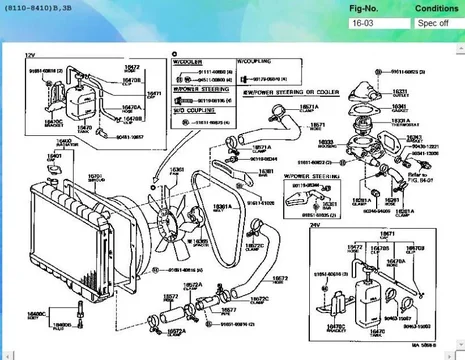

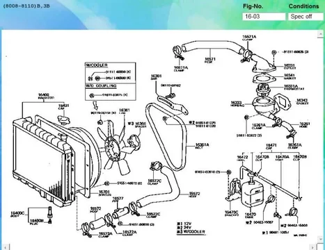

They are reversed, B has the lower on the drivers side, upper in the pass. F is opposite... Or is it the otherway?
I think you could get away with using a F in a B because you have so much room just get a pre shaped hose that would work. B on a F no way.
Im pretty sure the reason why the 'B' series radiators changed is due to the introduction of power steering.
It looks as though power steering wasnt available until 10/81. Up until then the upper radiator hose joined the radiator on the RH side. After 10/81 it changed with the upper hose swaping to the LH side of the radiator. The reason no doubt was due to the fact that the B series mounted its power steering pump/pulley to the front RH side of the cylinder head - which would have fouled the earlier radiator hose setup. The lower hose joined the radiator on the LH side through out.
