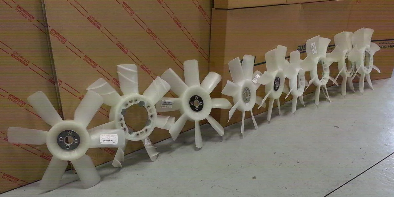

Is there a vendor selling a package to get the plastic fan adapted over to an F engine?
Are the parts common or is there a missing link to make this work?
I don’t want to run the metal fan, and it’s bent anyway.

Alex, I have a 65' 135 and the 16.25" without clutch is what I needed.
I offer the fan, the fan spacer and the bolts as a kit.
72 fj40 f engine.
I bought the spacer at specter off road, the bolts at ace hardware (same threads as oem but longer bolts) and the fan on Rockauto FNT017 Aisin. Works great. A little over $100 total.
Plus I used the original pulley so no monkeying with weird belt sizes, etc.
Devil is in the details...As I understand it, if your existing fan is a 4 blade metal fan, you need a spacer to do the conversion to a 6 blade plastic fan, as explained in this post.
However, if you have a 5 blade metal fan (as found on many non-US FJ40s), you can directly replace it with a 8 blade plastic fan like this one.

I've got the 4 blade and it isn't inspiring confidence. I've beat my plastic fan up on the 60 when the motor mount broke. It didn't kill any one.

That is the 8 blade fan

Is the plastic fan less of a drag on the engine? I know it is less dangerous to the radiator. What other advantages does the plastic fan have over the metal fan?
David, I do not have empirical numbers regarding the drag. I have always just assumed that the plastic fan has slightly more drag: blades are shorter, but there are more of them.
The angle of the plastic blade provides superior cooling.

Please forgive the intrusion into this thread; is there a fan that will fit onto a clutch AND fit inside the smaller F series fan shroud? I put a later water pump, fan clutch and fan on my F but the fan is too large for my fan shroud.
