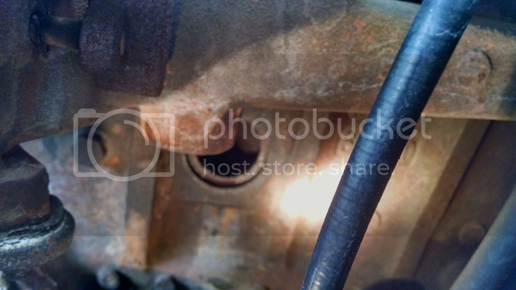

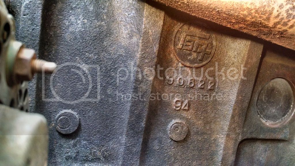

I finally have some time to work on my 1970 fj40. I am replacing the freeze plug closes to the fire wall.there are only two of them on the exhaust side of the engine.I bought a freeze plug kit and the biggest plugs are marked 50mm I am having a hard time trying to hit this thing in.I gave up and removed the steering box and column but that was as far as I got before having to leave to pickup my son from school.is there any tricks to installing these things?? Thanks

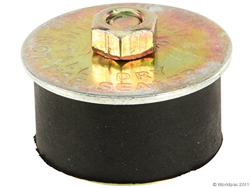

Here's my .02 worth. I too have a '70 FJ-40. Ditch the stock/OEM freeze plugs and go with aftermarket expansion plugs. They're available at your local auto parts store. They fit in the hole and you tighten the nut to get them to expand and fill the gap. I've been running them for years with no problems. In case of a hard freeze, they push out just as easily as the stock ones.

I think you just saved me a whole lot of work. I was contemplating pulling the fender off are the exhaust and intake manifold off.heather one I was looking forward to.I will check out the auto parts store tomorrow.
That is NOT the correct freeze plug. The correct OE is still available from the dealer. It does not have an outer lip.

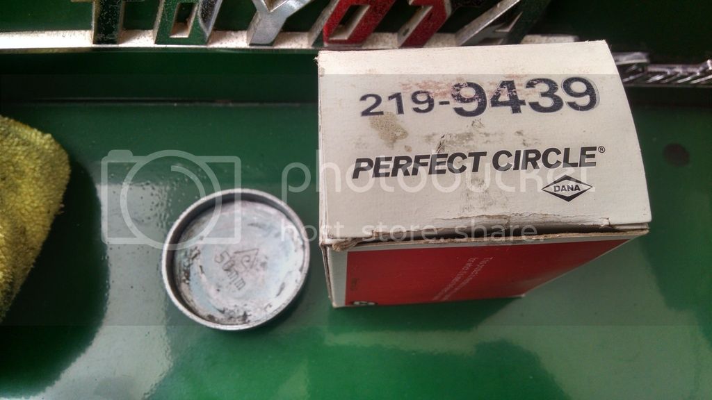

on my third trip to the auto parts store for the correct size It would be helpful to know what size you used. 47mm to 50mm doesn't cleat the inner lip on the block. so I'm headed back to get the 40mm to 47mm size.
