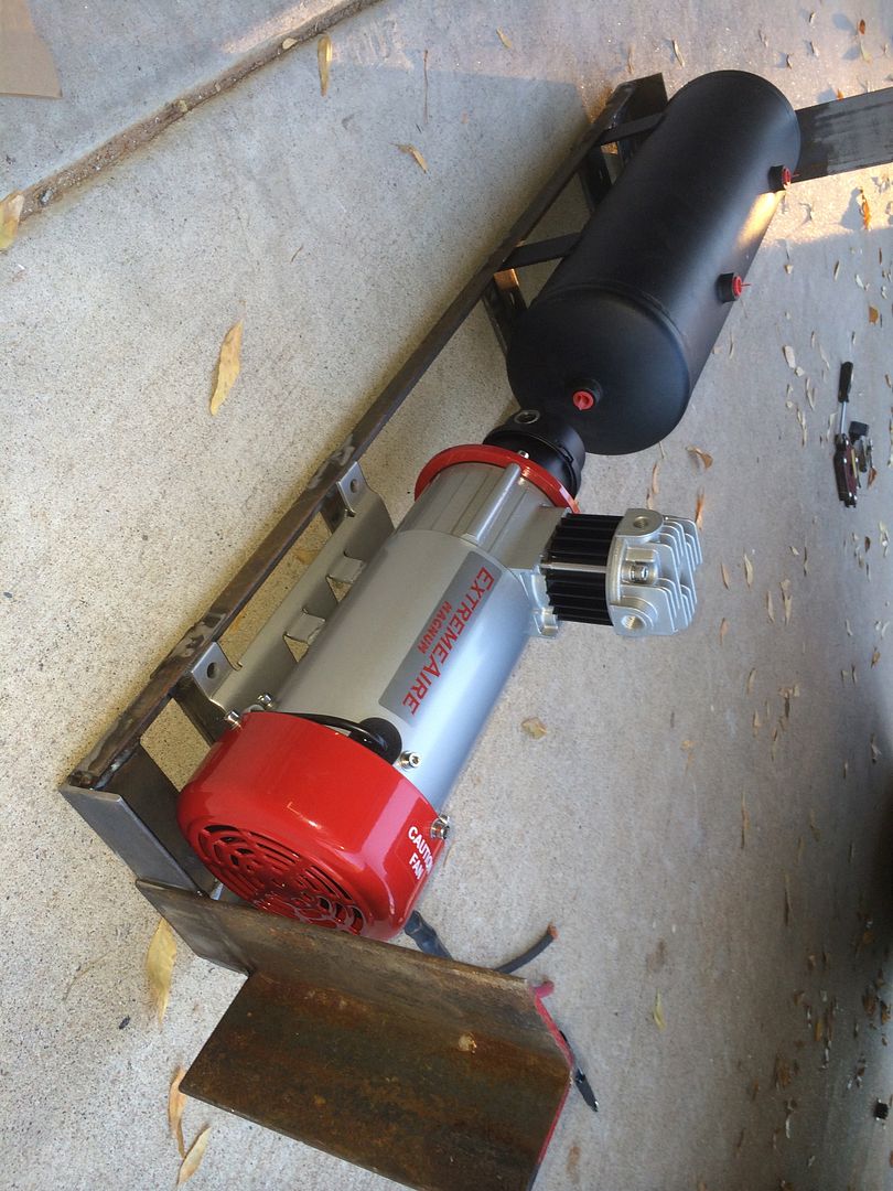

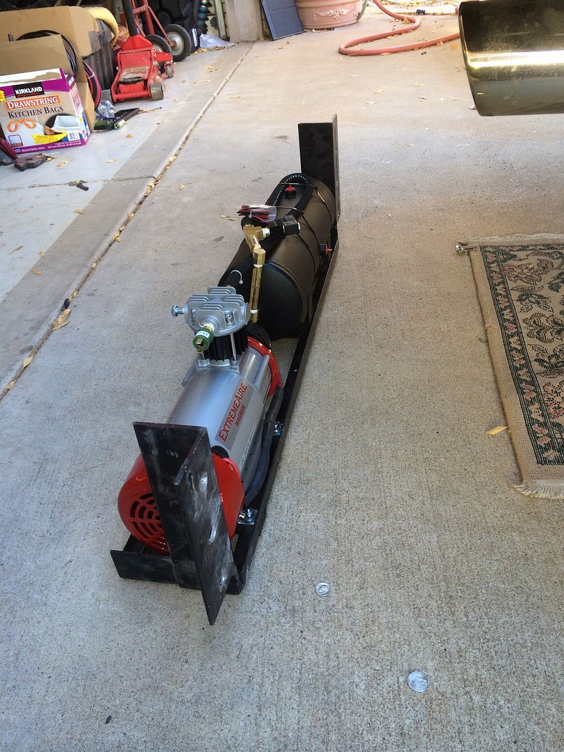

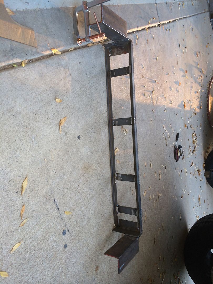

I made a plan on where I wanted it, so I needed to build a crossmember to make it work
Here's what I came up with

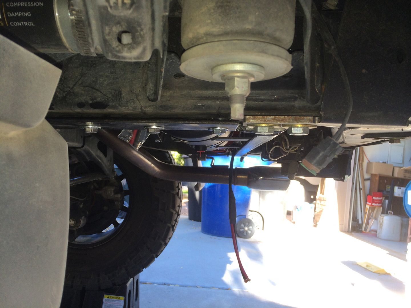

It fits perfectly between the frame rails attaching to 3 threaded holes on the frame each side. It doesn't hang below, the rails at all. I will make a skid plate to protect it and put heat shields under the exhaust pipe. I intentionally mounted the heavier compressor on the passenger side, to not make the FJ lean any worse.
Its now painted and will be install tomorrow. I will take more pictures of the electrical, air routing when it's done .

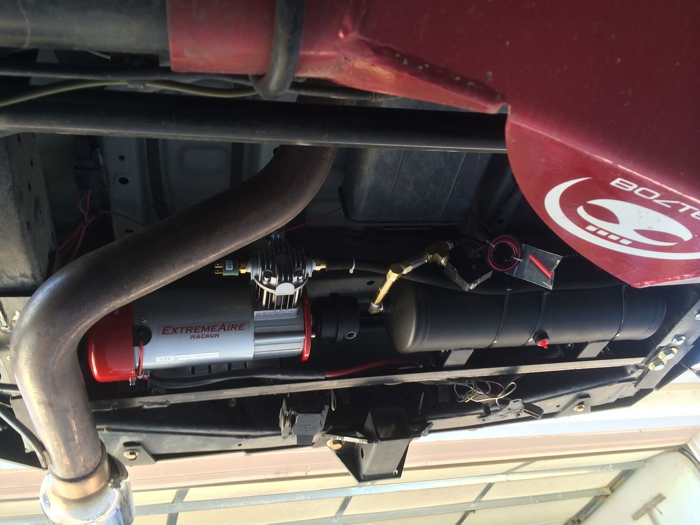

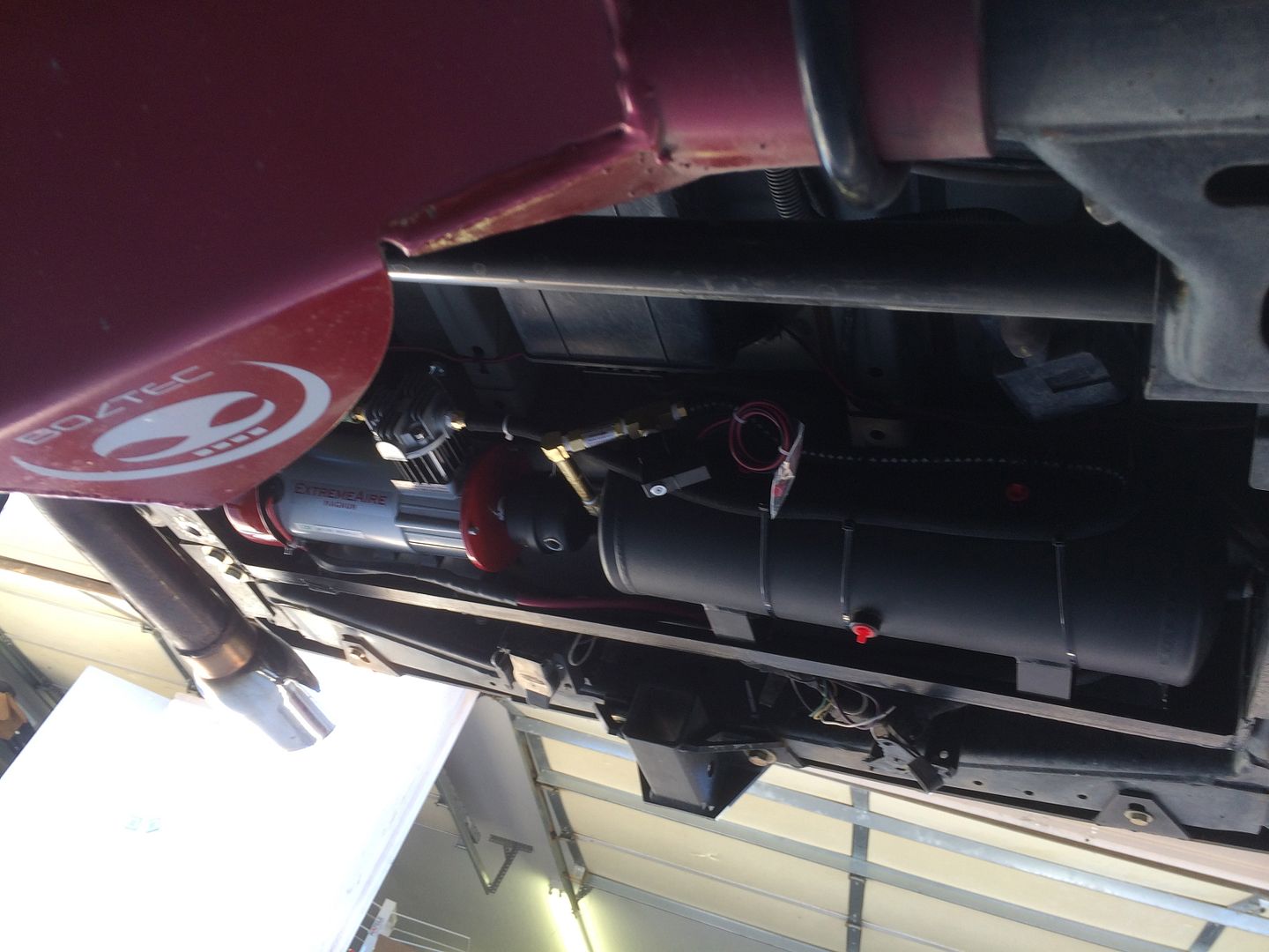

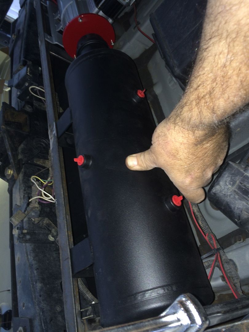

Part 2 is complete. After test fitting the bracket some adjustments had to be made. I actually wheeled with the bracket in place yesterday. The adjustment I made was making sure there was a separation between the compressor frame and the body above it. I thought I allowed enough in the original fabrication, but after pulling the bracket, today I saw rub marks on the body above the frame so now it is spaced more.
The compressor and tank were mounted , pressure switch plumbed in, blow of valve attached and everything from the compressor to the tank is now complete.
The hard stuff is done.
Next phase is plumbing the air fittings and running all the electrical. I hope to have it running this week and do some testing.
The entire unit together weighs 47# . I'm not sure what a CO2 set up weighs full, but if someone could give me the weight, that will be a good comparison.
Here are some pics mounted

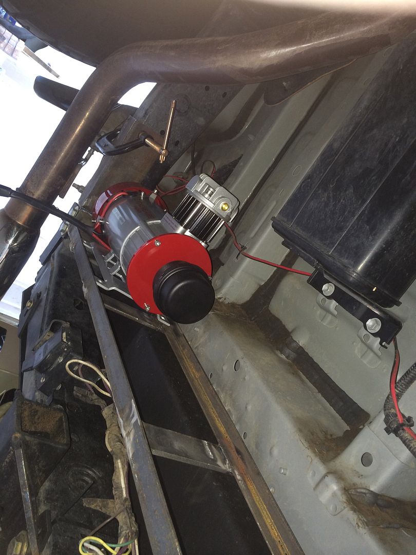

I would relocate the compressor air filter inside the cab.
Oh I mounted the entire thing in truck beside rear drawers just fired it up now. winch fittings leaking away I have to regulate the PSI down for the winches air brake I believe. starting to look at this entire thing and man theres so many more things that could wrong with the new set up more moving parts. SO Im making it bullet proof. or trying
