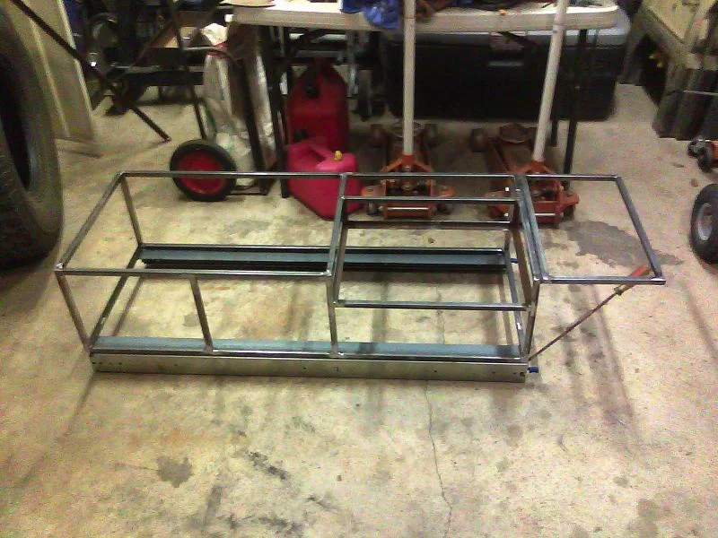

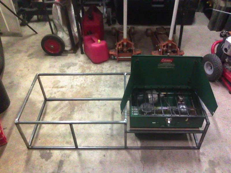

Skeleton for the kitchen Mostly welded together.

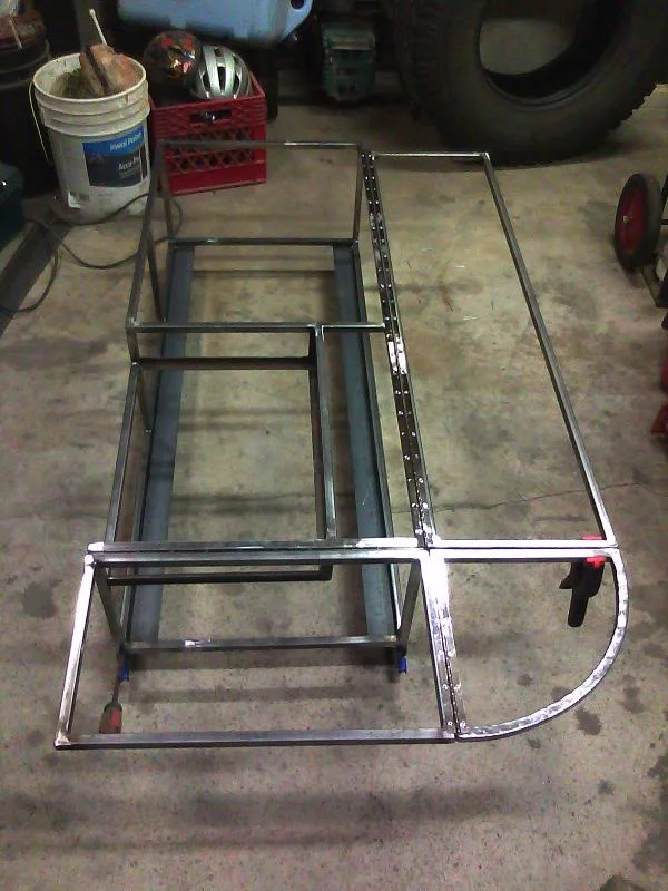

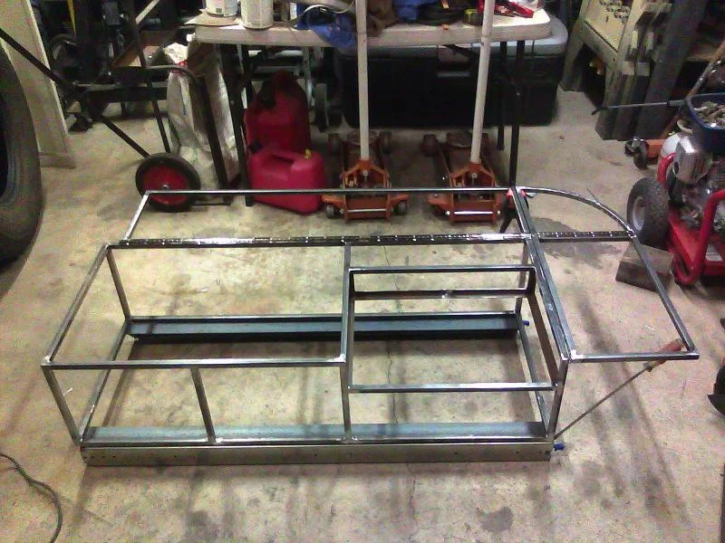

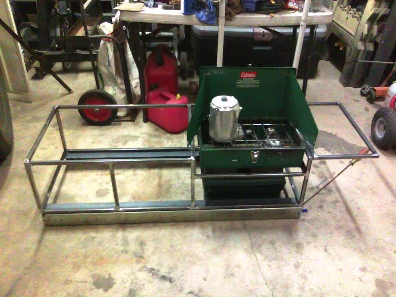

It doesnt seem like I accomplished a whole lot for an entire days worth of work, but since my tolerances are extremely tight there is absolutely no room for error. I've pretty much had to do everything three times .... Its been a challenge to get everything square and to exact measurements. So today, I mounted the slides, built the flip up counter top (to the right of the stove), put in the structure that the stove will sit on, and finished welding and grinding all my welds smooth.
Id like to put in the rear folding counter top. The design is for the counter to stow folded over resting on the sink, but without having the sink in my hands, I have no way of knowing how high the sink sits above the mounting surface. if its more than 1/8" then the piano hinge will pinch it and the counter top won't lay flush. I guess that part will be on hold for a couple more weeks till the sink shows up.

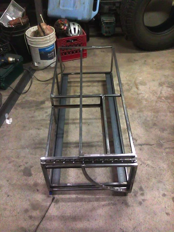

I got some measurements from my sister who is delivering the sink, and based on that information I went ahead and finished the counter top framework. The top two photos show it deployed, the bottom photo shows how it folds up for stowage. I am really pleased with how it turned out. I think that most kitchens of this nature are lacking in counter top/ food prep/ or just plain horizontal surface area. It was a fair amount of extra work to make this, but I doubt I will regret it. Note: the one side is slightly shorter in antisipation of the kitchen not pulling out 100% of the way and to clear the external door.

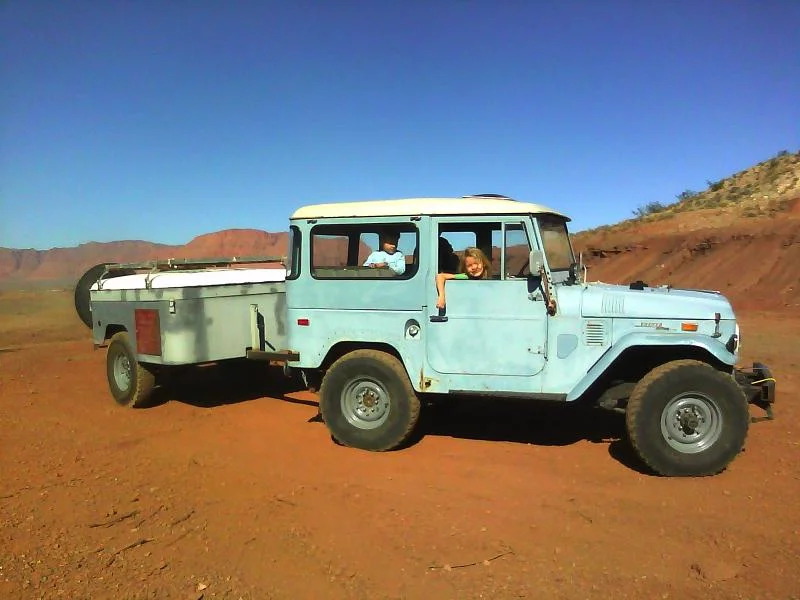

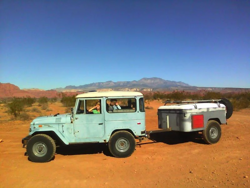

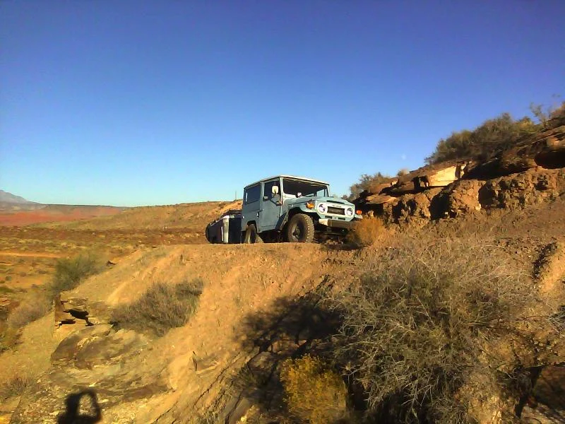

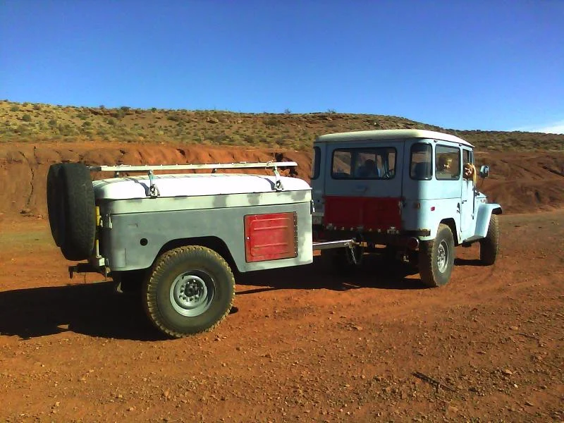

Just wanted to post up a couple of Thanksgiving day expo trailer pics behind the FJ40. took the kids out for a ride while the turkey was roasting. I must say, apart from the noise from the pintle hitch, this trailer really pulls nice. I only partially loaded w/ gear but I was quite pleased with how it tracked, handled the bumps, and ruts. + It looks awesome. :cool: Biased opinion, I know. Happy Thanksgiving.
That looks Awsome
Sent from outer space via my mind

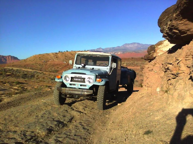

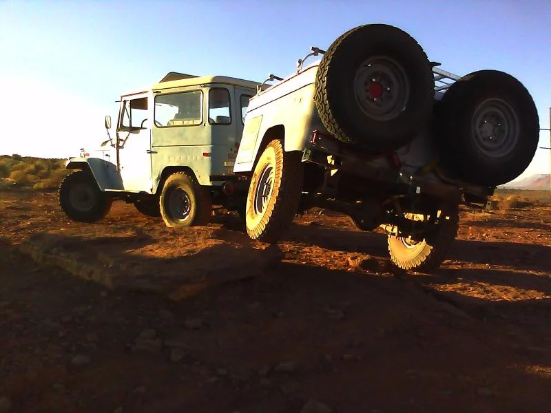

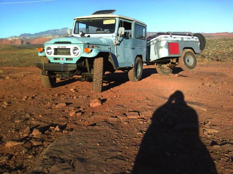

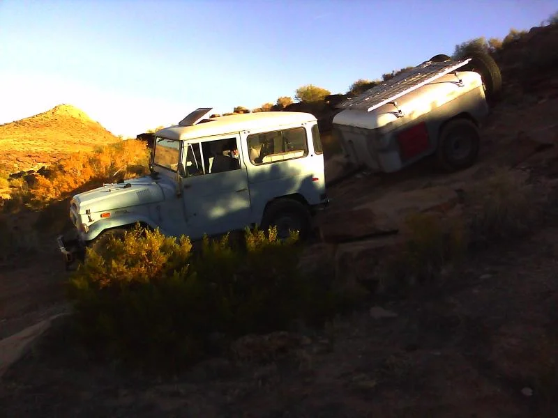

I got one more short trip in today and took a few more shots.
A few more.
Man the whole package looks sick
