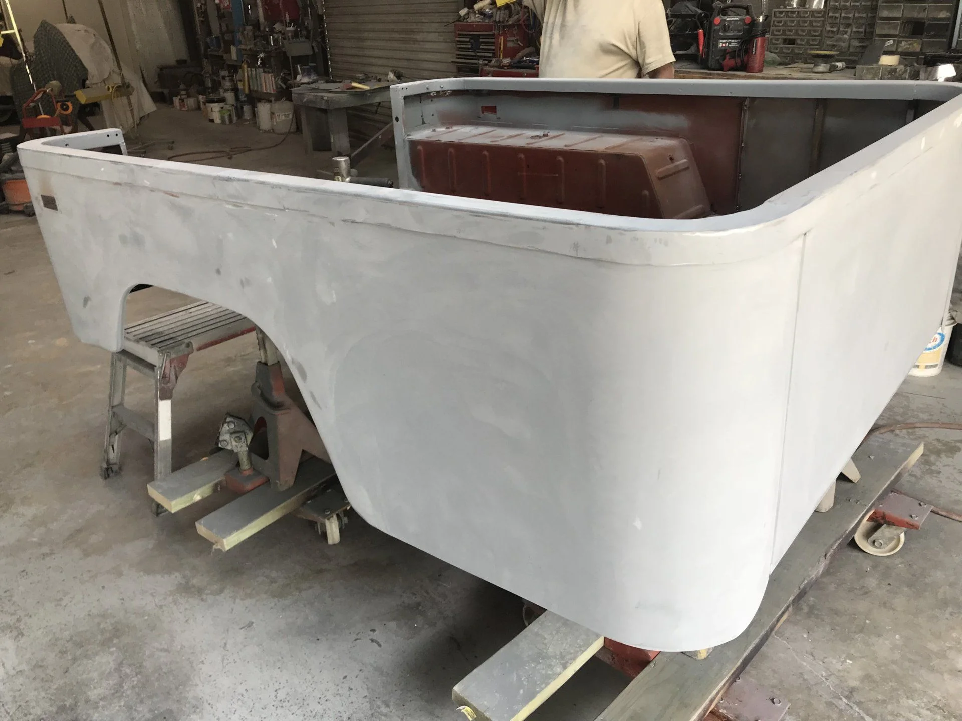

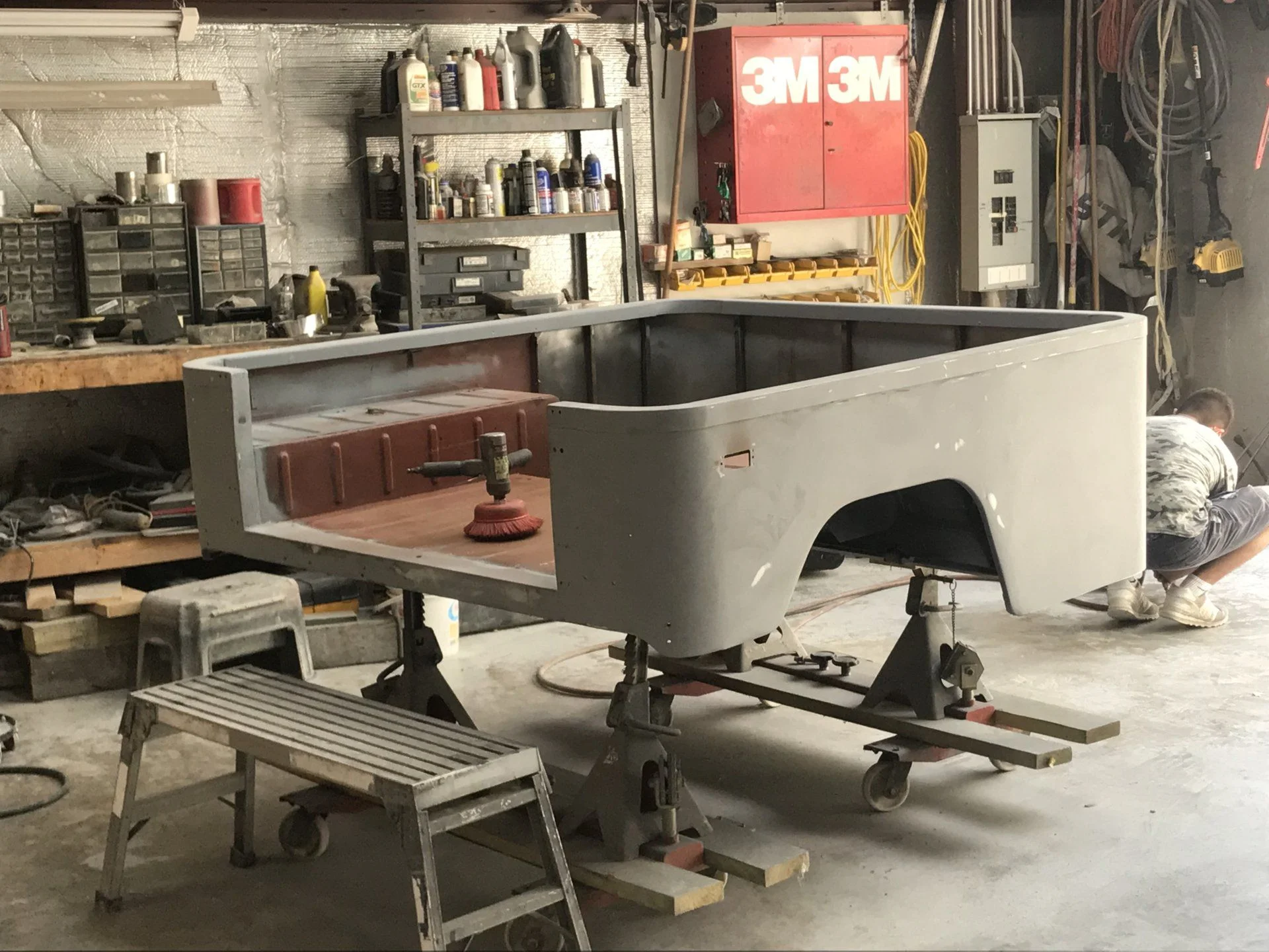

Body work and primer done
Paint goes on Monday!!
hOOter

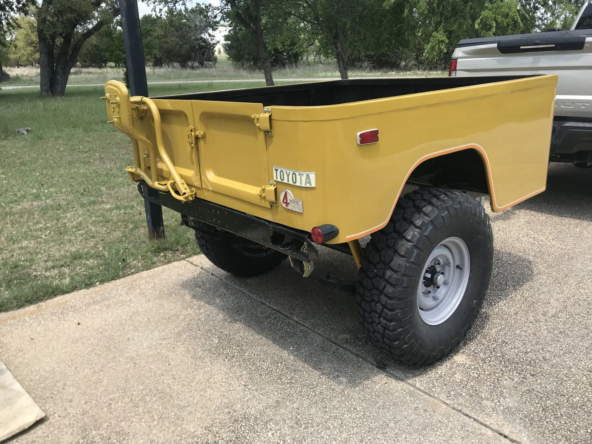

Are those wheel openings cut originally for the bushwacker style flares? The opening
does look larger. Nice touch with the pin stripe.
I don’t think so. I think the lift without the full weight of a land cruiser gives the impression of a different well opening. I’ll add the weight of a top, rack and RTT. If that doesn’t settle the back down a bit, I’ll take out a leaf (or 2). To match my 40 height.
Pinstripes will match my 40.

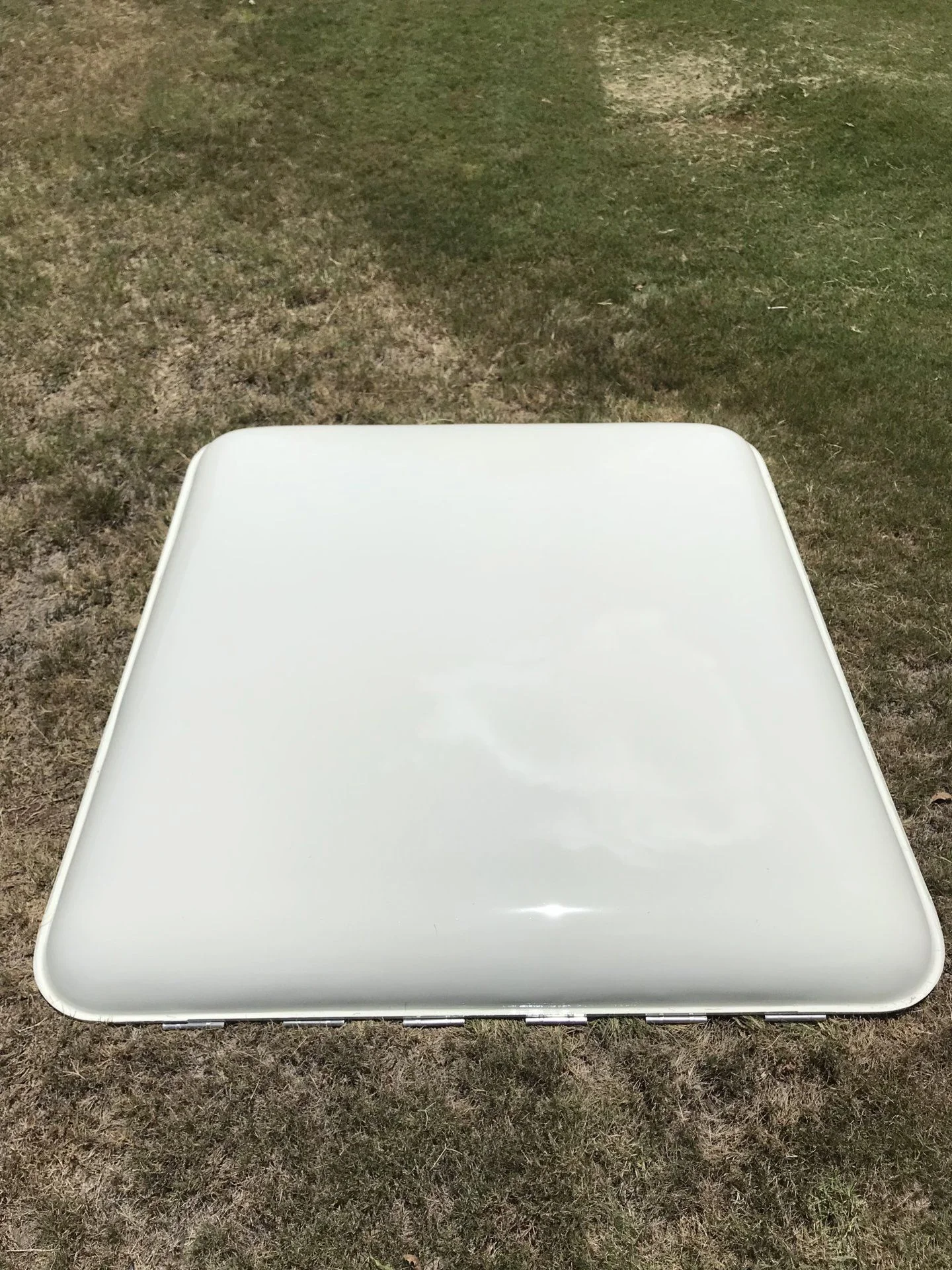

Roof work.
Got the CCOT roof channel welded up.
Repaired a ‘sunroof’ hole from an old top.
Spliced 2 tops together
Added a filler strip to make up needed width
Inching closer...

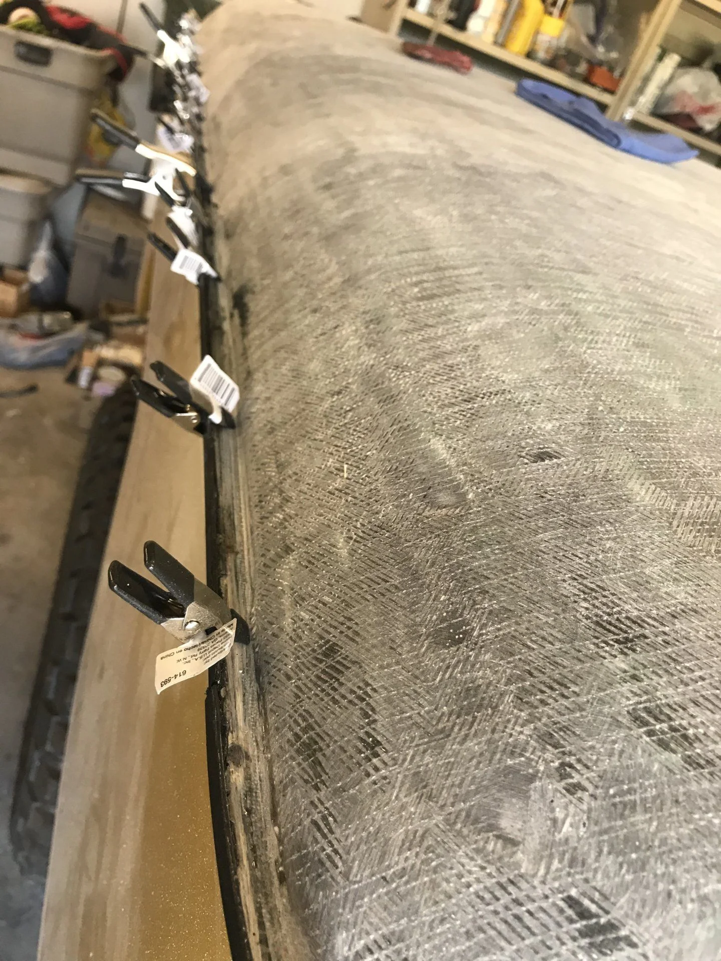

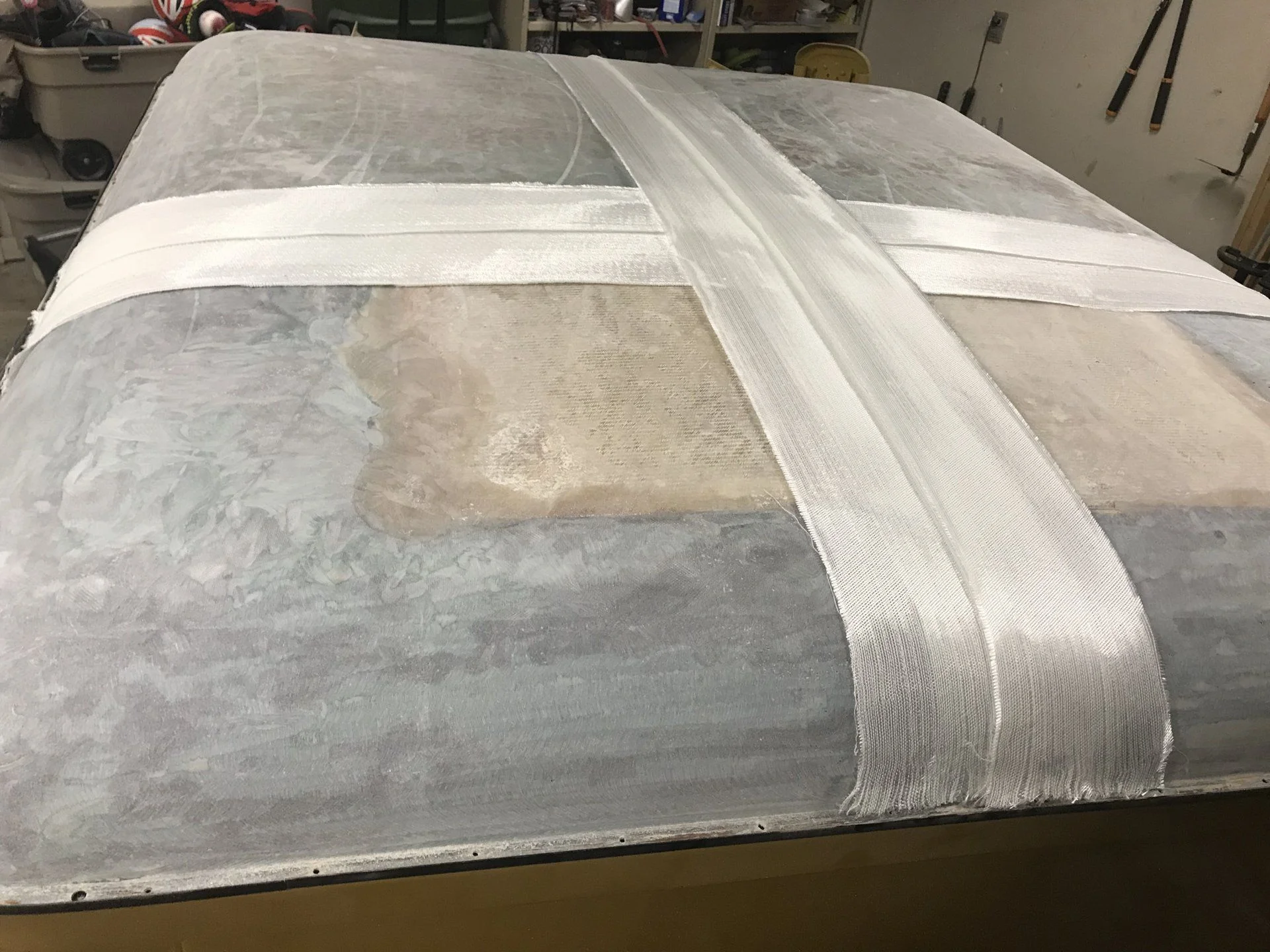

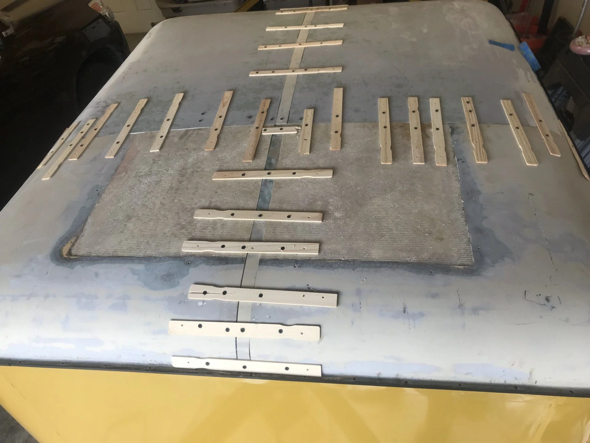

Top seams tabbed in place with thickened epoxy
Paint sticks/screws removed after epoxy cured

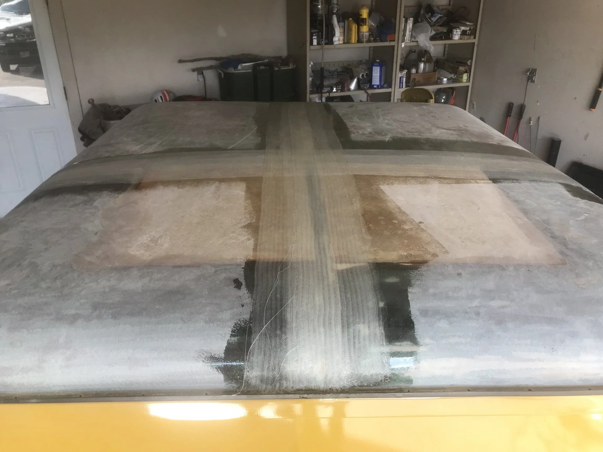

Sanded and 6 in biax strips cut to length
And epoxied into place
Next will be a full layer of 12 oz fabric followed by fairing, primer, Cygnus white paint.

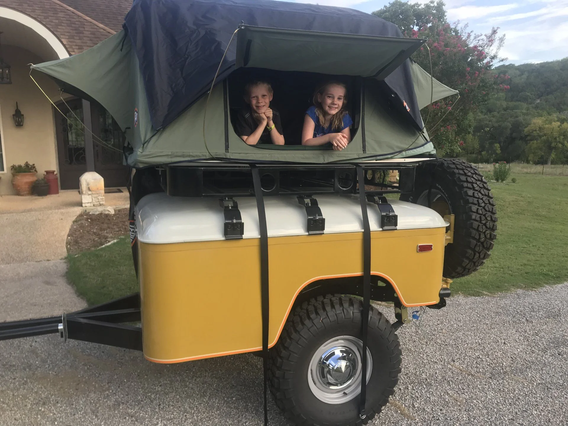

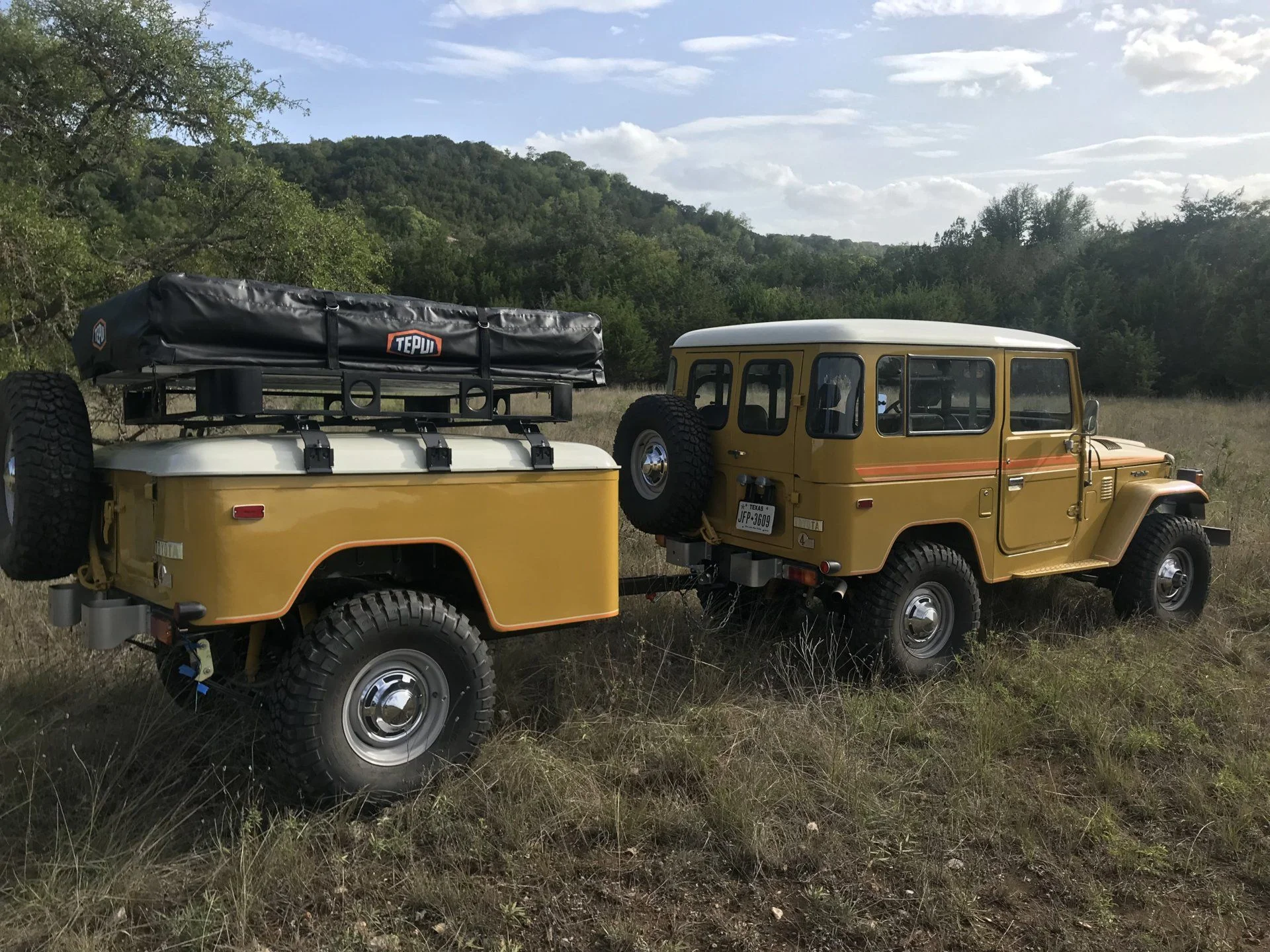

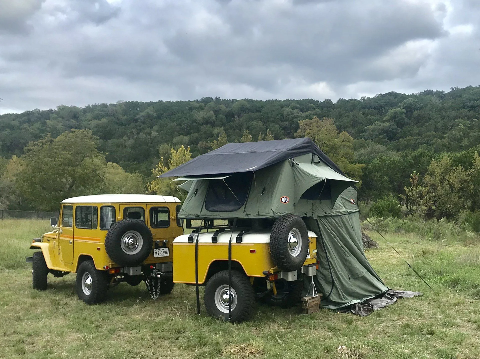

Con ferr rack added
Tepui ruggedized Autana RTT placed and tested.
Just need to do the little things like lights and registration.
Love the Tepui.
Still playing with straps and such but it’s super solid.
