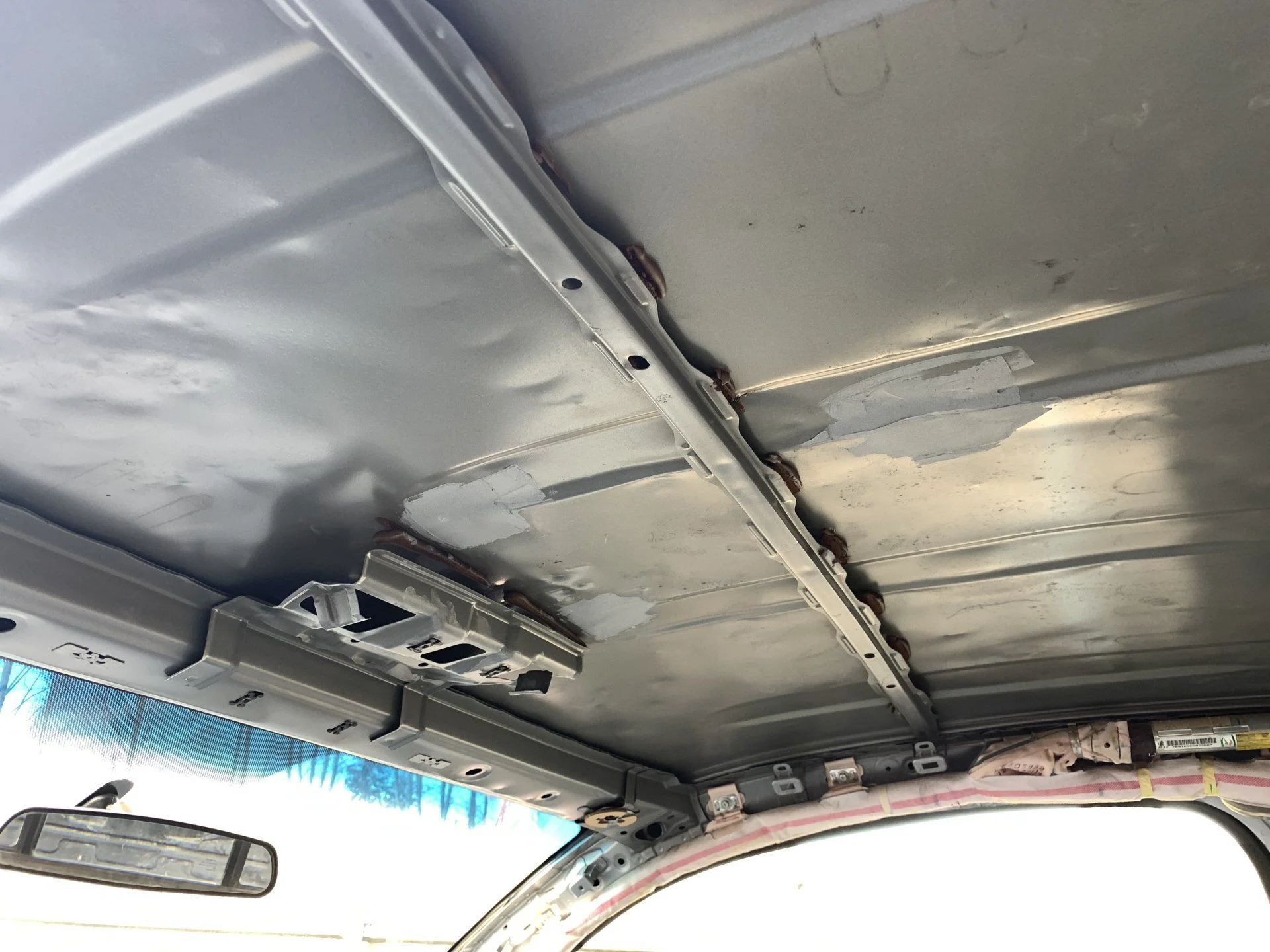

I’ve been working on my Tundra and the roof needed a lot of work. The cross rib inside has separated. The foam type expansion adhesive Toyota used remains soft but still is an adhesive. 10 yrs ago I painted my 60 and it had to have all the hood ribs reattached as they had separated. 10 yrs ago it was easy to find and we got a 2 part tube and glued away. Now no one seems to know what this stuff is.
It can’t be epoxy, I do t want it to harden hard. It has to remain flexible to allow movement of the panel.
Anyone have any ideas? Pic attached of inner Tundra roof, also need to attach console piece too.
3M hood flutter foam 08463
Fusor 121 or 124
SEM 39357
3M and SEM use the same gun
Thanks for that information. The hood of my FZJ75 has come loose from the struts in a place or two. Do you just put this stuff in to fill the gap without trying to press the two together? Hood looks perfect from the topside so I don't want to "glue" it down or otherwise warp it. It doesn’t seem to vibrate at speed but it’s obviously not being supported everywhere it should be.
