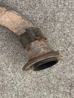

The down pipe has some stick out above the flange (see example pic below). I noticed that flange was not perpendicular to the axis of the pipe, so the amount of stick out was different around the circumference.
It seems if there is too much stick out, or it is uneven, the compression of the gasket will not be correct
I tried to even out the stick out with my angle grinder, but the problem still persists. does anyone know what the correct amount of stick out should be? when I tighten the flange nuts it does feel like the down pipe is bottoming out against the manifold. at one point I had about 0.040" gap between the flanges in the leaking area, and no apparent flange gap in the other areas. After I made those measurements I removed more of the stick out, but it is still leaking (I haven't checked flange gap yet.

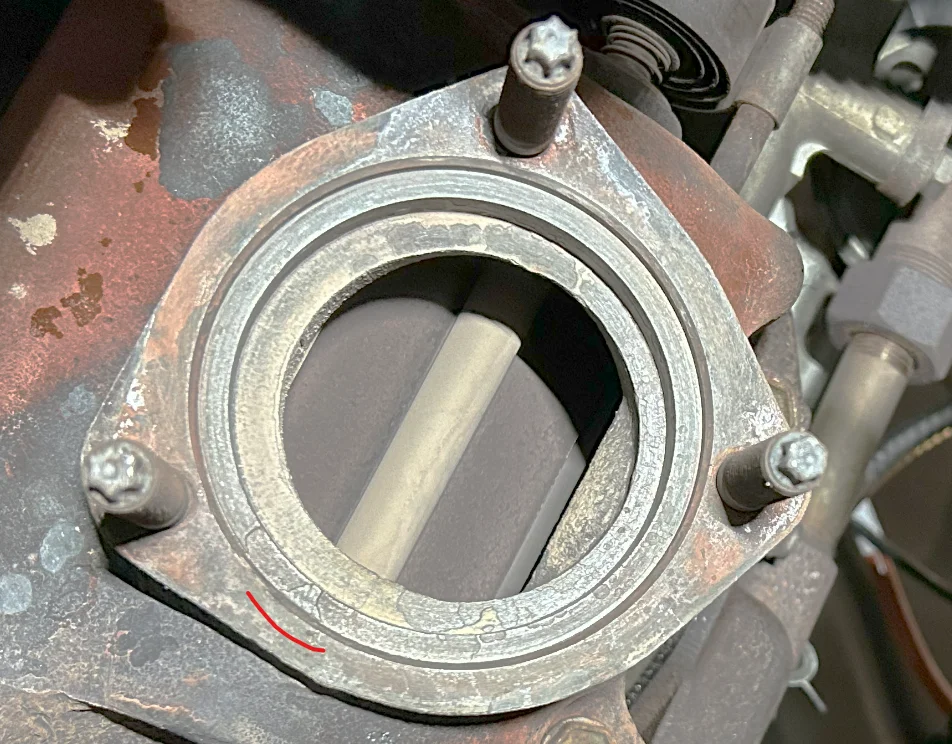

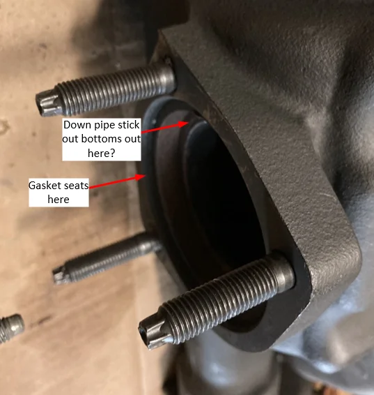

Below is a picture of my flange on the manifold side. There is a spot where the gasket fits that is either chipped or eroded away. I tried to smooth it out with a dremel tool, but I still have a leak.

I don't know what that 'stick out' should be, and I've never seen a measurement. If you insert the downpipe into the exhaust manifold WITHOUT the gasket, does it have a gap?
If yes, easiest seems to be to clearance the 'stick out' on the downpipe rather than remove material on the manifold and risk having that surface gouged.
I personally would first make sure all surfaces are flat and just Double-up on the gaskets dry and see if that works. Gaskets are cheap. Fel-pro are $3
I tried doubling up on mine and it leaked worse. Its almost like 1.5 gaskets would be perfect but 2 is too much and 1 sometimes isn’t enough.
Thanks for the feedback guys. I doubled up on the gaskets and the leak seemed to stop! This is encouraging for me because I was becoming convinced that my exhaust manifold must be cracked. For now I'll stop worrying about that.
