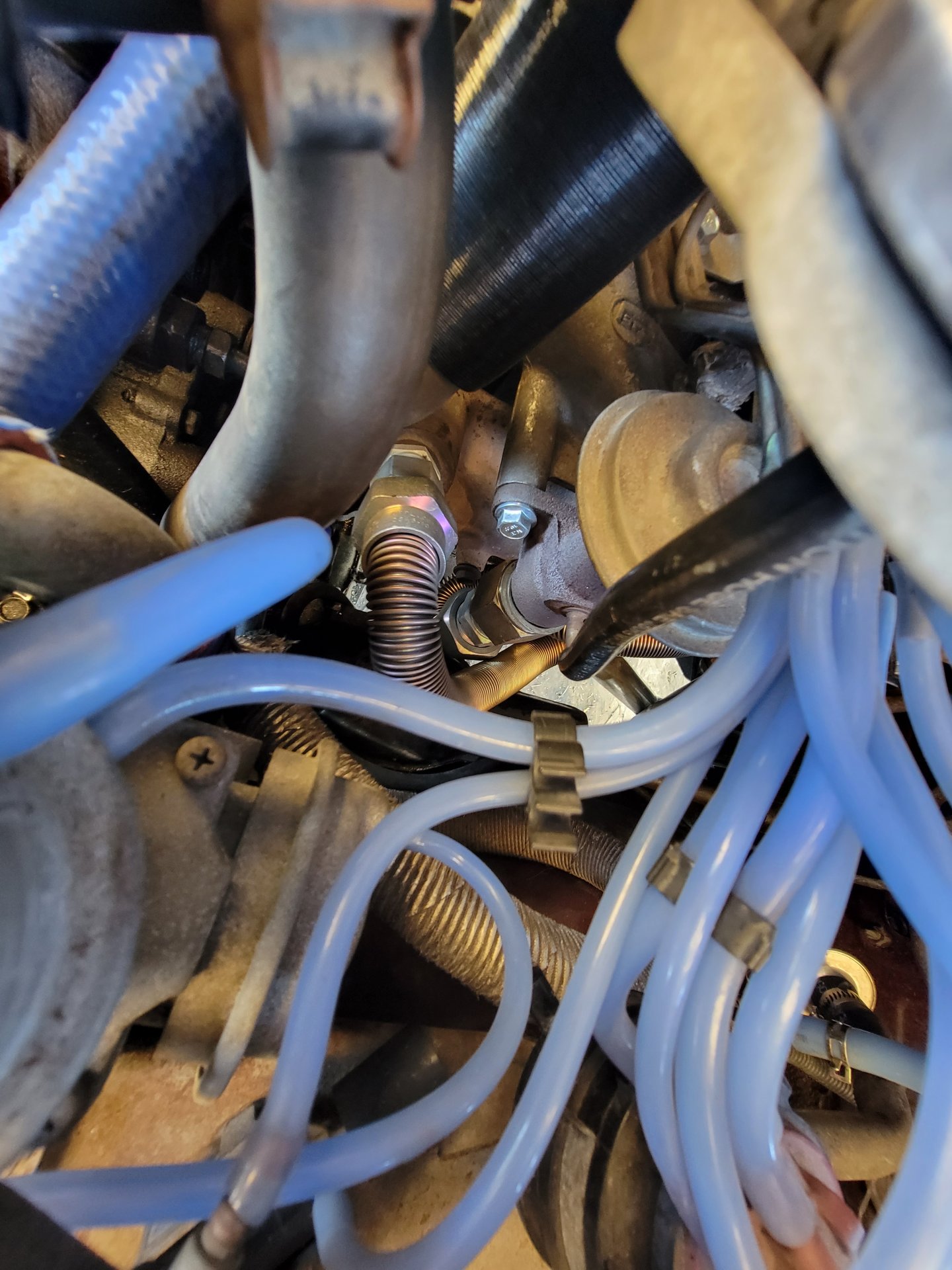

Here are some install pics. This length gives the EGR gases some opportunity to cool which should help reduce NOX.
Despite the truck likely running a little lean, NOx was nice and low. I theorize that because the 3FE manifolds do not superheat the air like the 2F one did the cooler intake temps are helping reduce NOx production.
