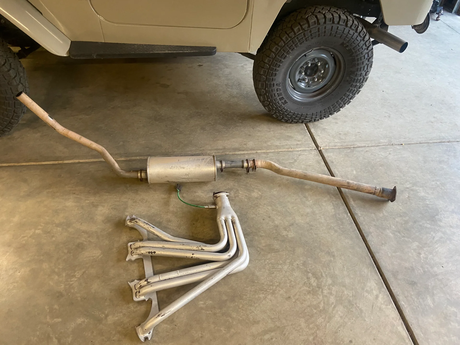

If you’re in the southern part of the Central Valley I’ve got a Man a Fre header with O2 bung and the rest of the exhaust system for cheap. I was running the Howell FI before I seized my F.5.

I am at the north end of the valley and an hour east. But, would be worth a road trip for the right price. Also, are the headers a direct fit to the 2F. Pictures?

A case of Fall River Mills IPA I think the header was universal to the F, F.5 and 2F I had it on an F and F.5

I am in Sutter Creek. Looks good for my project. I already did the exhaust from the flange back 2 1/4” but if it comes with it. How much are you looking to get for it.

I just want a case of a local IPA for it. I thought you were closer to Redding. I’m not very good at selling stuff (obviously) so let’s just trade some beer.

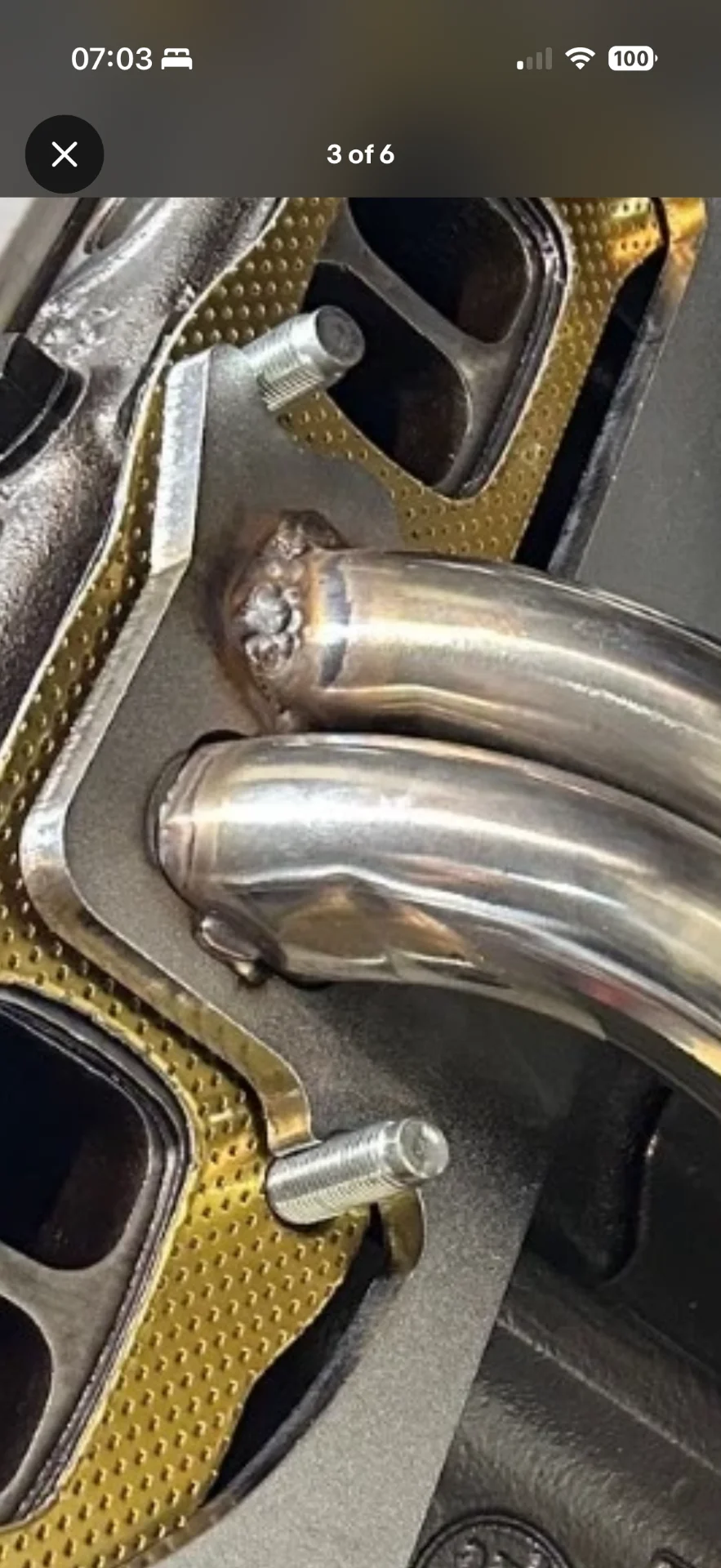

Benson tuning has a very reasonably priced stainless steel header. It fits my 76 2F engine perfectly.

I went on their website to look but I couldn't find anything. Is it a custom order?
Might have to fork out the money for a TriMeki.
In the long run, you'll probably be glad you did. I am fortunate enough to have one of the original Downey/Mark A. headers. It's gotta be 25 years old. It was the expensive header back then. Not as pretty as it used to be but it still works fine. If it ever fails I'll get the Tri-Meki, until then I run it.

Yeah mine just so pitted and when I'm in the cab I can smell the fumes coming from the front. I think its worth spending the money at this point, I'm too far gone and I should just keep going. I asked for a discount code *fingers crossed*.
