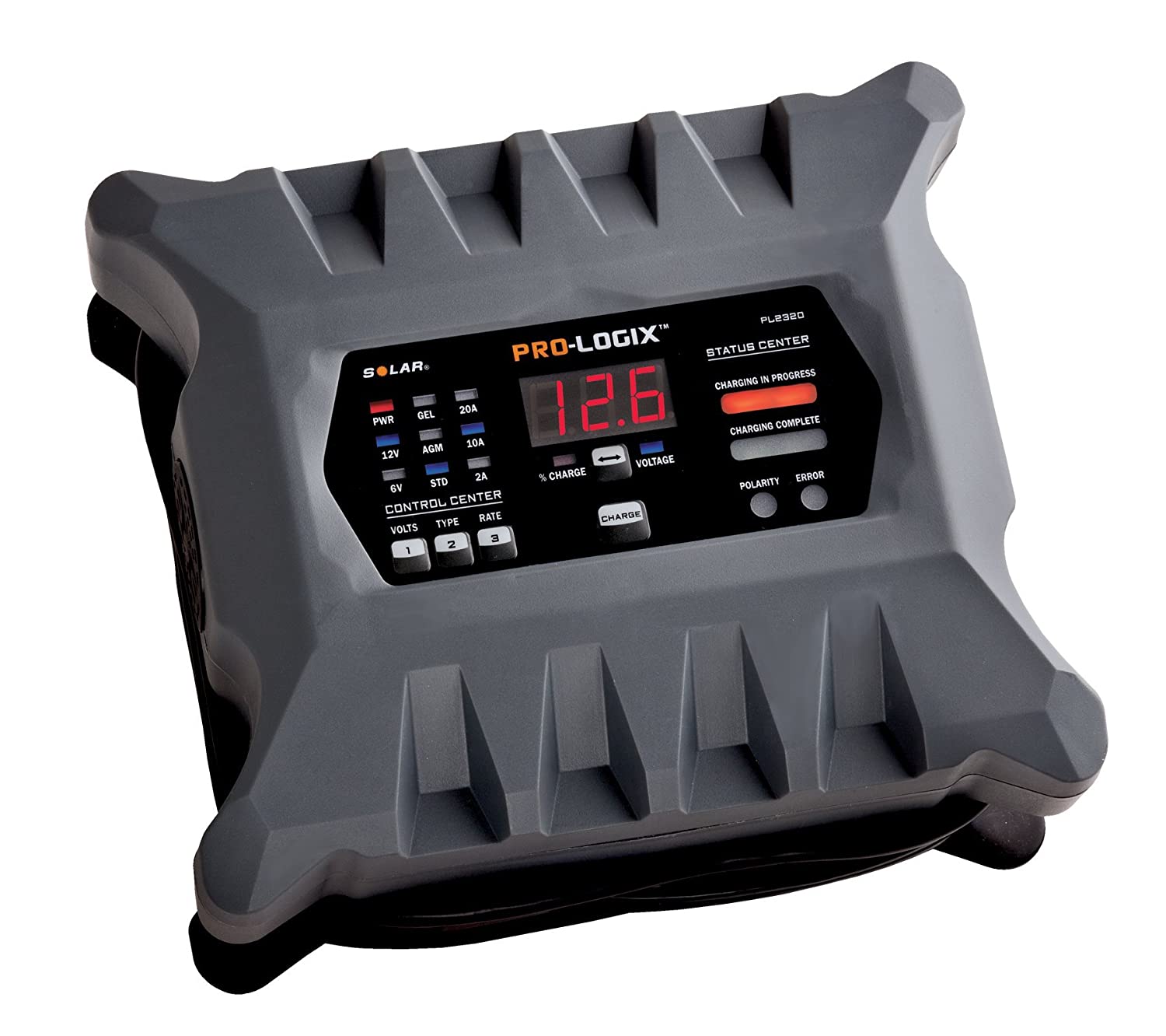

Get a decent battery charger. You can get decent stuff for fairly cheap.
I recently got a Solar brand Pro-Logix 2320, a 2/10/20A charger/maintainer with desulfation and a unique maintain feature. After keeping 2A on it at 13.7V, roughly once every week or so it puts a load on the battery for a little bit and then charges it back up. They claim this is good for the battery. And it was only $67!
http://www.amazon.com/BA9-40-1200-Digital-Battery-System/dp/B00IZFNJ6Y/ref=pd_sim_263_1?ie=UTF8&dpID=416+Ue1xIgL&dpSrc=sims&preST=_AC_UL160_SR160,160_&refRID=0532444WY4XD165Y8P60

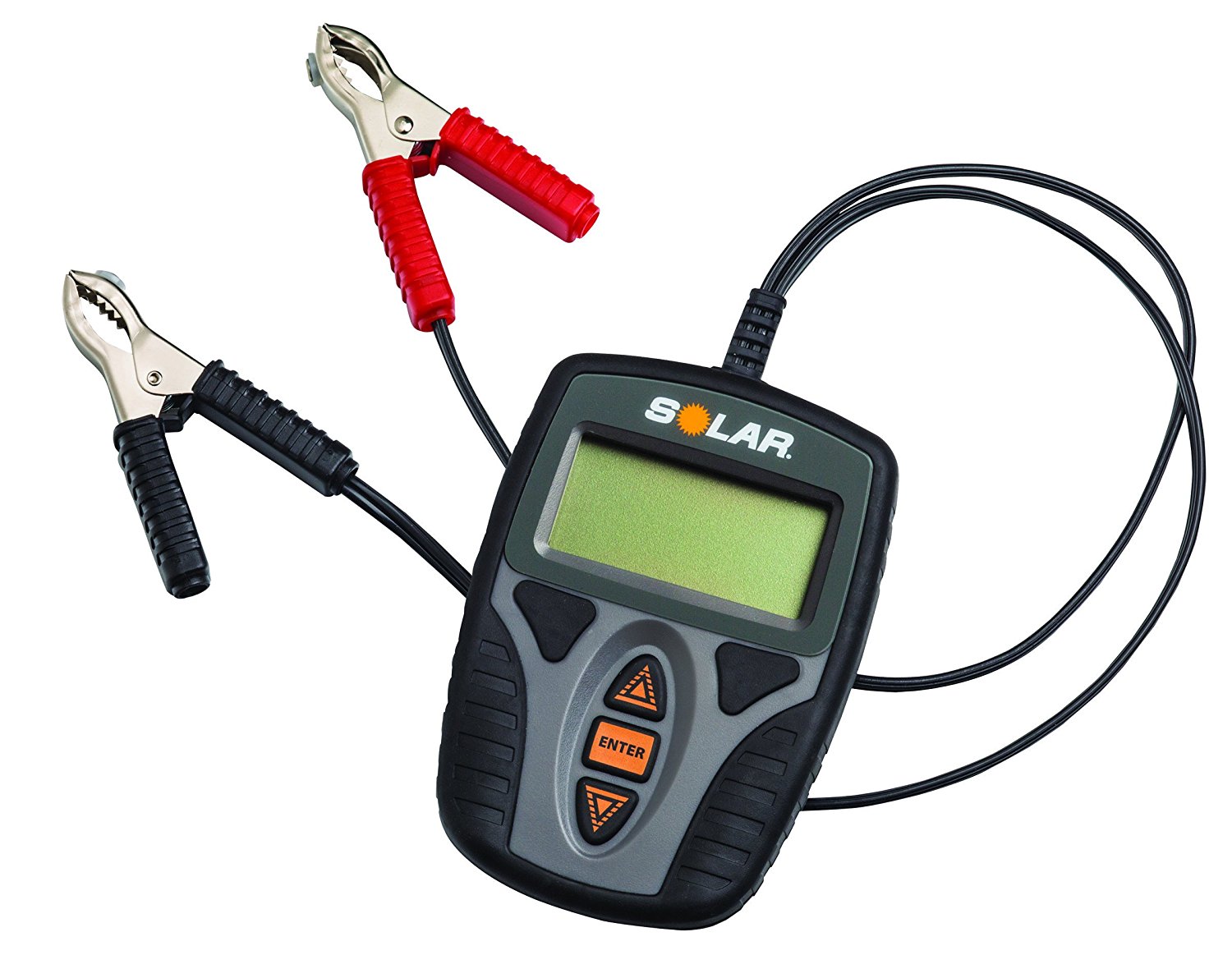

You can also get a tester for $50-$60 bucks that tests the battery and the charging system.
I got this at the same time:
It tests CCA's for a pass/fail grade and the alternator.
Amazon.com: SOLAR BA9 40-1200 CCA Digital Battery and System Tester: Automotive
I got tired of draining batteries and guessing on their health with nothing but a DMM.
Now I can take better care of most of our car batteries.
