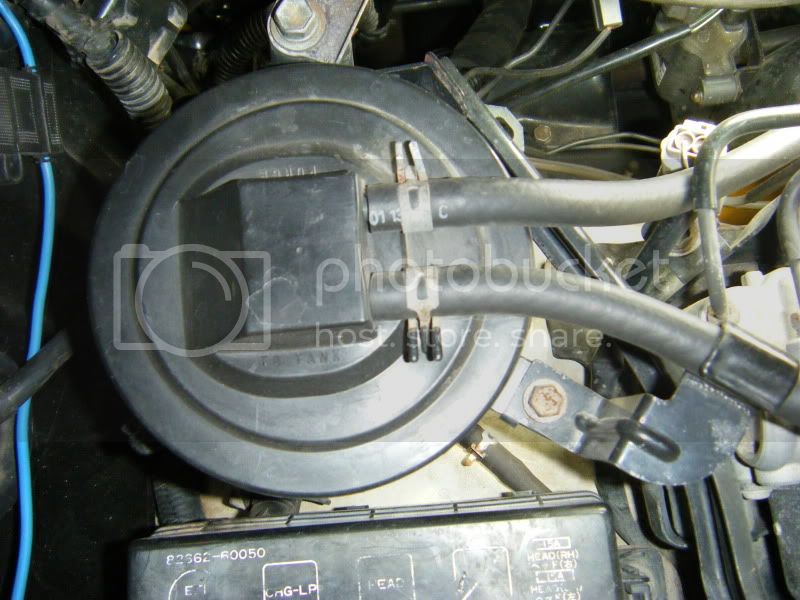

I use 93 octane...no difference. I also have a new gas cap...no difference. I did notice tonight that the line on the bottom of the cc is vented to the atmosphere, not to a fitting near the frame as others have experienced.

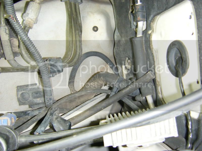

From the cc the line goes under the ABS pump
and heads towards the DS inner fender where it vents
