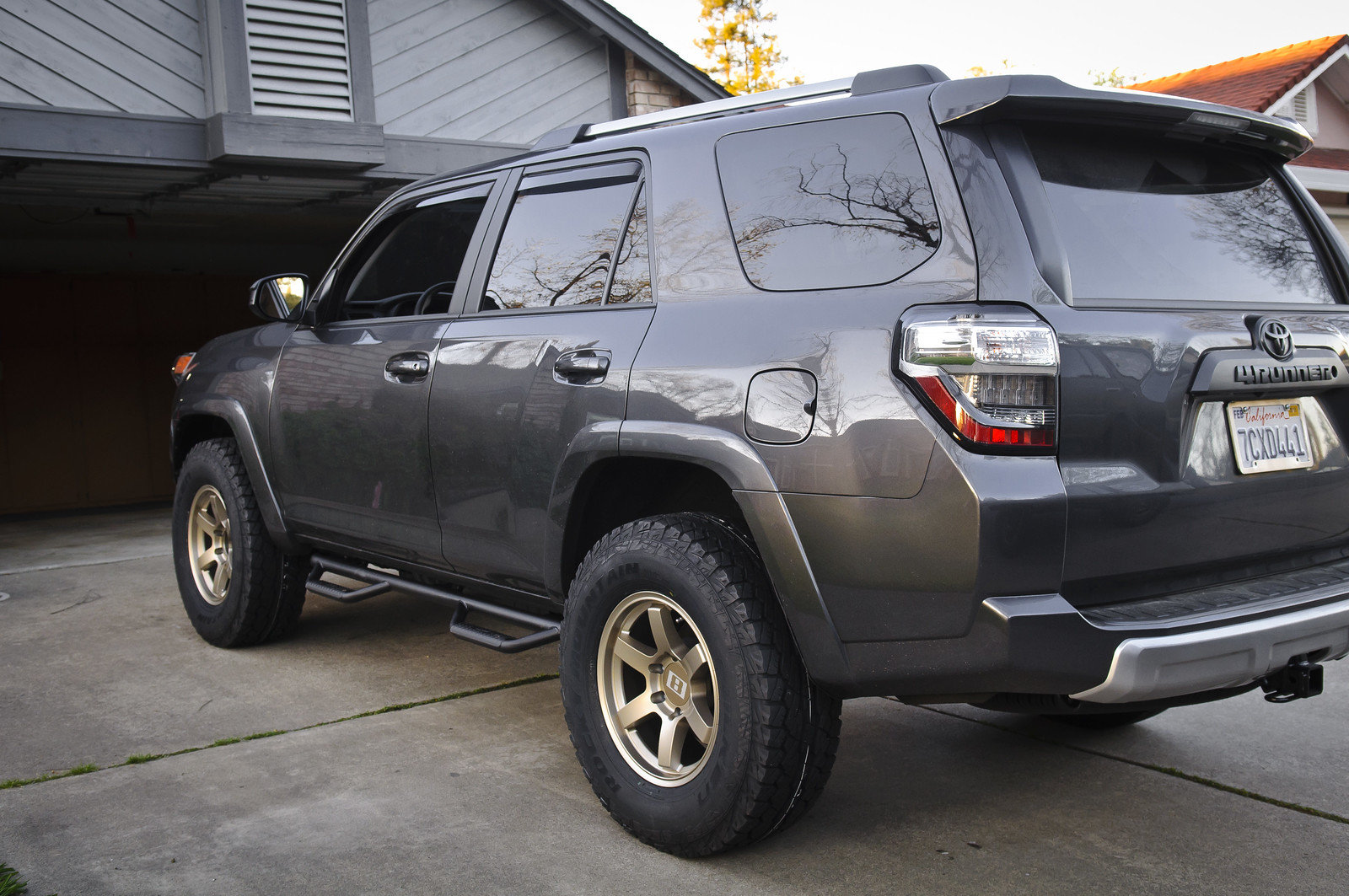

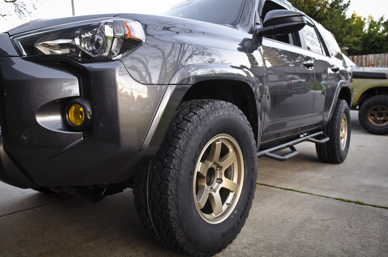

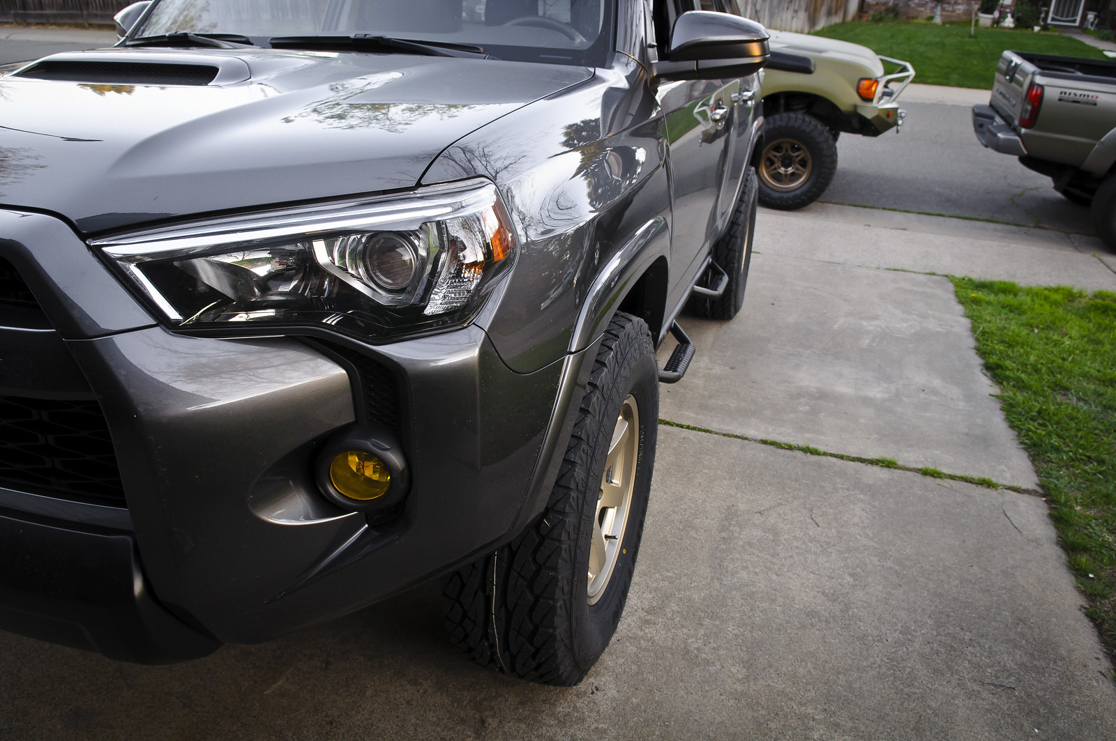

Damn Jose, the 4Runner looks wicked with the new shoes! That front end is starting to grow on me. Awesome color combo too.
Thanks man! Here's a few more pics for the heck of it, it is a Toyota afterall :) So far I've blacked out the emblems, blacked out the front silver chin, painted the fogs yellow, added side steps, and HIDs from TRS. Up next will be a small lift in the coming weeks as the tires are too big for stock height, that was just a test fit.
