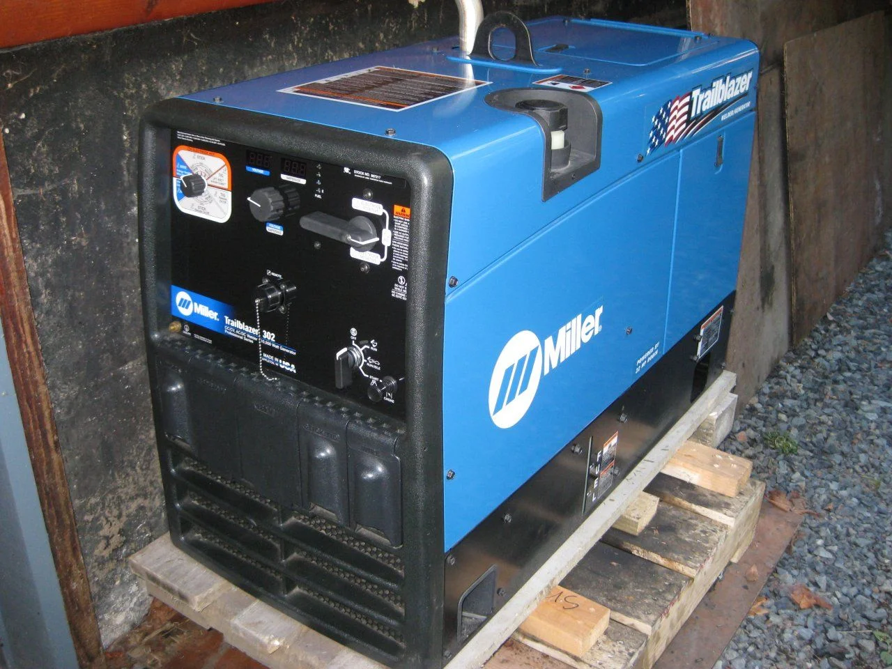

I was recently out of electricity at the house for a solid three days after a large storm. No power makes working on the FJ difficult to say the least. Just picked this up, Miller Trailblazer 302, no more power problems :cheers:
Lol, that's why I sourced up a used unit with only 10 hours on it, WAY below retail

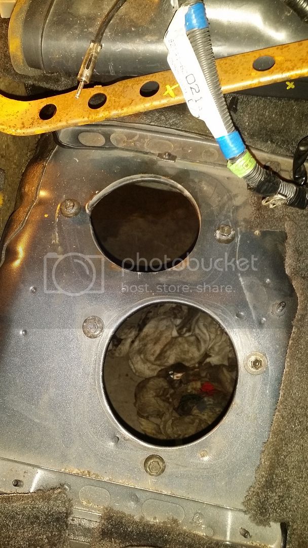

To those who have the later models 95-97, how far up did the upper shifter boot fit into the "U" recess at the front (2nd picture)? In my rig it looks like it should snug-up completely against that mount/SRS module, and act as a guide for drilling the five mount holes which link to the lower figure 8 bracket (and help as a guide to how much material to remove for the lower boots on the shifters themselves).
Now that both the trans and motor are out, I can get under there and will be doing a bit of grinding and cutting soon...just want to measure twice, cut once. Any pictures of a factory 5 speed setup for would be exceptionally helpful, measurements to the captive nuts would be even better.
img_1623-jpg.1157967
Here is the assembly set in place in mine. There is no wiggle room at the front whatsoever.
full
This is the figure 8 which will be below the sheetmetal, with the captive nuts for the boots.
full
Perfect picture, Tweek. The measurement from the center of the lowest captive nut/bolt to each of the studs on the lower bracket, and distance from the nut/bolt to the lower bracket will help triangulate the lower section. With the upper, a measurement from the bracket to the hole. It looks like I thought it would, with the holes in the floor slightly larger than the 8 bracket itself. I will likely do the same, so that there is a little wiggle-room for final fitment, and the bracket provides is a smooth and even seal to the boots on the shifters.

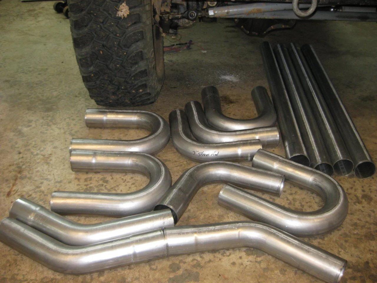

Started the exhaust today.... Obviously taking a detour from the factory Toyota stuff here. This is a 3" (aluminized, universal) kit hiding under the FJ40. I debated going all stainless but the cost was way too much. I've used these kits before and they are good for 10+ years easy. Plus, I have enough tubing to make two exhaust systems.

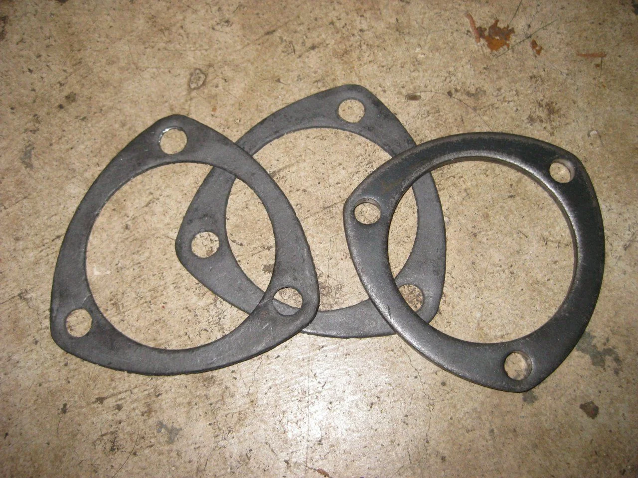

I used a standard 3" exhaust collect and gaskets to mate the tubing to the turbo outlet. The holes are VERY close and I opened them up just slightly to 7/16" so the collector would fit on the outlet.

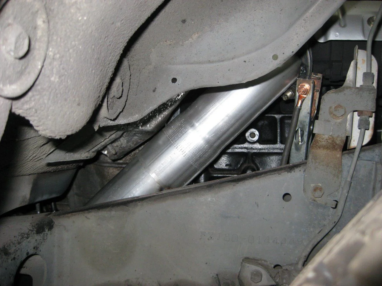

Looking in from the front tire. The 3" is tight between the frame and transmission but it will fit if you take the time to get it just right

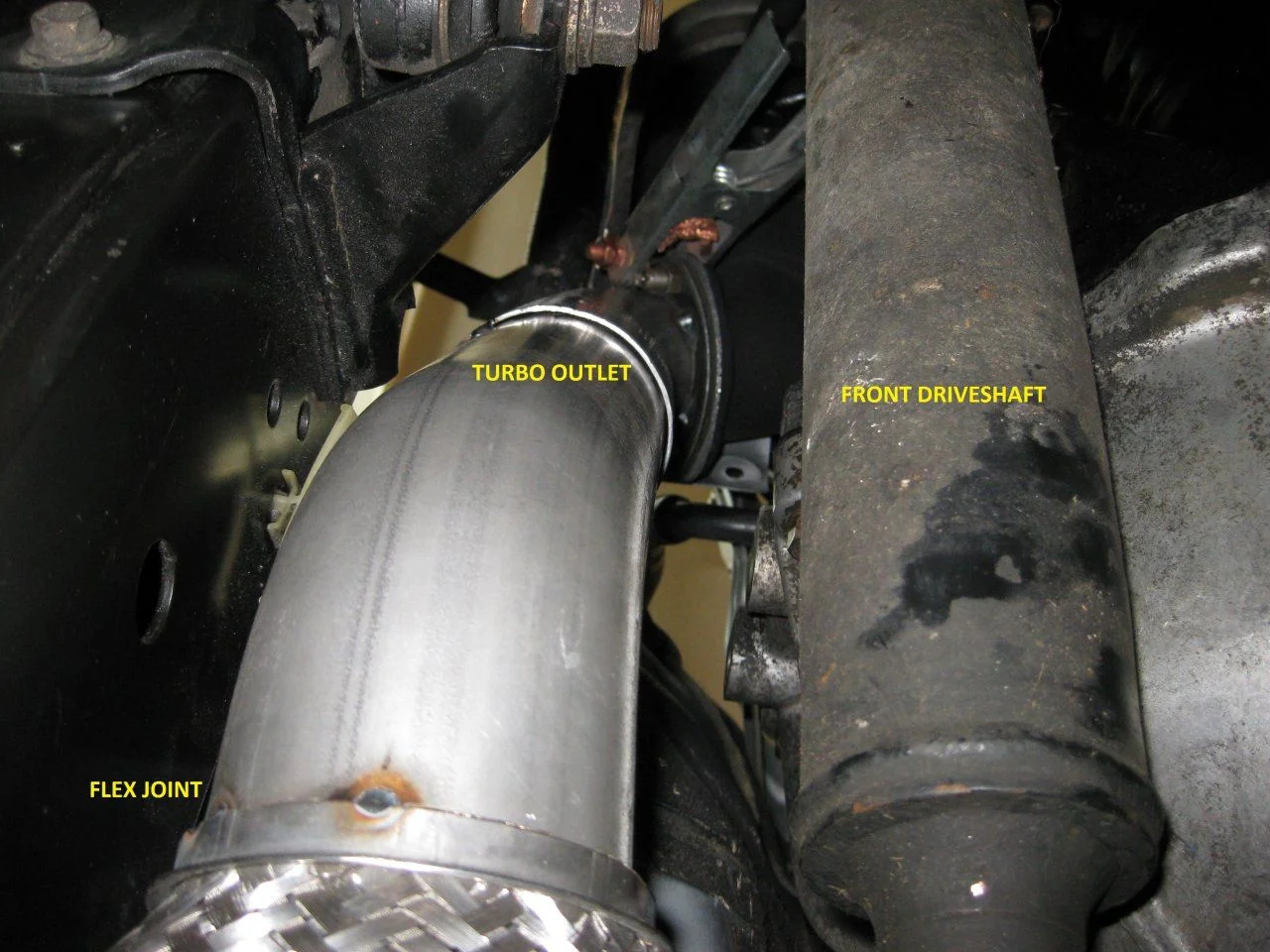

I used a "turbo" flex joint which is rated for very high temps. It's stainless steel, 4" long and I placed it as close to the turbo outlet as possible. Disregard the plastic zip tie, it's in mock-up mode.

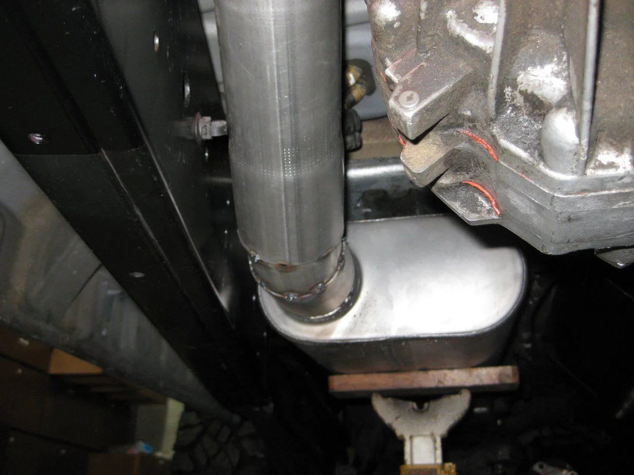

The muffler is in also. This is a Dynomax unit with an offset inlet/outlet and I managed (after a lot of screwing around) to get it in place while keeping it tucked above the frame. I'm using the factory heat shielding also.
Last pic shows the clearance of the turbo down pipe

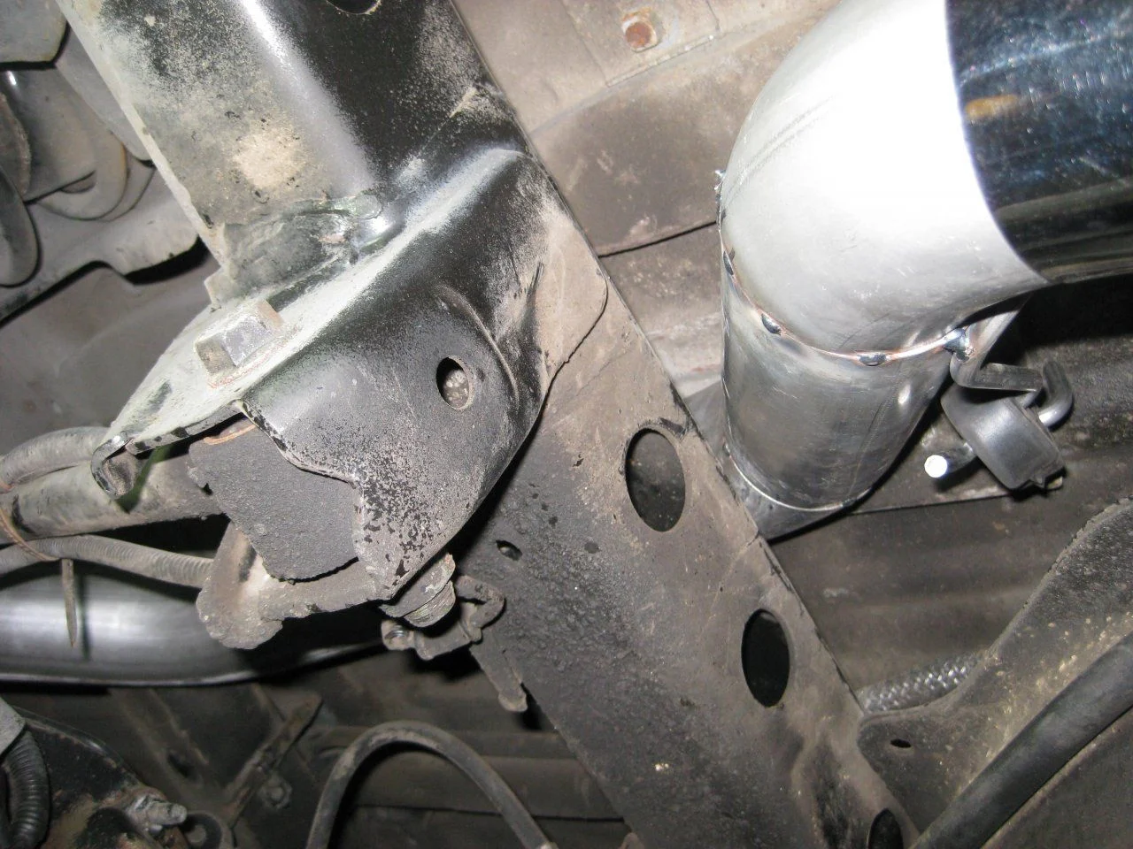

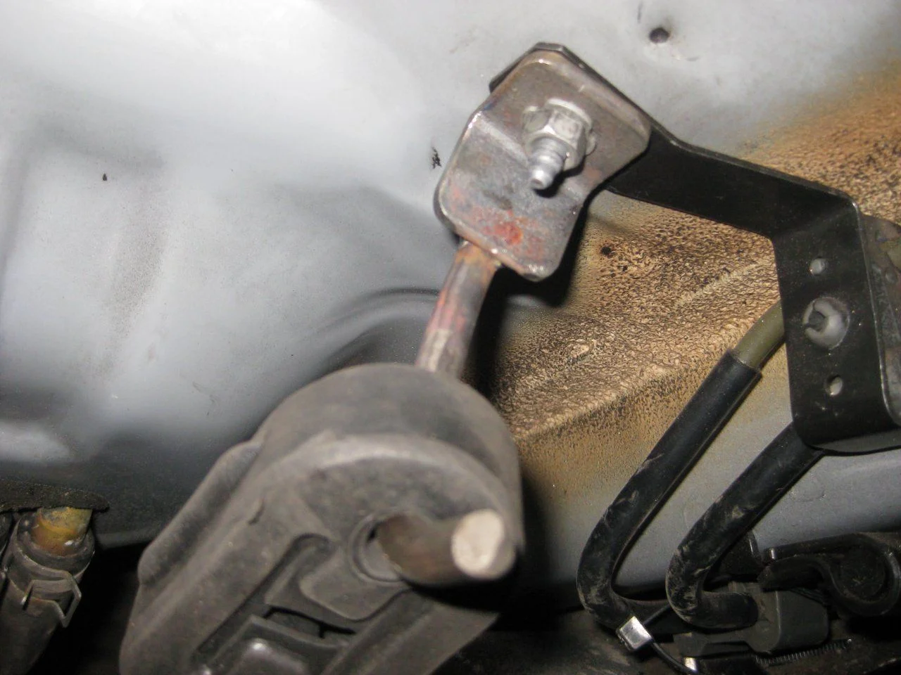

Finally feel like I made some decent progress on the exhaust today. After knocking myself nearly senseless when the muffler fell on my head yesterday, the whole exhaust in place for now. I've run it just past the rear axle and I'm going to wait to finish the rest until I get my rear Cruisin' Offroad bumper in place.
I couple of things. I made my own hangers using parts ordered from Summit Racing and some 1" angle iron. I've always like the rubber isolators that Toyota used and these are very similar. They allow you to put some tension into the works to keep the exhaust from banging around. Everything is tacked in place currently.
I also used some stainless clamps to help with the assembly/disassembly process. As it sits currently, I can unbolt the entire exhaust system in pieces. This was especially helpful with routing the exhaust over the rear crossmember. They make both butt and "slip fit" clamps and they are torqued to 40-50ft/lbs, they shouldn't leak.
This pic shows the rear of the muffler and the exhaust passing over the rear crossmember, there's not a lot of wiggle room here...
Up and over the dirty old rear crossmember, I will probably be picking crap out of my eyes for weeks after this
And dumped behind the rear axle, just temporary for now
