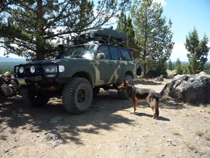

I used epoxy floor paint when I painted my LC desert tan three years ago! Very tough! The OD is Find Krylon Project Camouflage Latex Paint, 1 Gal Olive Drab and other Specialty Paint Products at Aubuchon Hardware :cheers:
It was bi&*^ to apply with a spray, because epoxy can contains both Kevlar microfibers and feldspar ceramic, however, it can be done with patience and cleaning the noozle to the sparyer often.
