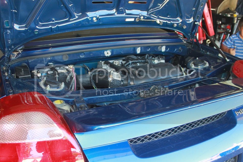

Hi. I'm new and have always like the fj80. Now I've been searching for a long time on and off. I'm in my 30s, have some experience with swaps and electrical. Here is my sport car that I have dreamed of so long long long and I did it myself after no one was willing to do it. It was a 2grfe (3.5L) with an e153 in a mr2 spyder running a Vipec V88 with DBW.

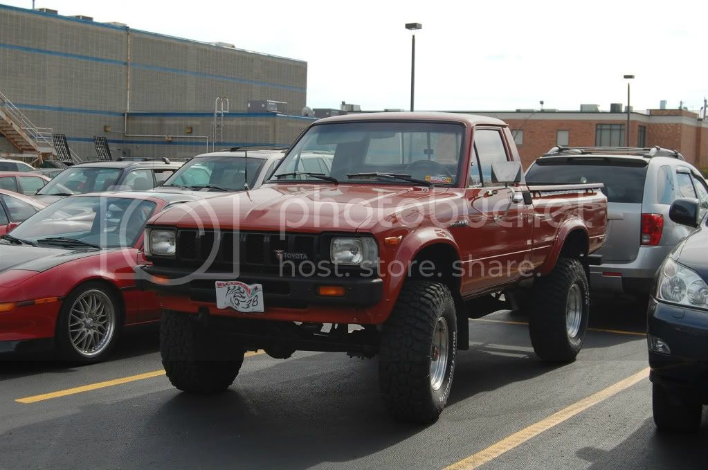

My truck which I sold to my brother. Swapping in a 5vz whenever he pays for everything.

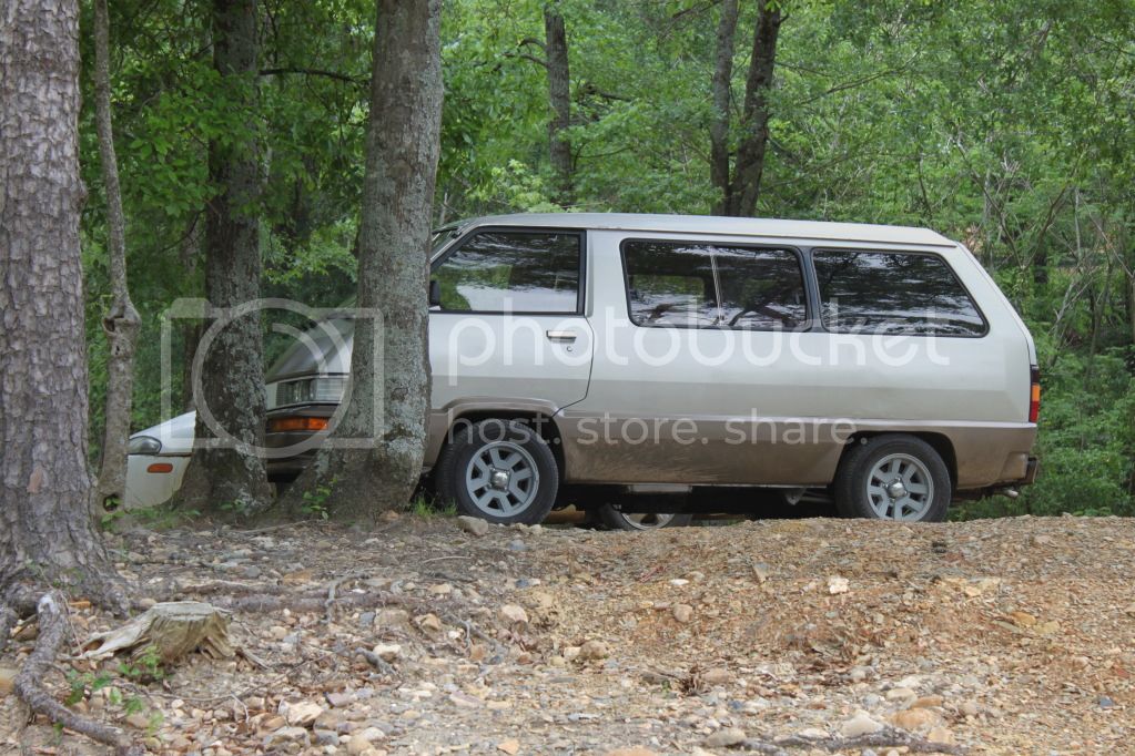

My old Van I sold. I was the 2nd owner, drove from WI to AR doing 70+mph. I did some exterior work, repainted it, and put in a system.
