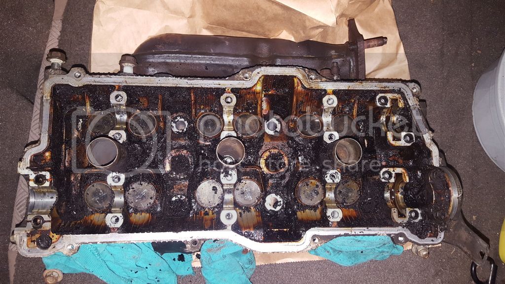

Removed valve covers and took a look at top side of heads... Gross, previous owner used penzoil it looks like.

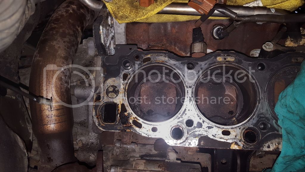

We removed both heads and noticed oil entering the water jacket on the rear passenger side of block (near piston 5)
This seems to be the culprit. It would explain the contamination in the oil. BUT, should I be worried about anything else? Crankshaft? internal Bearings? I know this contamination could damage the internal specifics.
If so, are there any cleaning agents to be used without tinkering with the piston assembly? I don't want to disturb them unless I absolutely have to.

As far as the oil pressure I don't think that assuming that coolant in the oil is the only cause. Coolant/oil mixed would pump through the system as well as straight oil, or almost as well, and shouldn't effect a pressure reading or trip light much if at all.
The charred looking topsides makes me think overheating and that makes me think warpage and/or cracking, either head, block, or both. I'd want to drop the pan at least; try to look at the cyl walls.
Sorry to bring this but I'd be surprised if changing the head gasket is the end of this engine's troubles.

I will make it short and direct to the point,engine is toast and it will cost you more money trying to keep this engine alive. Get a low mileage engine or even a JDM replacement make sure to remove cover to inspect for sludge build up. There is no cleaning agent out there that will melt all that build up it will just clog your oil pick up reason why you are losing oil pressure due to blocked passages. Good luck on this project.

my heads have been tested and resurfaced, and had the block deck (rebuilt the motor while it was apart) and still have steam out the exhaust. At this point my only conclusion is I have had multiple bad head gaskets or more likely: a hairline crack in the block that some how we missed.
