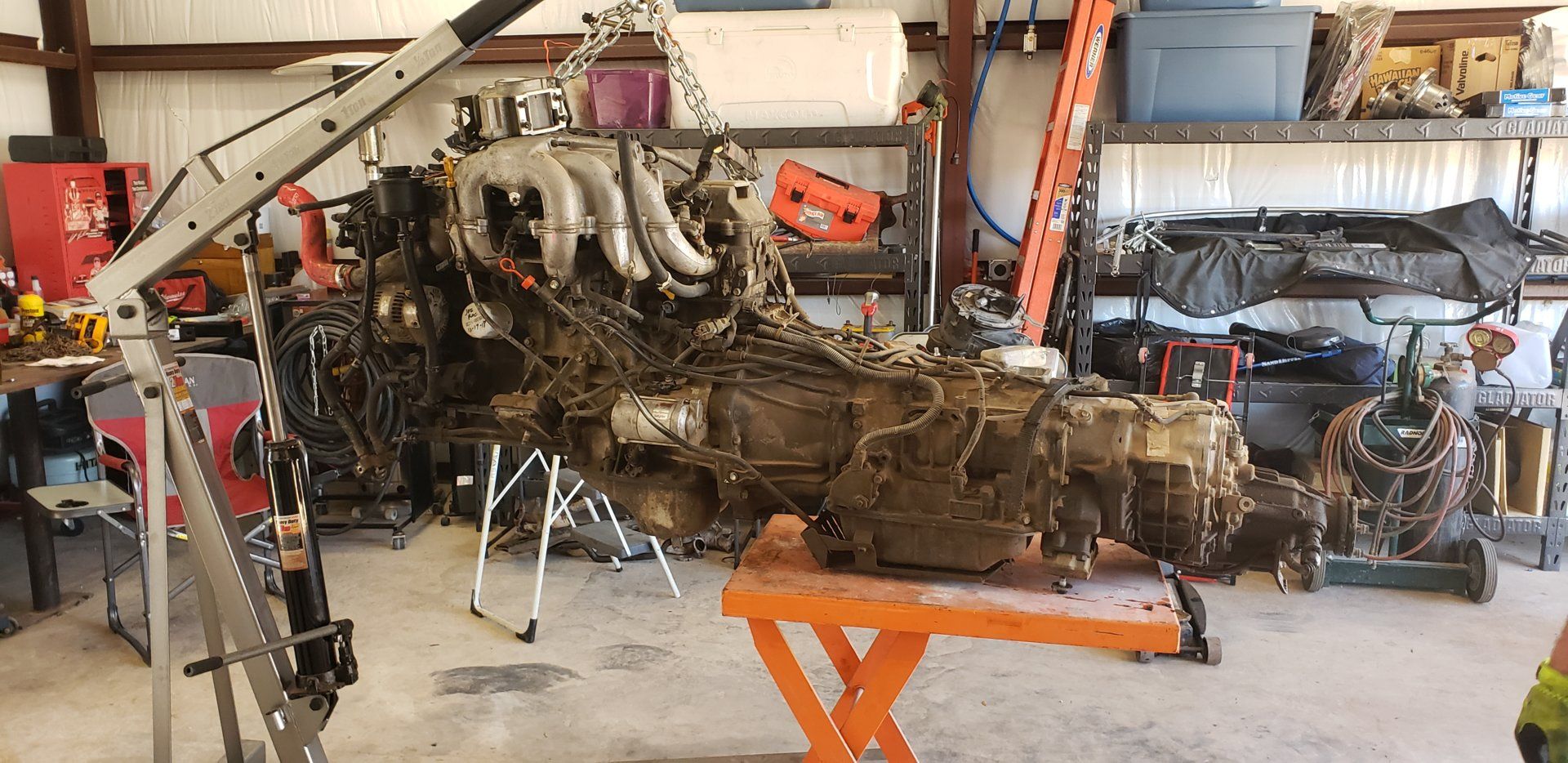

I asked this earlier, but didn't get an answer. Once the engine and transmission are out, dangling from a hoist, how am I supposed to get the transmission separated and remove the intake manifold? Do I set it on the floor? Is there another kind of stand that would accommodate the whole drivetrain? I'm ready to pull the motor, but I really don't get what happens next. I've got a hoist and engine leveler, but I don't have any way to attach the chains to the block yet. I also don't have an engine stand, and am trying to avoid buying one. But I just can't visualize what happens between pulling the motor and dropping it off at the machinist.
I usually get some used spare tires and rest the engine/tranny on them for disassembly.
I kept the engine on the hoist and lowered the transmission on a flat dolly. Unbolted everything and kept the transmission on the flat dolly. The engine on the other hand I took directly to the machine shop. If you are going to keep the engine at home for a while, you can get an engine stand. The chains can be attached using some old head bolts and a nut.

Like this. Buy one of these Jack's. It is useful when clearing the transfer case from the front when you pull it all and you can set the transmission on it once out.
The intake manifold can be removed by removing all of the bolts holding the manifold to the head then un clipping all of the sensors and hoses. It will all come off together. It's not bad. Just look at and you can tell pretty quick what needs to be removed.

Thank you for posting that picture. It helps me more than you know. That stand looks a lot more versatile than an engine stand. I could easier justify that than an engine stand. I'll look into it.
It's a motorcycle Jack from harbor freight. It's been very useful
With a 25% off coupon you can get a 1000lb engine stand from HF for 45$. FYI.
Personally, I’d get a big sheet of cardboard and throw it on the ground, land the whole thing on that and then you can split the trans on the ground. Might need a friend to help you. Probably keep a little tension on the hoist to keep everything from flopping on its side. Just have to manhandle the trans and tcase off. They dont weigh that much really.
