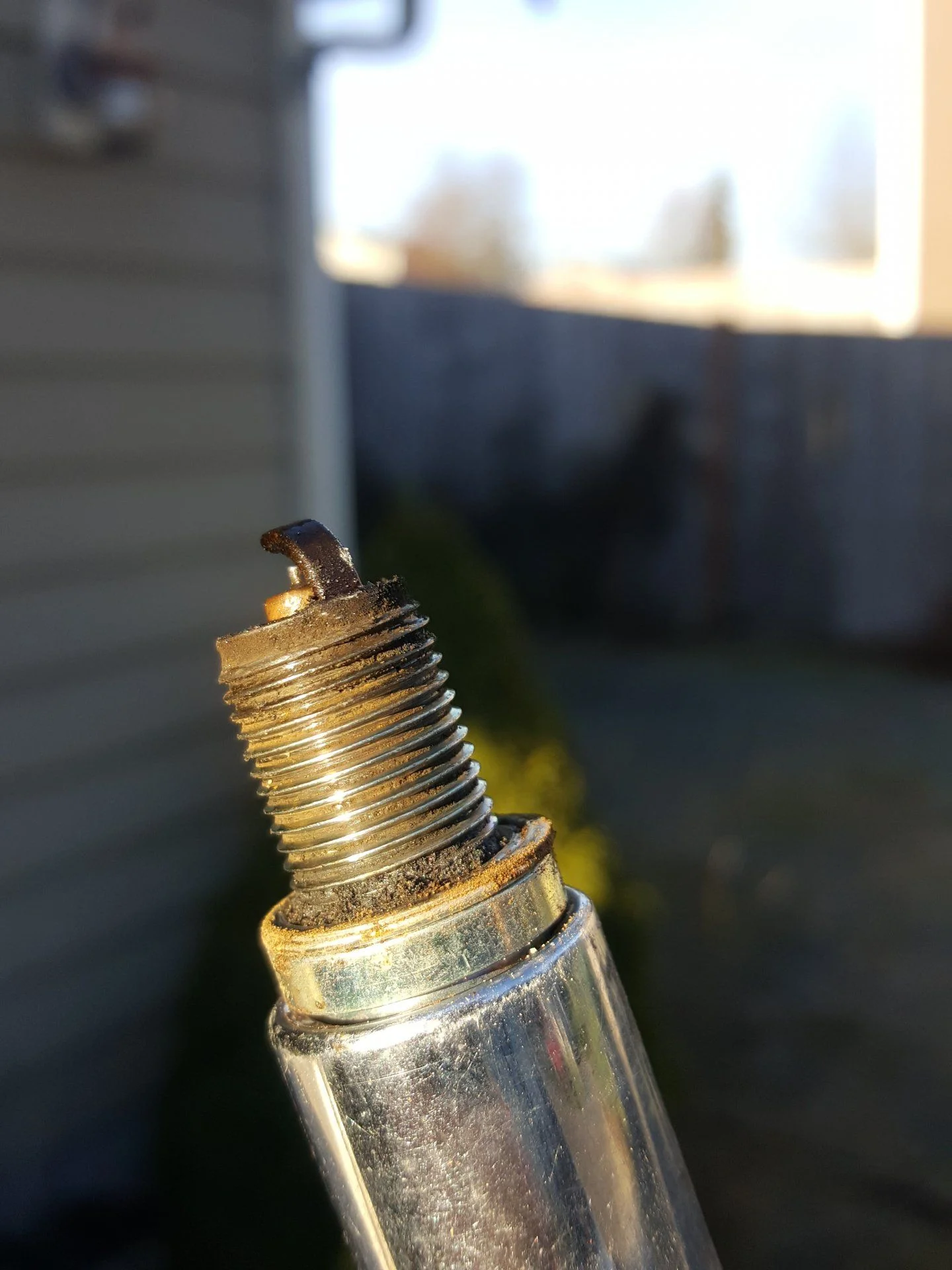

Top plug is #6. Can't tell if it's greasey fuel/oil or coolant. 6 cyclinder is not like the rest.
If possible, show us a pic of all in order 1-6 on the electrode end with open side visible.
White = Lean
Dark wet = oil foul
Light wet = fuel foul
black = rich fuel
light brown = correct
Looks new (steam cleaned) = coolant leak

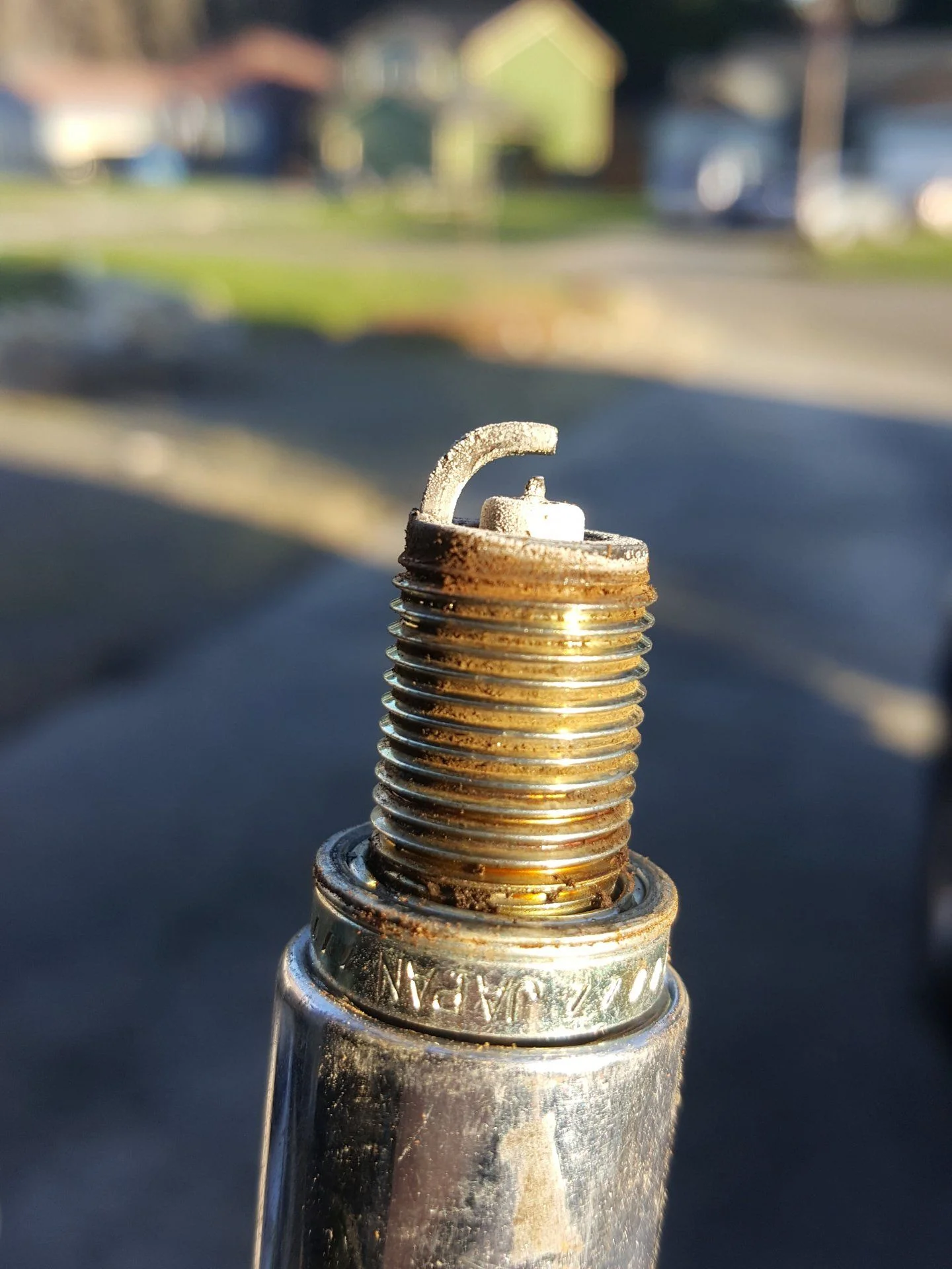

all look pretty much like the second picture #6 is the smaller something gunked up spark plug. i put them all back in, but i have new plugs ordered/ waiting at auto part store #6 cylinder ( very back/aft ) is scummy plug

Plugs though different in appearance don’t look bad to me, maybe a little lean/hot in the second photo but the #6 doesn’t scream HG failure to me although I don’t know why it’s darker (can’t tell if that’s oil on it).
#6 looks a little suspect the rest don't look too bad. The 'white-ish' deposit (if like ash) suggests a lean condition BUT if it more like sand/gritty, then you've got oil getting past your valve guide seals and producing that. That would also explain #6 looking a bit oily.
I don't see anything glaring about any of those.
