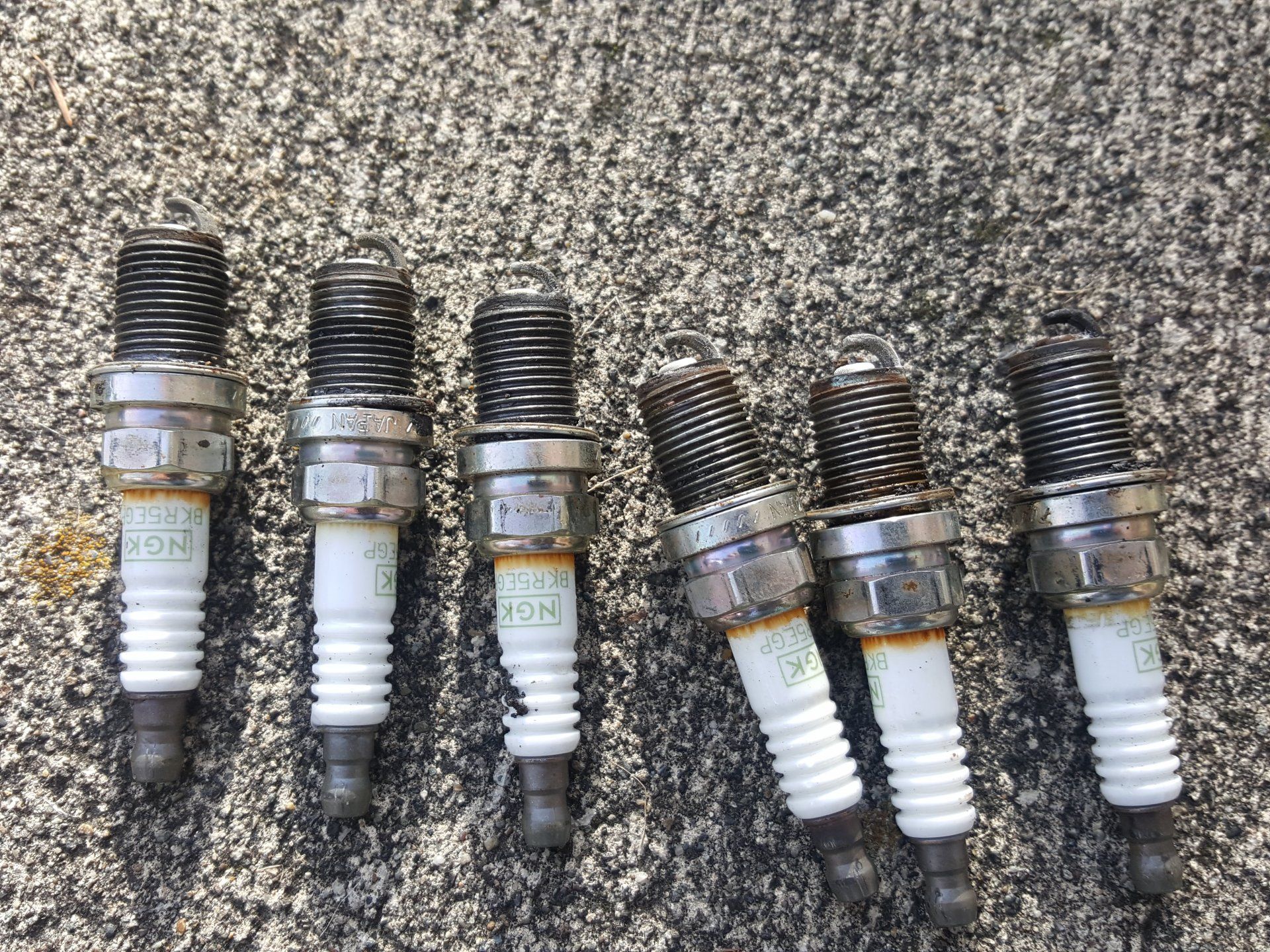

engine almost over heat error code says.....
View attachment 2534177d
1,2,3,4,5,6 Left to right
Looks like it might be running a bit lean overall.
#6 injector may be hanging open, causing too much fuel in the exhaust, so the O2 sensors are telling the computer to lean out, so the rest are starving for fuel, and #6 is fouling.
I do not see evidence of HG fail on these plugs.
