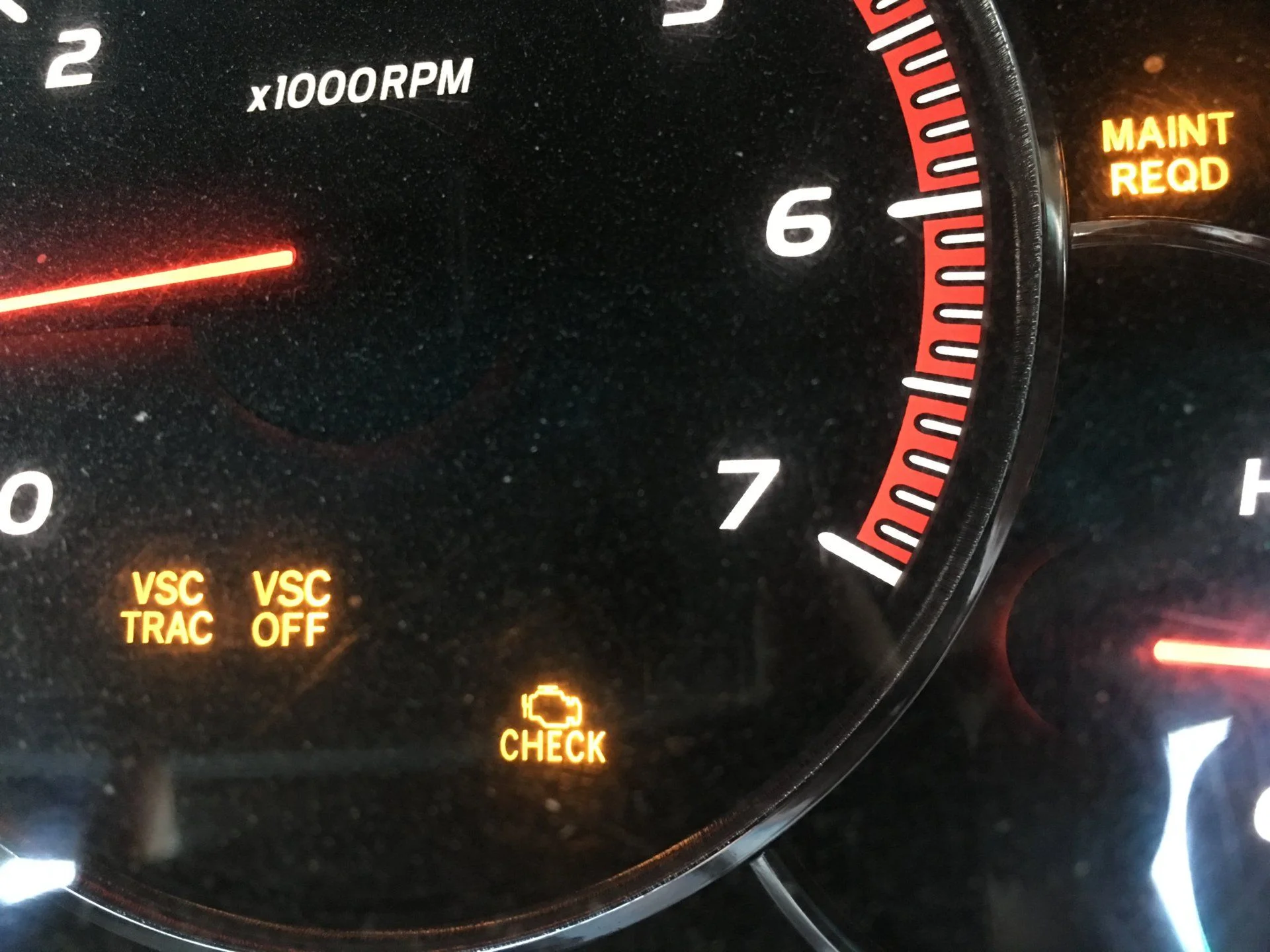

My CEL and the VSC Trac lights have been coming on. When I pull the codes, I get P0171 and P0174. I clear them and they come on anywhere between 20 miles and 500 miles.

I thought when they all come on together it was a loose or bad gas cap?
The three VSC/TRAC lights will always come on with the CEL, regardless of the cause.
Yup all 3 come one when a code is thrown...any code. The maintenance required light is a bonus in this picture. It wants new oil but not time yet
Get a new gas cap - inexpensive if that's not the remedy but same scenario for me and that's what it turned out to be over a year ago.
