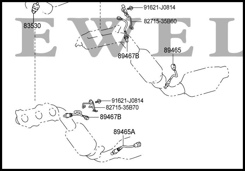

I've read a few threads on this, but not sure if these two downstream O2 sensors will work.
Amazon lists a different model for right vs left, but I've read on here that they are the same. Anyone know if Amazon is right or wrong?
Denso 234-4260 Oxygen Sensor -- Downstream Right
Denso 234-4261 Oxygen Sensor -- Downstream Left
The diagram that I found has a different part number than the Denso part number.
Any help would be appreciated. I'm getting ready to replace both downstream O2 sensors.

Got it. They are the same except one o2 sensor has a slightly shorter wire harness.
