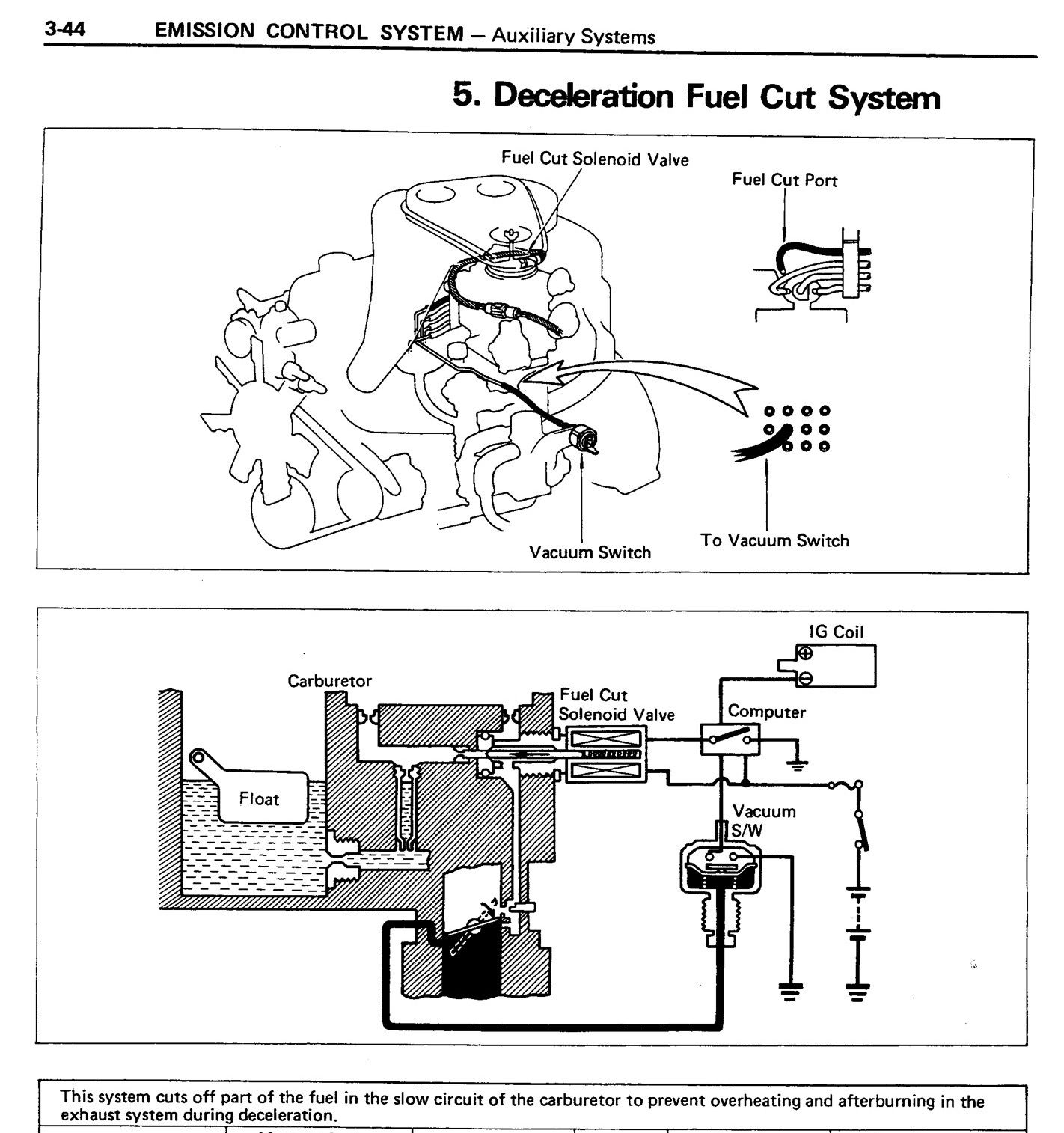

Before we jump to conclusions, you have "green wire mod" in quotes. So I assume you grounded the white wire, correct?
So the green wire mod eliminates the need for the vacuum switch altogether, correct?
The ICS wire 'mod' grounds the circuit so that whenever the ignition key is turned on, the ICS is energized - allowing fuel to flow to both idle circuits. When the 'mod' is done, the vacuum switch serves no purpose.
Grounding the ICS wire should be only done if the emissions computer is malfunctioning (or missing) or the vacuum switch is dead and you don't want to replace them with used units.
Grounding the ICS wire makes the ICS always stay energized so fuel will always flow through both idle circuits in the carb. This is how the fuel normally flows when your foot is on the gas or the engine is idling.
But the 'mod' is a band-aid for missing or malfunctioning parts. The engine will perform better overall if the deceleration fuel cut system is functional.
When functional, the system prevents backfires when decelerating in gear (especially down long hills) or even during a shift, provides better engine braking down hills while in gear,
prevents exhaust grumbling when coasting in gear down hill, helps improve mpg a little bit and prevents dieseling after engine shutdown.
Disconnecting the system (if it works) provides zero benefits and several negatives.

DFCO (Deceleration Fuel Cut Off) is a good thing to have for slight improvement in fuel economy, but without it, and a properly tuned/desmogged/running 2F you'll just get the stink eye from tree huggers and Pious Prius drivers. Possible to get backfire if exhaust is too rich. Generally, DFCO didn't come about until CATs were mandated.
When you let off the gas pedal, as in engine braking, you get a momentary spike (no pun) in manifold vacuum as throttle valve closes. This vacuum spike draws extra fuel through the idle circuit. You can see this clearly if you have an Air/Fuel meter as it goes way rich when you engine brake, even with the ICS functioning properly. The decel switch tries to close off that circuit under those conditions.
Obviously, it's all computer controlled on modern FI vehicles.

This is the official word from the FSM for the rare soul (none of the members above obviously) who haven't taken a peek at the emissions FSM.
