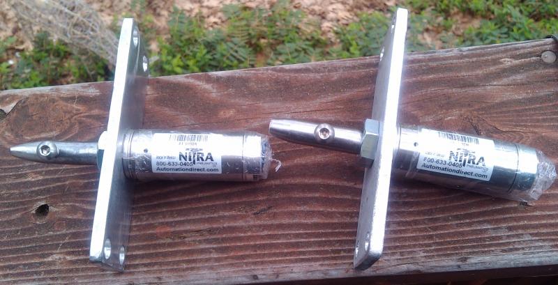

I have a machine shop making 4 shafts but they are backed up and it will be 3 weeks. That will give me time to make some better looking aluminum plates (than the one in the picture above). I am using 1- 1/16 bore cylinder with a 5/16 rod (the one in the picture above is a 3/4 inch cylinder with a 1/4 inch rod). The cylinder return spring is 6 lbs. compressed. I will mount each one on our rear axle and test them, then sell them for $125.00. I think small box USMail is about $7.00. The air valve and fittings can be ordered online. I will post pictures of finished units in 3 weeks. L.B.

I like the low cost and simplicity of the air cylinder. The lack of electricity, unit being stainless and aluminum, and much smaller and lighter seem to be worth the trouble. If the cylinder gets damaged, You could have a trail spare for $25.00 and swap out in minutes (using the same shaft and mounting plate).

I have 2 units tested and ready to go. I will e-mail Iron Hippy. These larger cylinders work well at 35 lbs. pressure. I have a gopro video of me testing them with my shop compressor that I will upload to youtube shortly. L.B.
Obviously, I am no Francis Ford Coppola. Here is the link to the Elockler air/cylinder accuator video. It shows the shift fork slide to the right (locking the diff) when the shop air is applied. Then when I disconnect the air, The shift fork returns to the left.
