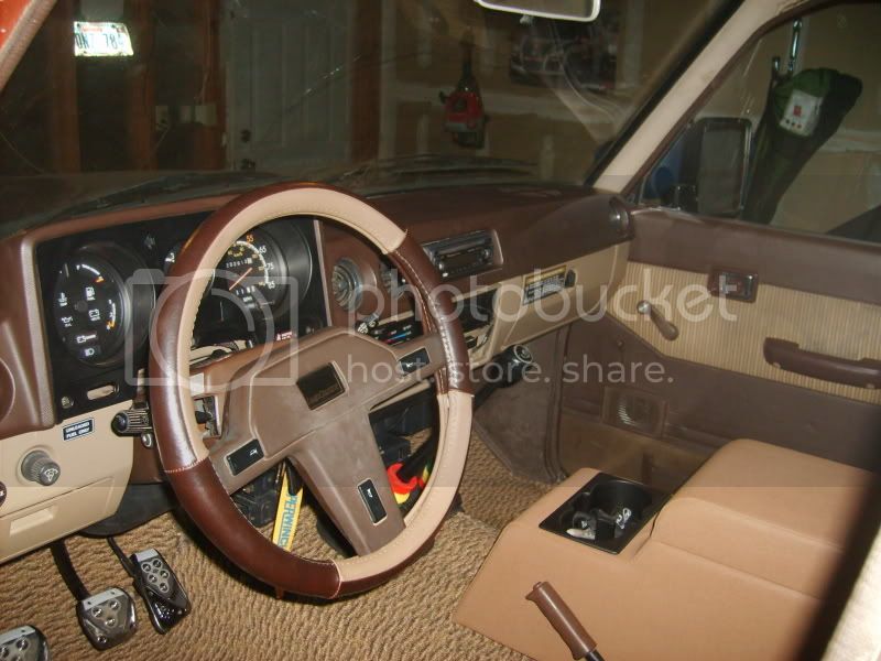

I got the speakers wired up. Pioneer 5.25's, they sound great and have no interference when rolling down the windows. The CD player is also a pioneer and even has an ipod adapter. I went ahead and put the original door panels back on, which I really didn't want to do before I reupholstered them, but they cleaned up decently (but not on par with the rest of the interior).

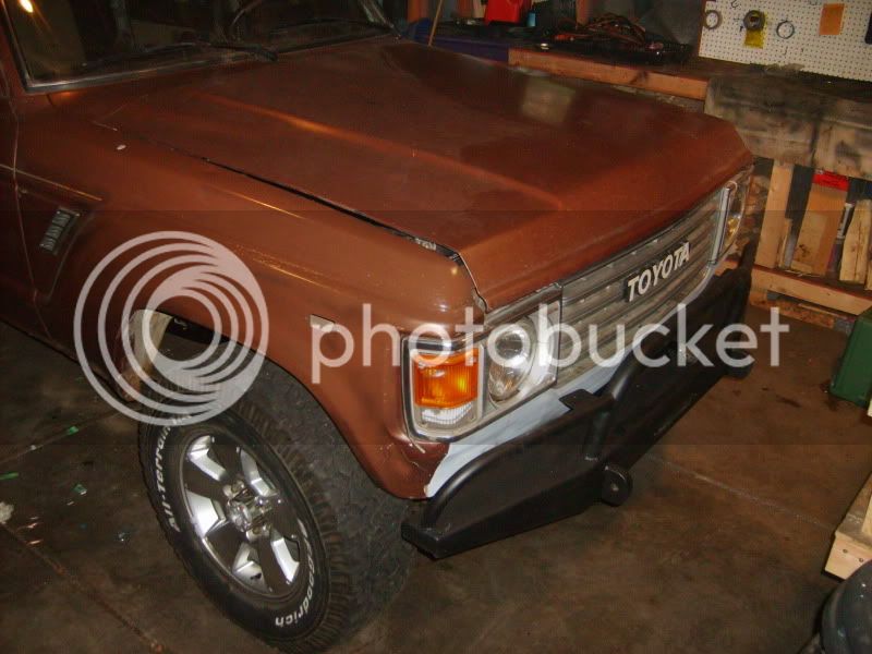

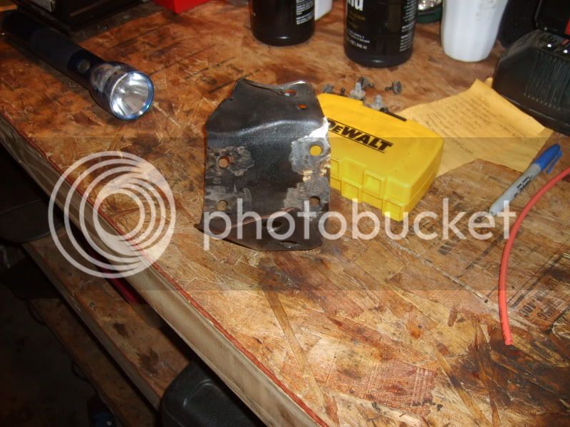

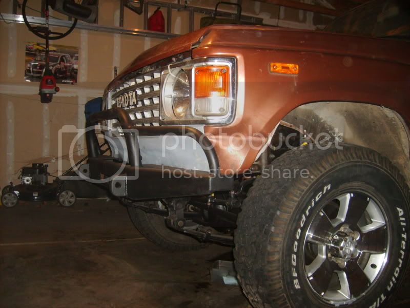

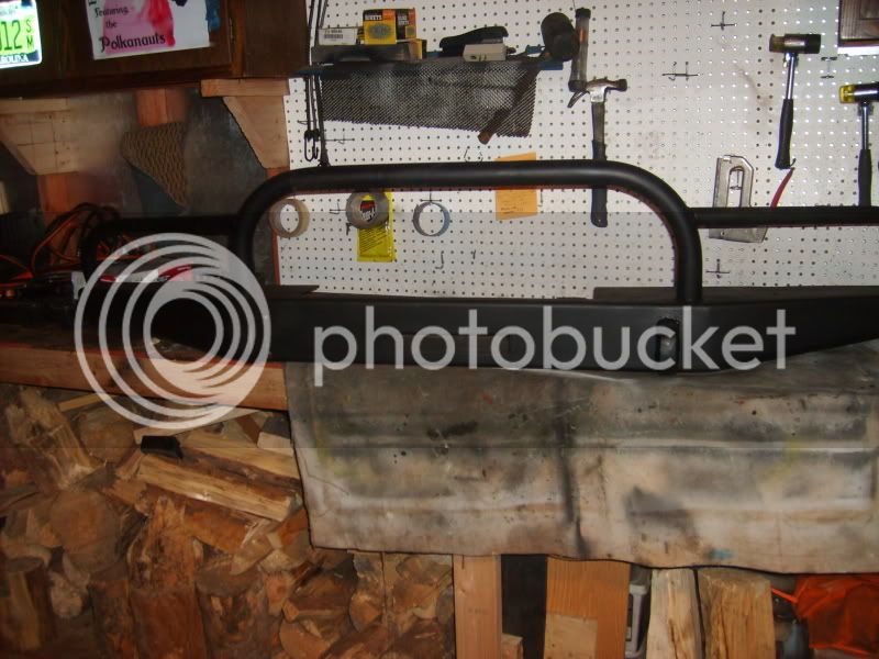

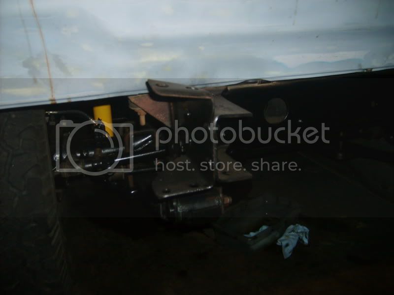

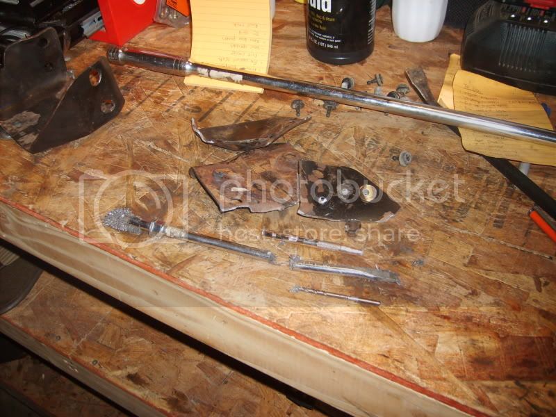

I also spent some time installing the new winch bumper. It's super sweet, tucks up close to the body and mounts with six Grade 8 bolts on each side! Getting the frame brackets off was a royal PITA with the grinder but with enough swearing and hammering, they eventually saw it my way.
Bracket in question.
It came off fairly easily.
The other side, however, had to be difficult. I had to chop and smack on it endlessly. I'm sure my neighbors love me. You can see the carnage and the tools that were sacrificed to get it off.
But it's all mounted up now.

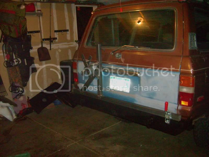

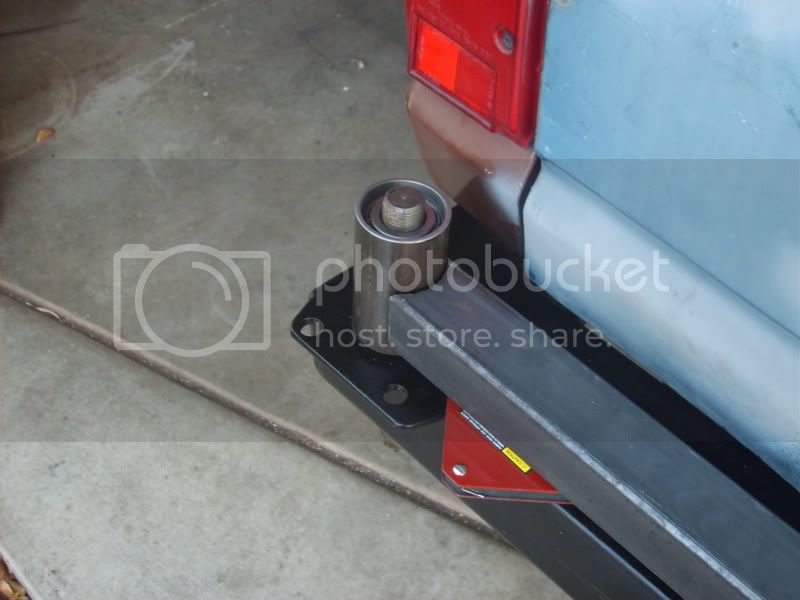

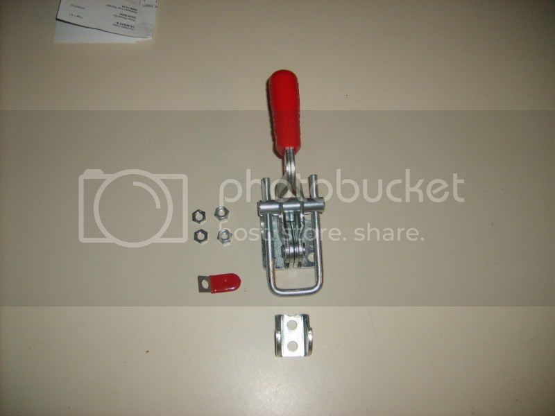

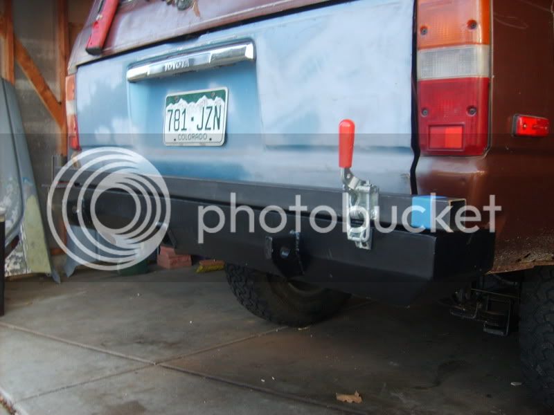

And the latch for my tire carrier came in. 2000lb capacity, so I don't think it's going to fail. I'll probably start burning that thing together tomorrow night after class.

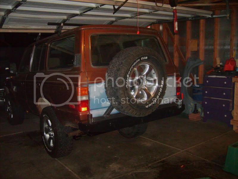

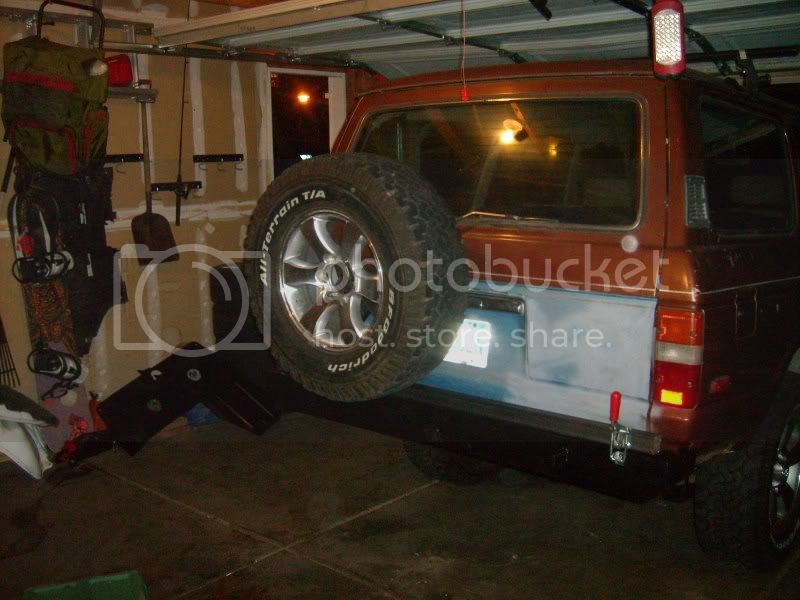

Getting the tire carrier built.

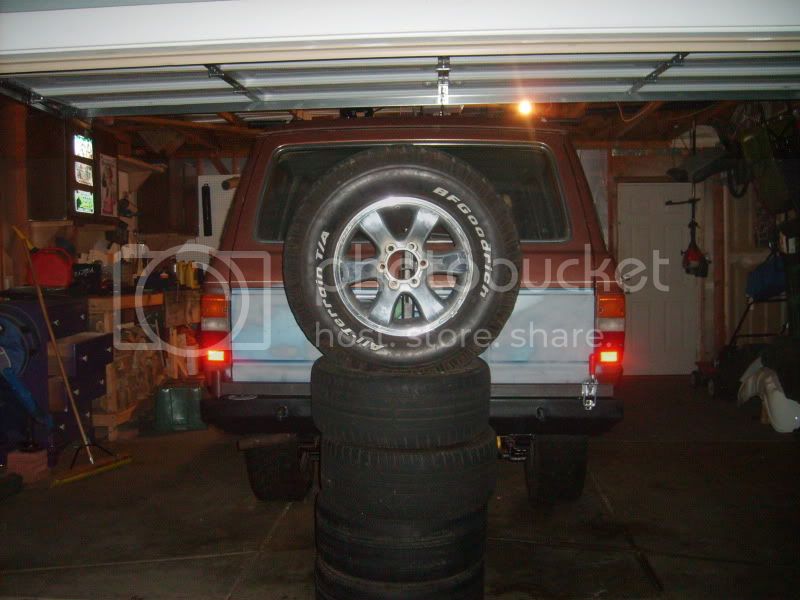

Playing around with where to put the tire. I think it will be more off-center and definitely lower. Having the ability to modify the swingout to carry jerry cans, coolers, build a ladder, etc would be nice.
I'd put it as low as you can put it, and to the left side would leave plenty of room for jerrycan carriers and a ladder.
I like the lower carriers that dont obstruct your rear view as much.

As for the tire carrier, I'm thinking lower and to the left (that's what she said) will work better too. A ladder added on the free space would be really sweet, but I don't have a bender.

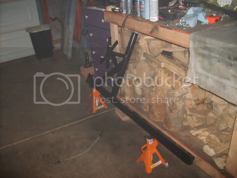

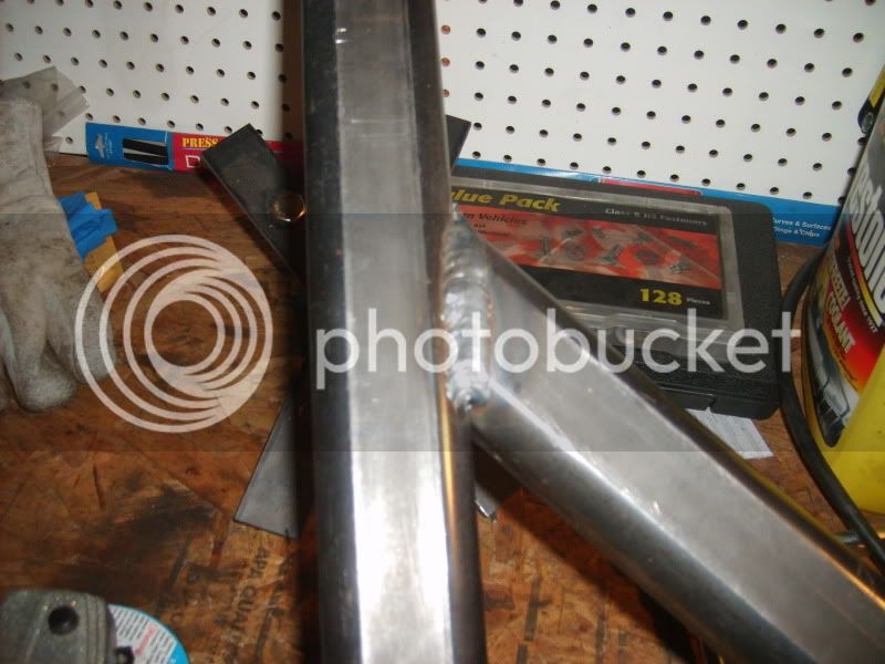

Tire carrier is done. I caught my fleece on fire... again.
Using my redneck sawhorses.
All done.

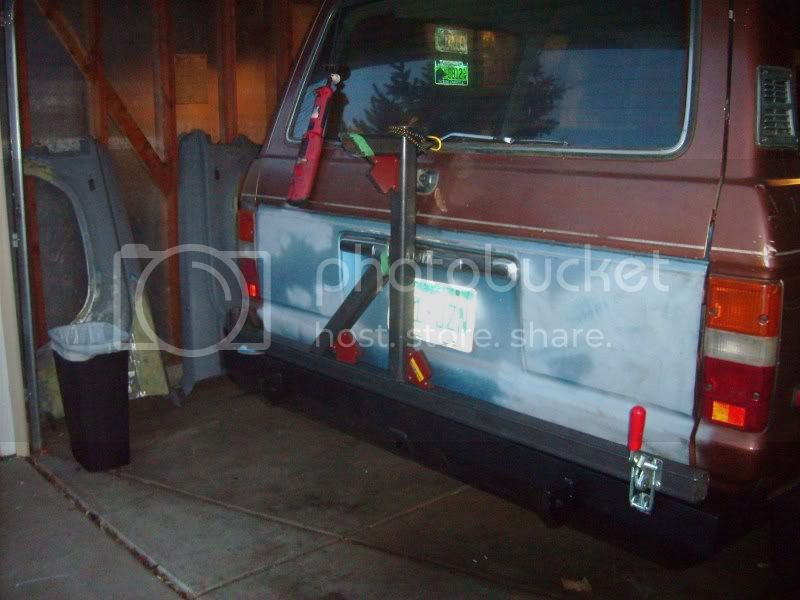

I'm pretty happy with where the tire placement.
Not as good as some of yours guys' welds, but I don't think it's going anywhere.

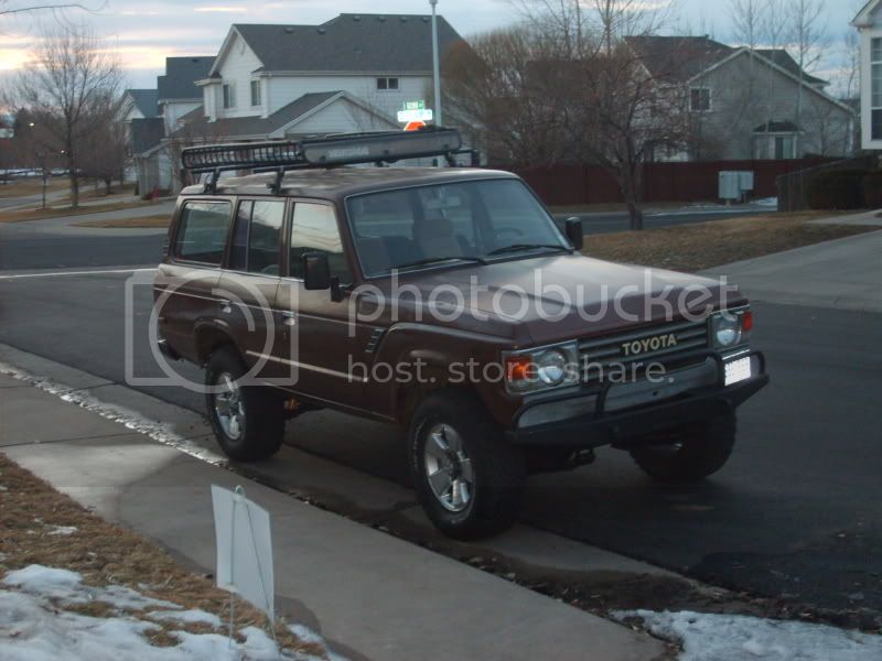

Shot some paint on it and should be ready to mount tomorrow after work! I can smell the end of this build.

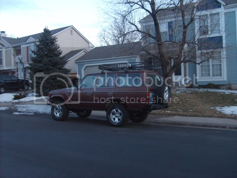

Here is what I will be calling the final product. I'm going to see if I can diagnose the blower motor issue, mount up the fan shroud, and a couple of little odds and ends but this is more or less done!
