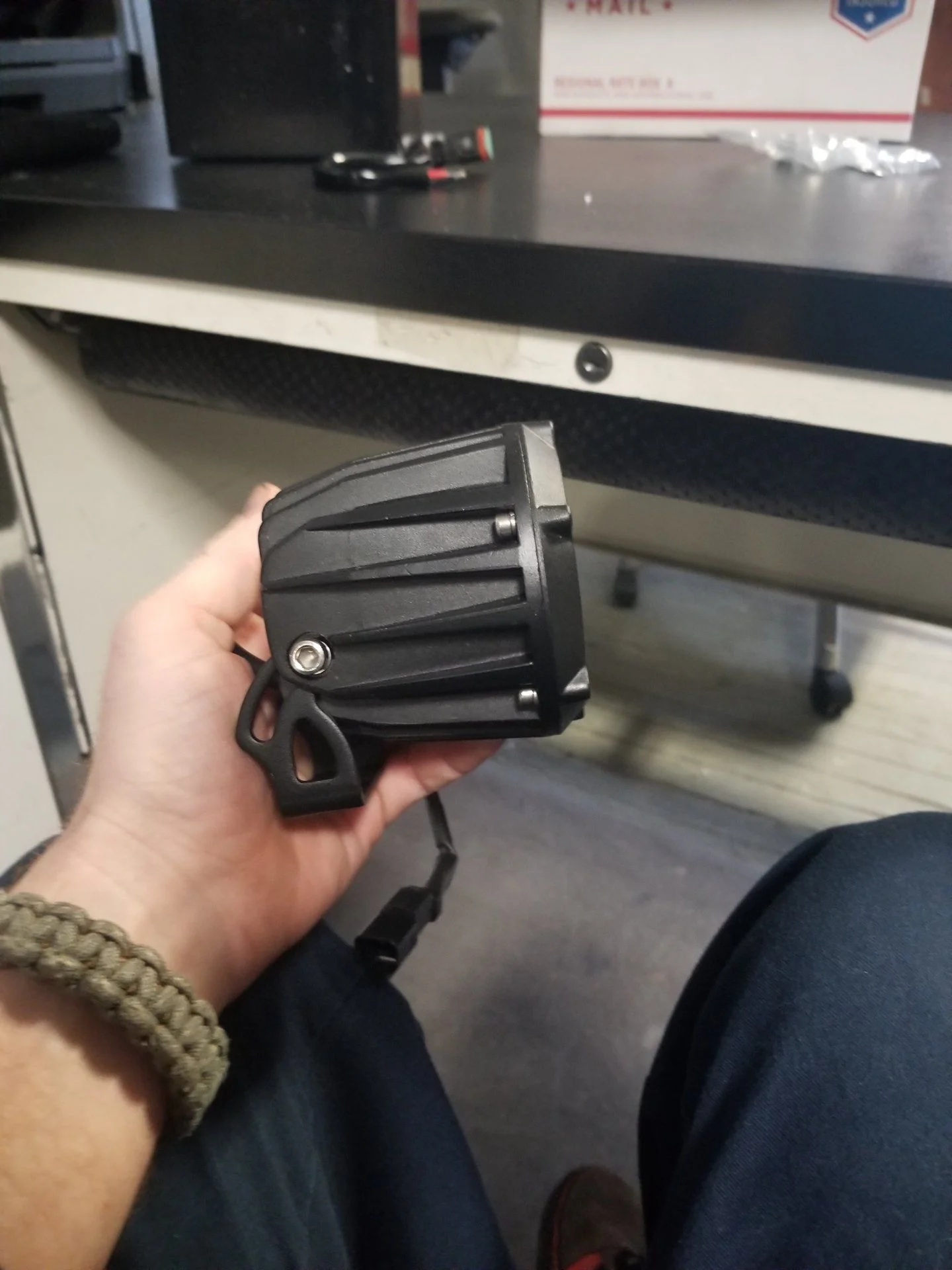

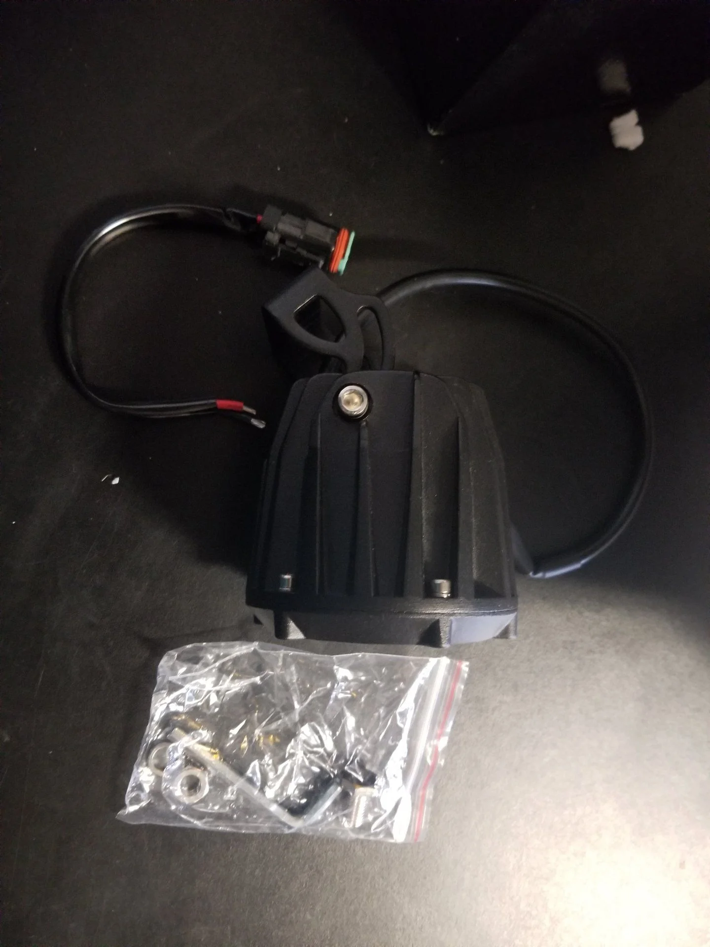

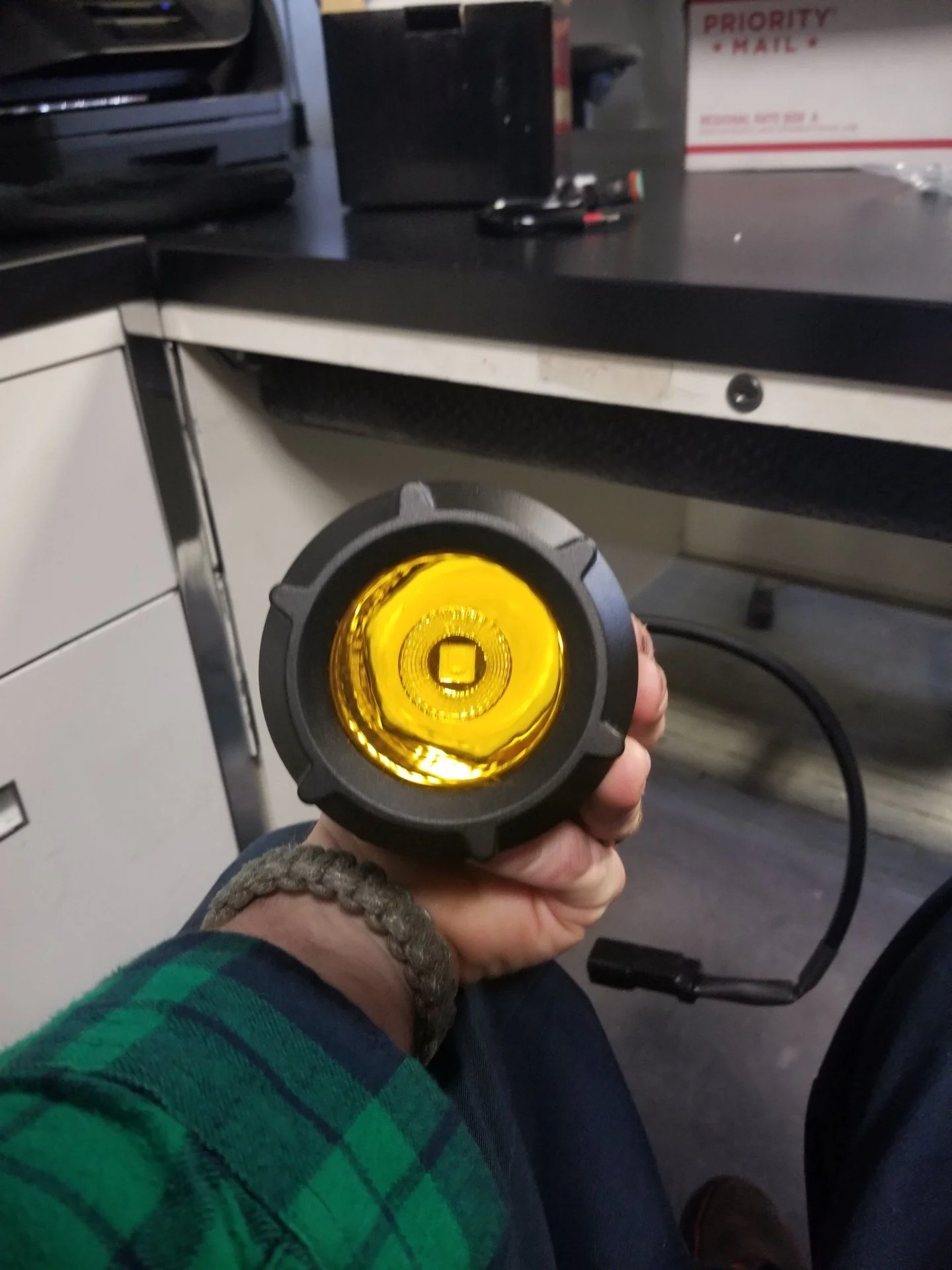

so the lights showed up yesterday, 5 days from order to the door is pretty good. opened them up this afternoon and first impression is that they look pretty good. aluminum housing looks fairly robust, mounting hardware looks solid enough, wiring and connectors are clean and look like they'll seal well. included in the box is the light, pigtail connector to hook up to either your own harness or you can buy theirs, hardware and allen wrench for tightening down the mounting hardware. also included was a business card, sticker, a few pieces of candy and a short hand written note on the receipt. I expect to need to go with different mounting bolts as I have fairly thick mounting tabs on the bumper and I don't think that the supplied bolts will be long enough. ill try to get them installed either tomorrow and will get back with more pics installed as well as the light output.

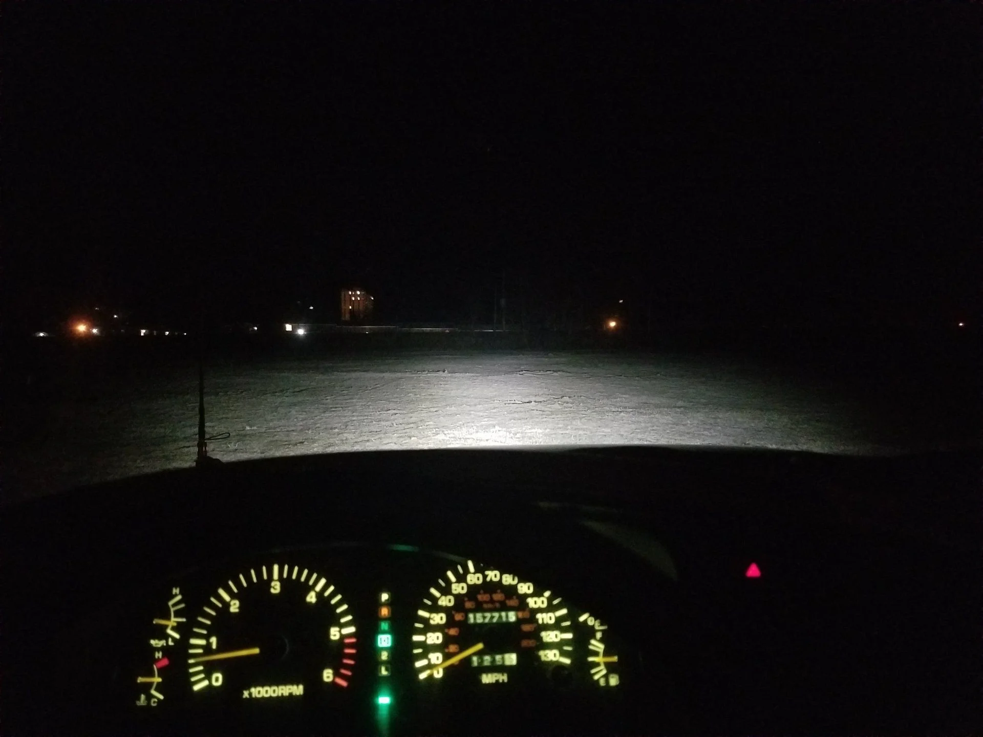

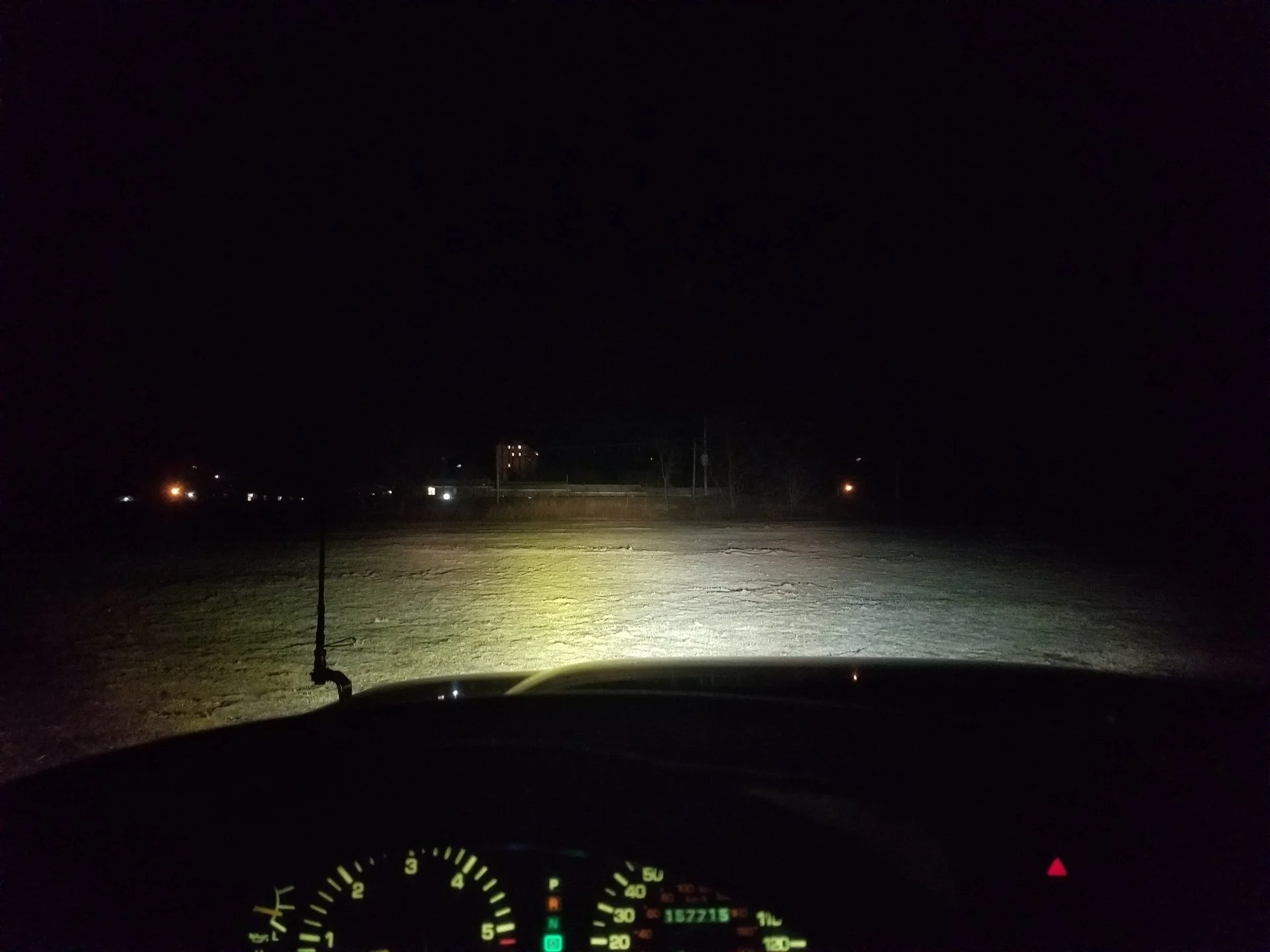

the lights are nice and bright and had a really nice pattern, these are a solid all around driving light. ill have to adjust the lights as I tried to align them on the wall at work but I ended up just aligning both of them to aim at the oncoming lane of traffic :meh:. im going to get them aligned so that they throw a little more light out to the side as my headlights have pretty good reach. I had them on the whole ride home (30 min or so) and checked for any heat on the housing and it was cold to the touch so they should be anble to dissipate heat fairly well. and now some much needed pics
headlights only, I have led headlights installed.

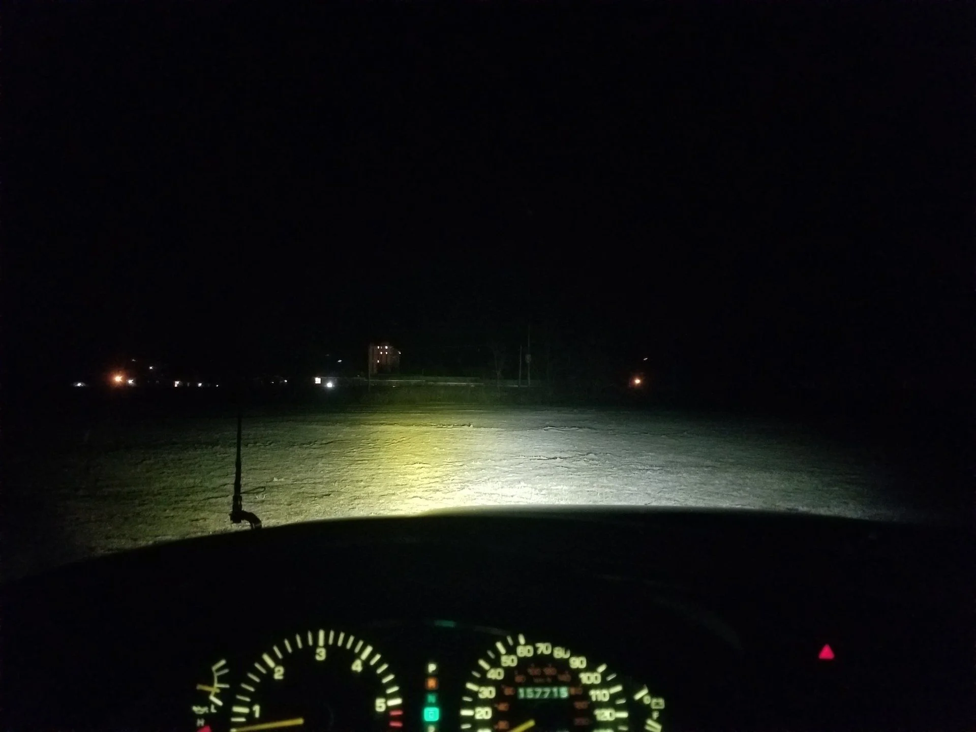

headlights and high beams, high beams are still halogen bulbs.

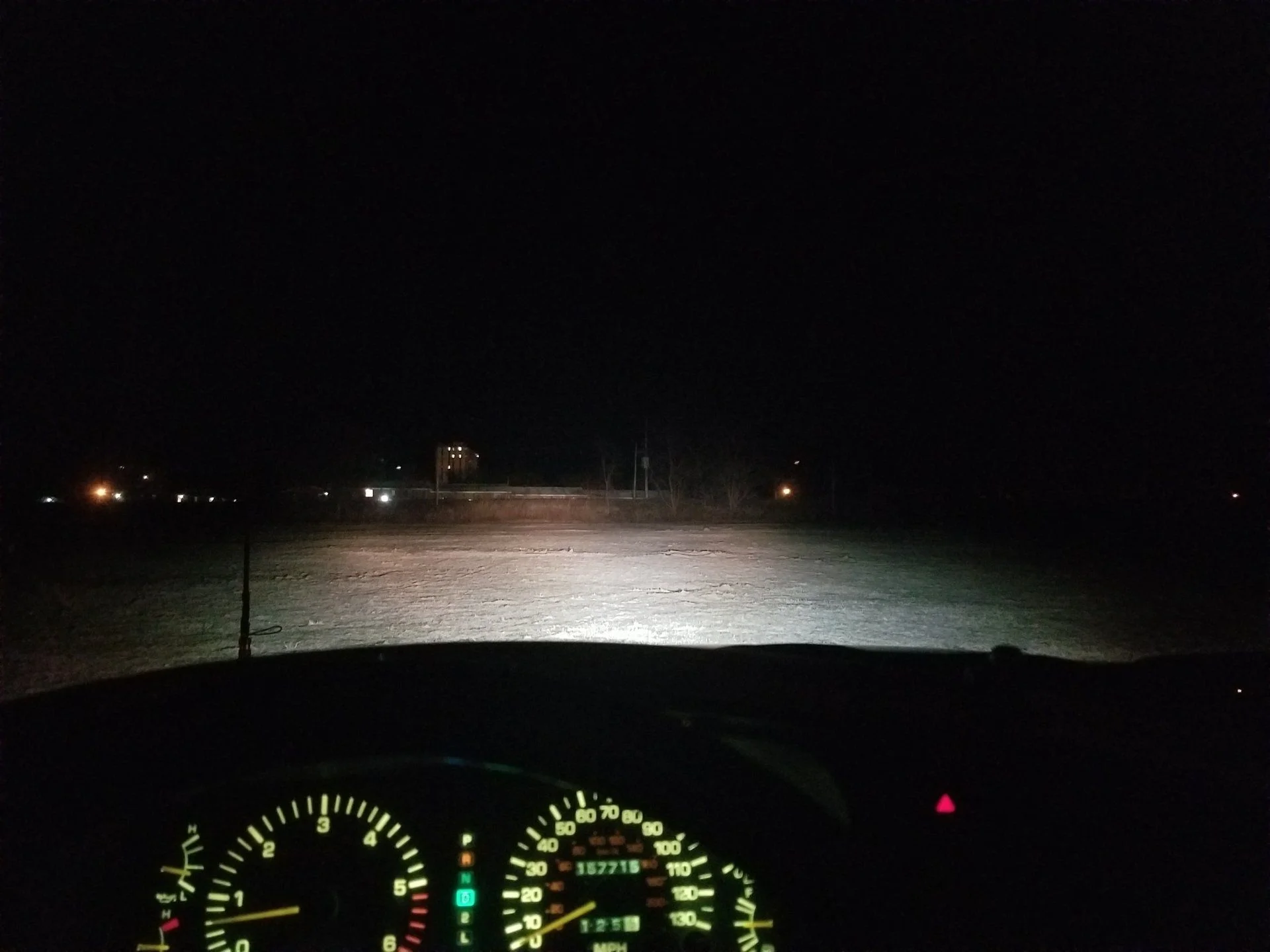

low beams with new lights
1916304
all lights on
1916305
overall im happy with the lights for the price, they seem really well built and hopefully they will hold up and last a long time. they do carry a limited lifetime warrantee but its pretty much on the led and housing, cosmetic damage is not covered and you will need to retain proof of purchase so save that receipt. the supplied hardware is metric thread 8x1.25 and the bolds have a 13mm head to fit the indentations in the brackets to keep the bolts form turning while installing. if you have to g et longer bolts as I did you may need a 12mm wrench to hold the bolt while tightening in nut.
Not bad from the pic. Thanks for the write-up.
