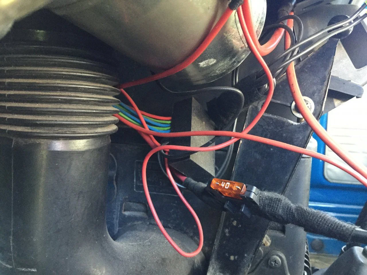

I'm not overly impressed with how the FJ40s are wired. Main supply to the AMP gauge and then on to the fuse box. Not very big wires either. I pulled my power off the starter post where the big cable from the battery connects with a much larger wire. I was able to run the wire through an existing grommet that had an extra un-used passageway and added a 2nd fuse box w/ modern blade fuses. I did this on the passenger side behind the plastic duct where the fan controller and seatbelt buzzer live. Probably being over paranoid but since the assist unit could pull 40 or 50 amps I didn't want the risk. Realistically - I'm only using about 30% of the assist so may have been over-kill.

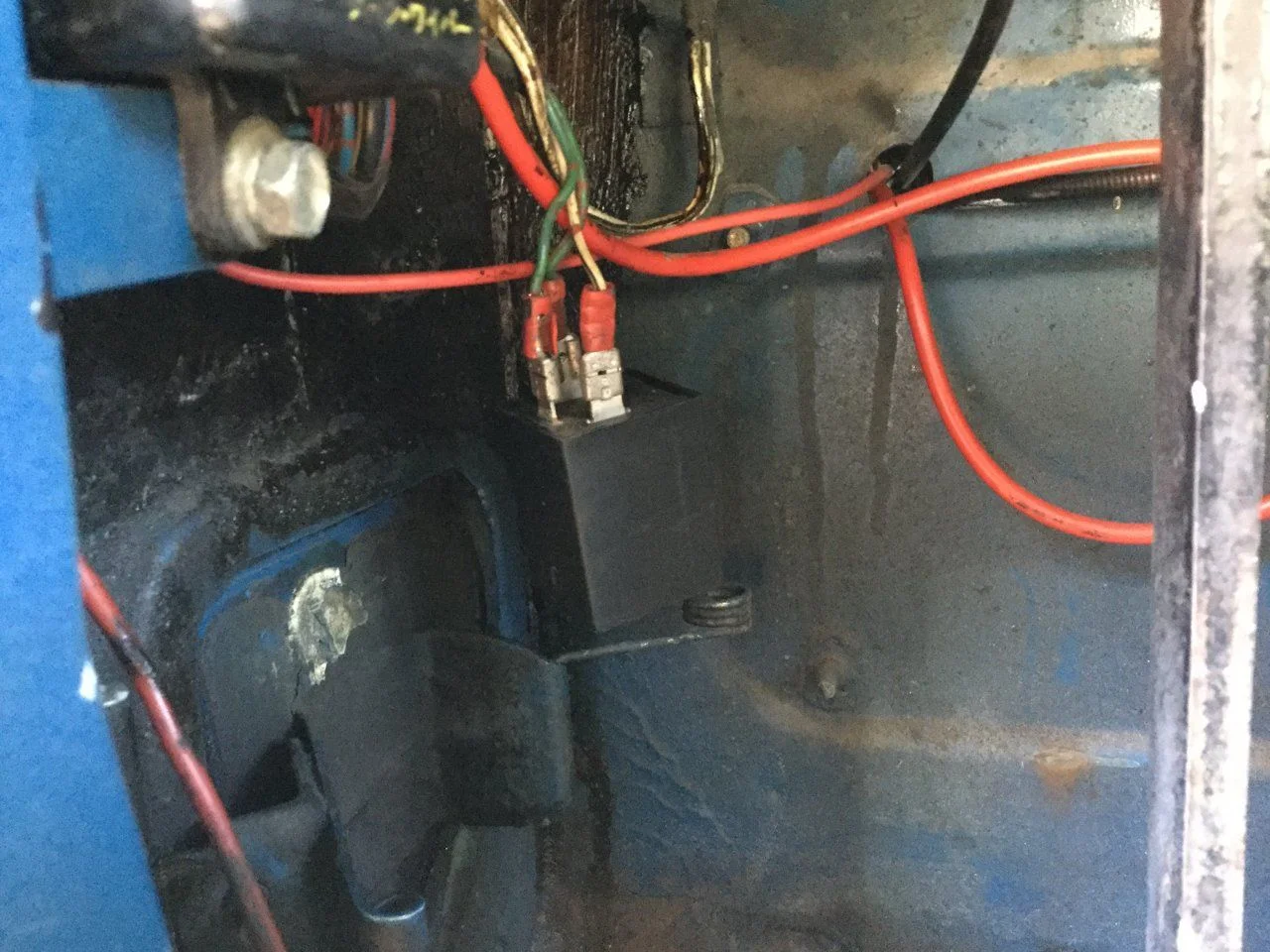

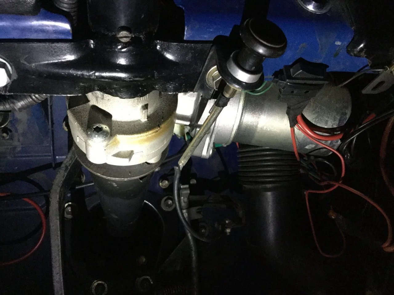

Ok. Here are some final installed shots. As you can see, I think my mounting solution was actually pretty good. Another picture shows the view from the drivers position showing the motor, and how far it sticks out. You can also see in another picture the main wire that comes from the motor up through the pedal assembly avoiding the clutch pedal.

I swore to my better half "this looks just like mine!". Low and behold, it is my cruiser. I went out tonight and verified that sure enough, my BJ45 has what looks like an early version of this electric steering installed. I saw the wiring going from the driver battery to the fuse panel when I picked her up, but initially wrote it off as for the 12v aftermarket stereo. I hadn't had a chance to really look under the dash to figure out what the small switch and dial (potentiometer) were for but you can be damned sure I just went out and checked... Too cool! I don't think it is activated or hooked up so I will grab my DVOM and check things out better in the daylight this weekend.
Here are some pics (sorry for the bad light - night shot). I've no idea when/where/how it was installed but please let me know if you have any comments or questions about it.

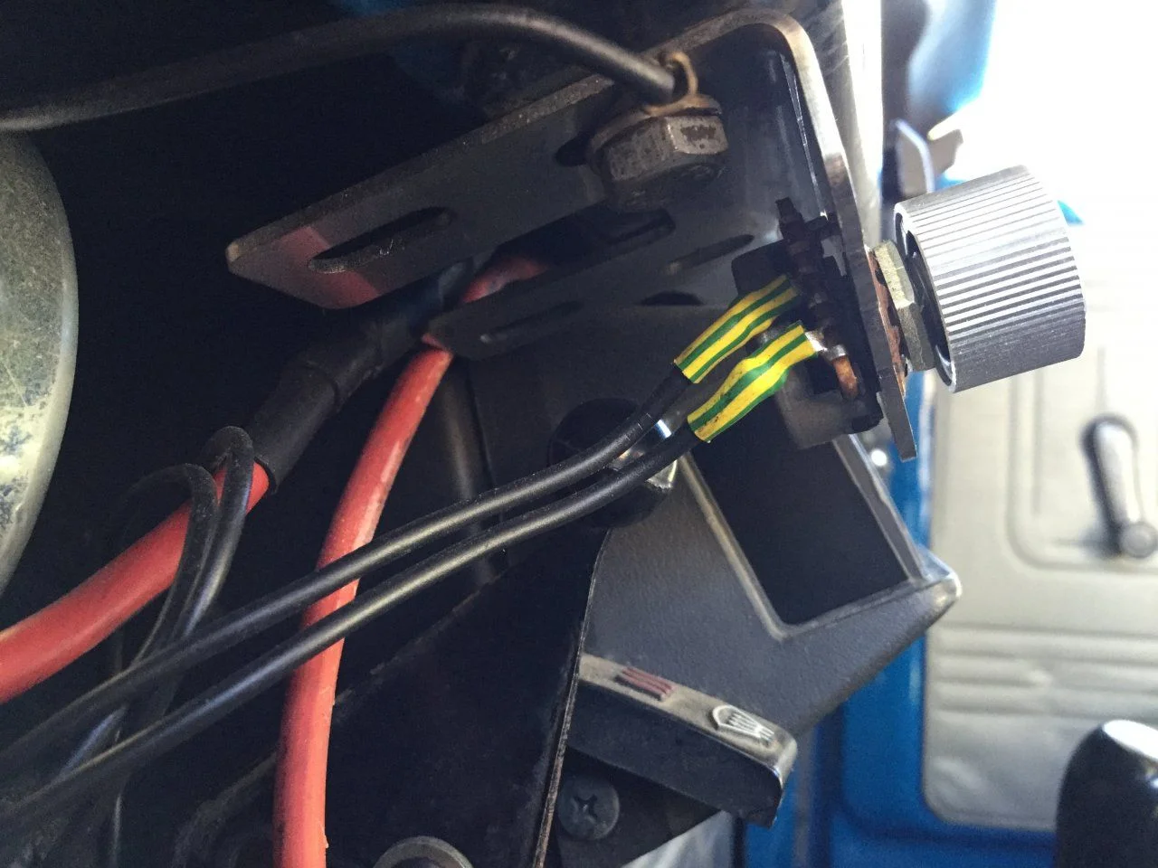

I went through the wiring and found one of the wires going from the motor relay box (control unit?) to the assist adjustment knob was pulled out. Hooked it up and it works great. I can't believe how much of a difference it makes in slow driving conditions - like parking this beast in small Italian spaces

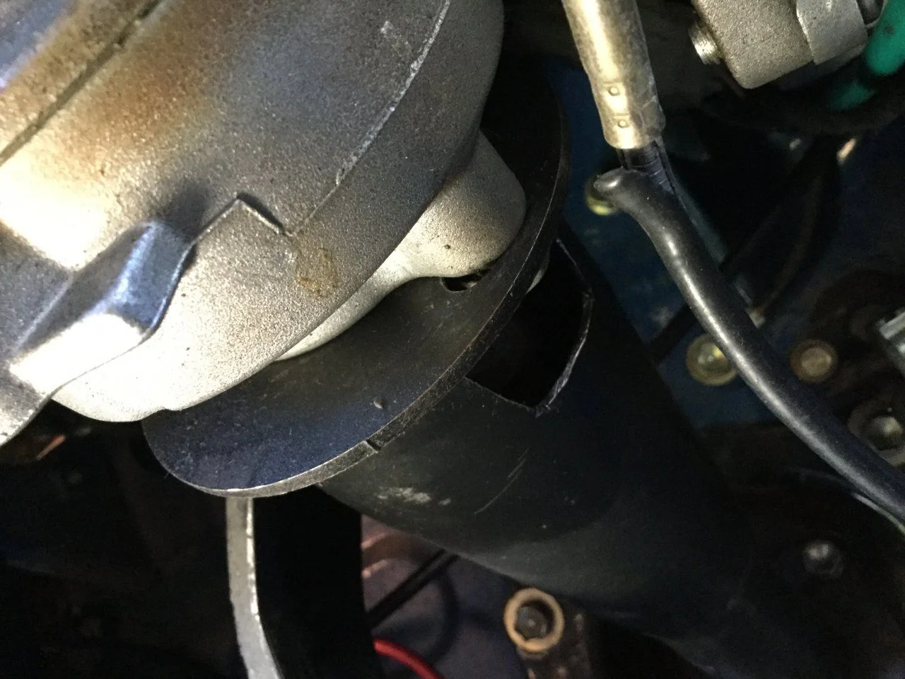

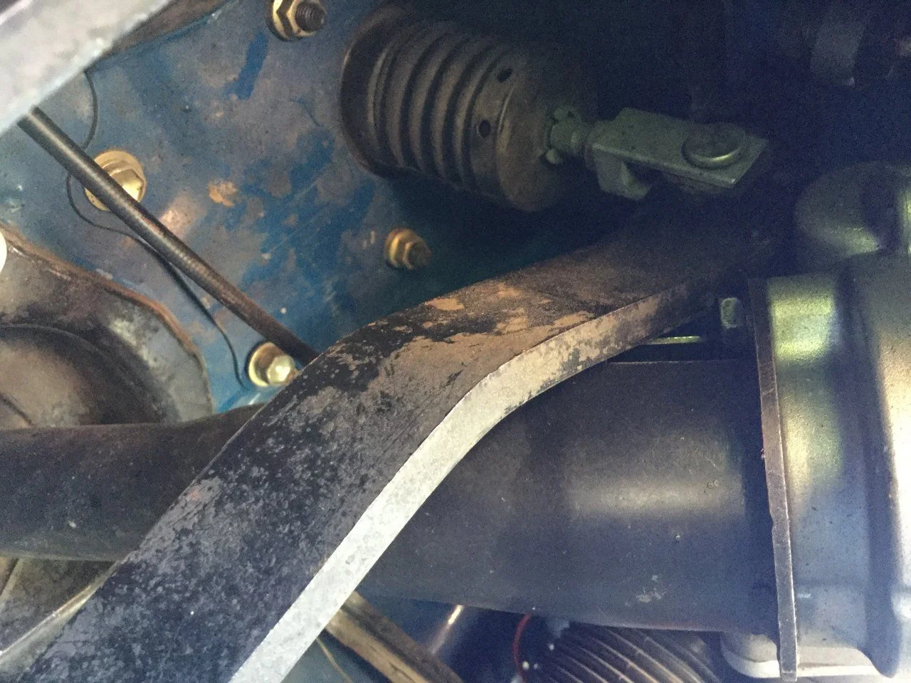

Here are a few more pics; Notice where they apparently notched the lower housing - I'm not sure if this was to clear the clutch lever or to allow better access to the bolts to the upper portion of the steering column ??

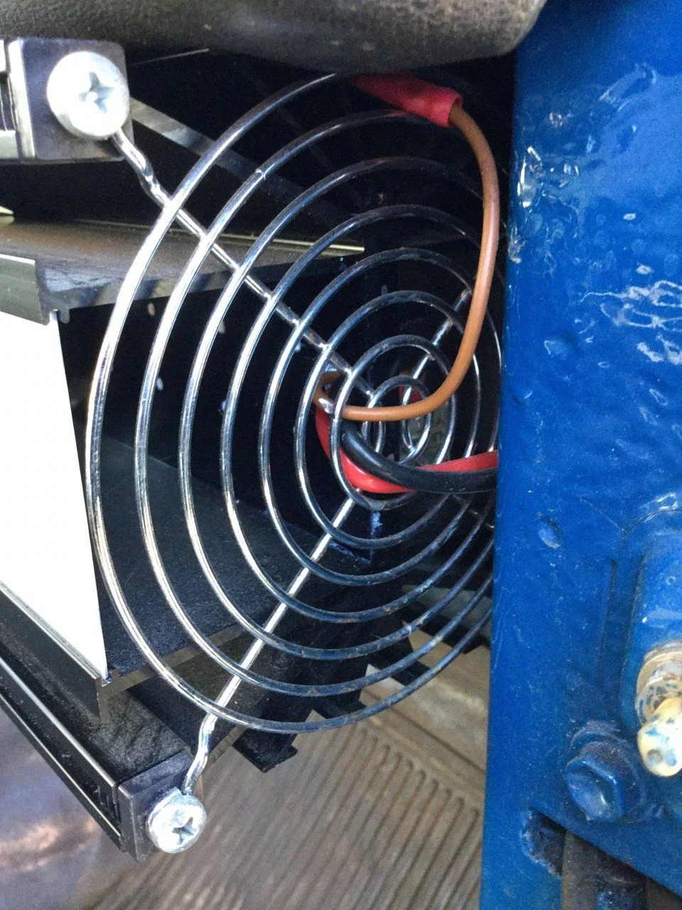

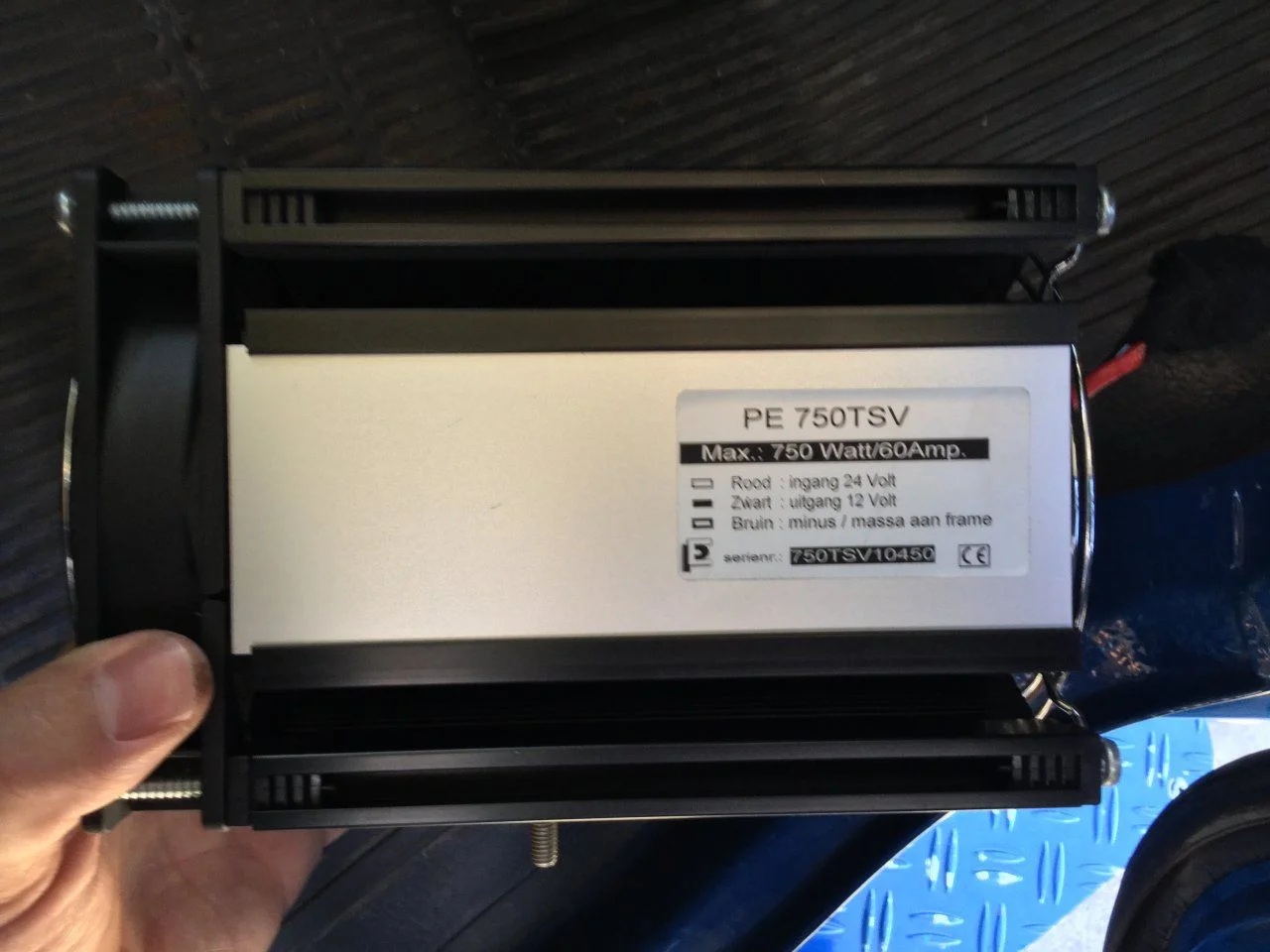

Got the wiring squared. Large wire going from driver battery to the converter (12/24v). Power goes from there to the ESC module, the assist adjustment knob (potentiometer) and then to the steering shaft assist motor. It seems power is also supplies from the converter/step-down to the 12v stereo. I haven't chased the wiring to the hitch (7pin) back yet or read things out with the meter yet but more to follow...
