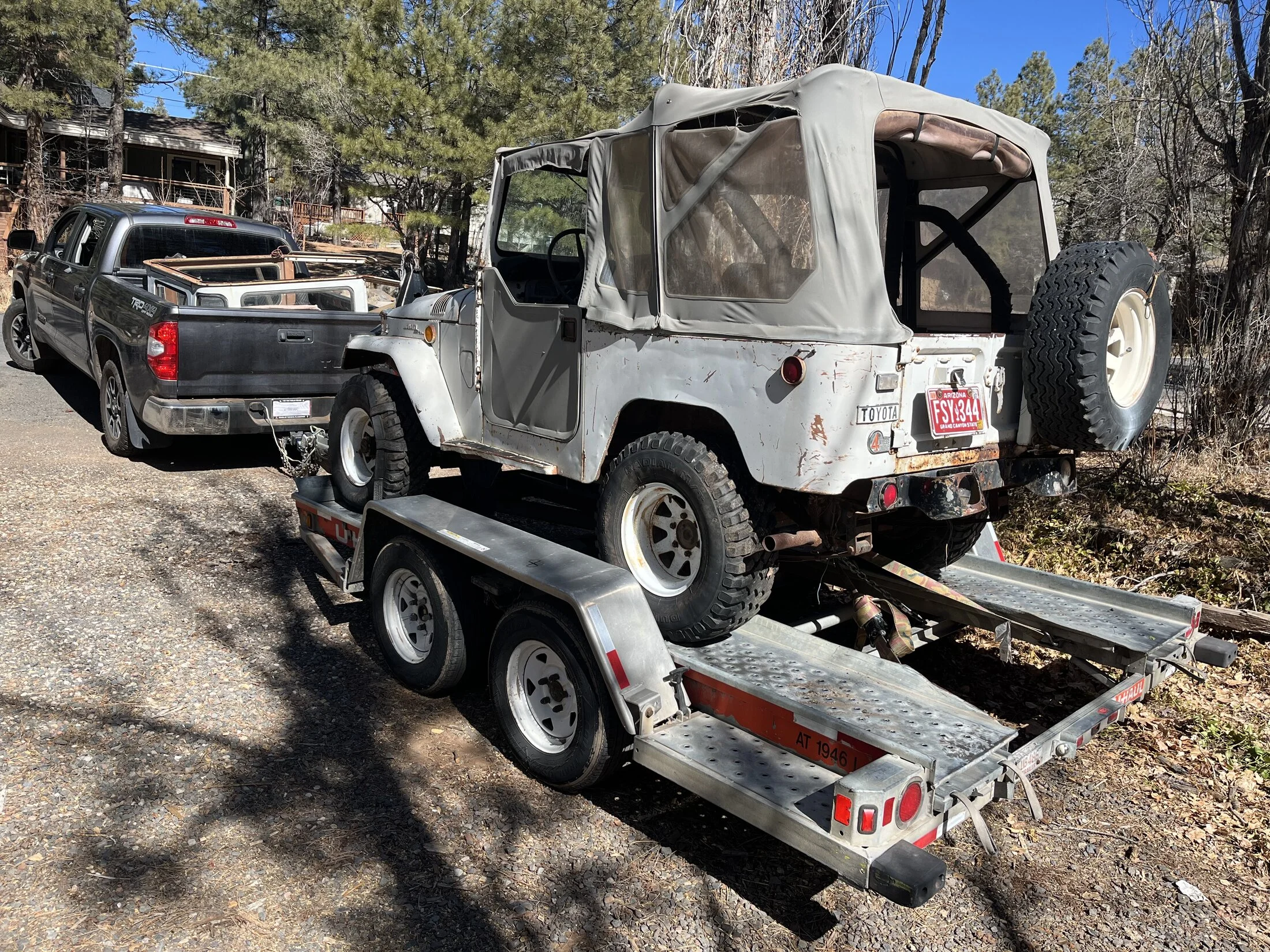

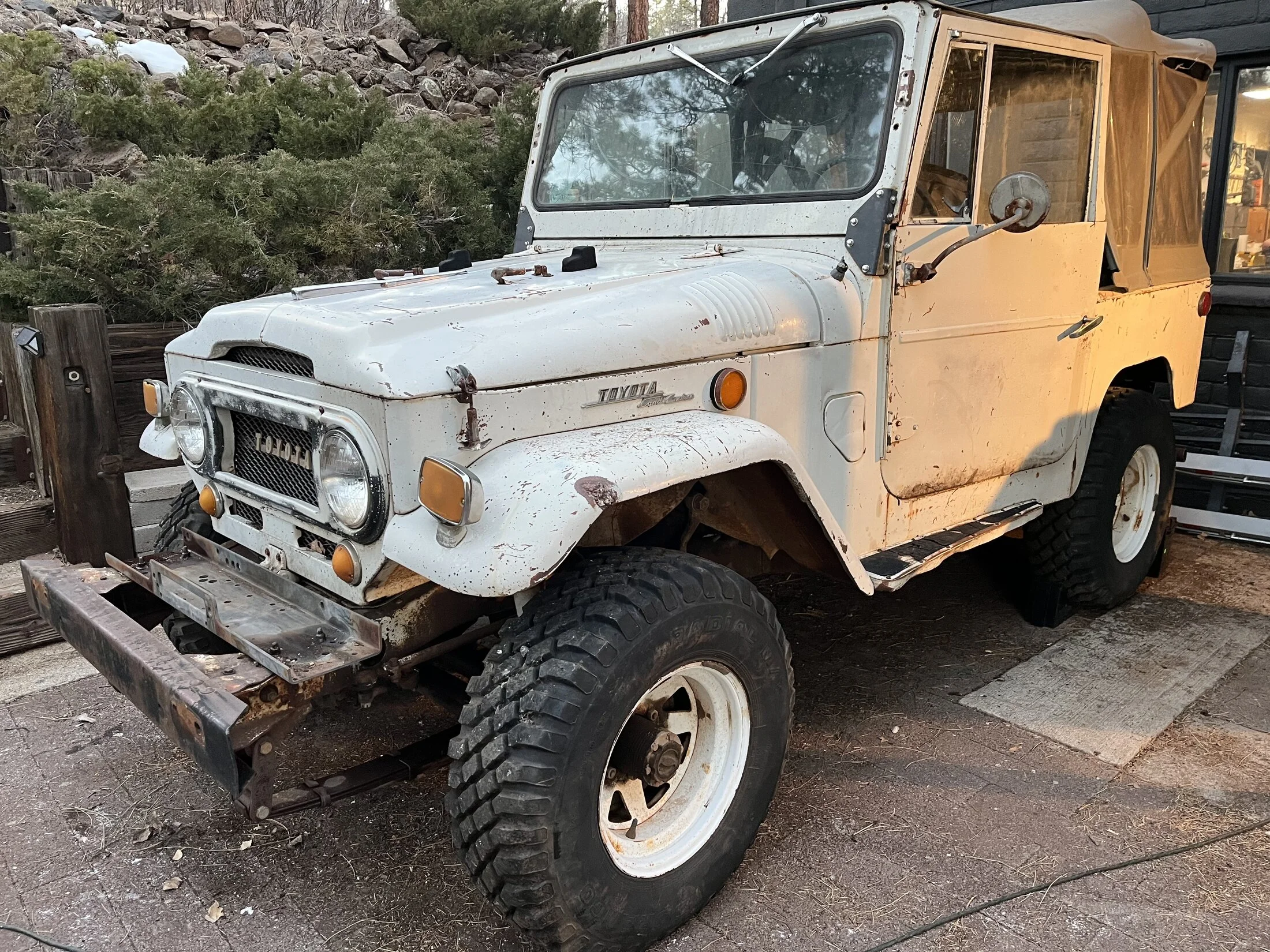

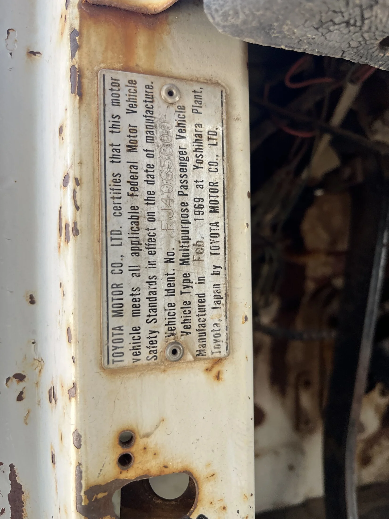

Brought this old girl home today: Feb 1969 build date (edited). Much, much work to be done, but excited for the build/restoration.
Hoping that this foray into the 40 world (I’ve owned several 80s, a 100 and a 150), can be a perfect project over the years with my 11 yo stepson… he wants to drive it by high school😉.

Hey! Since when did a June/ ‘69 build date have anything to do with nursing homes? I’m an April/‘61 build date and no where near being put out to pasture. Damn youngsters. Now get off my lawn!

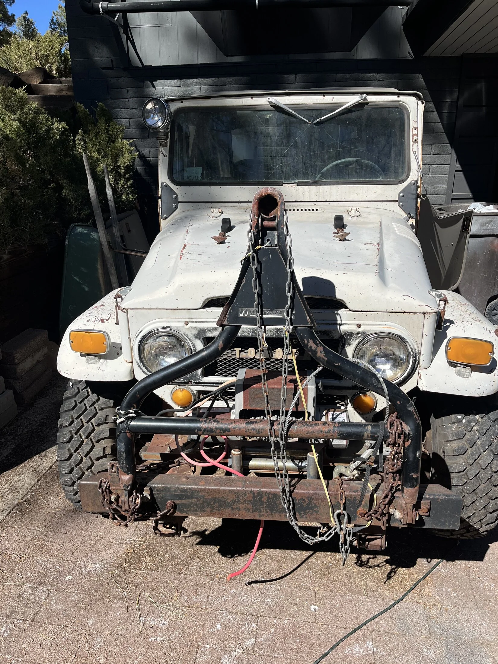

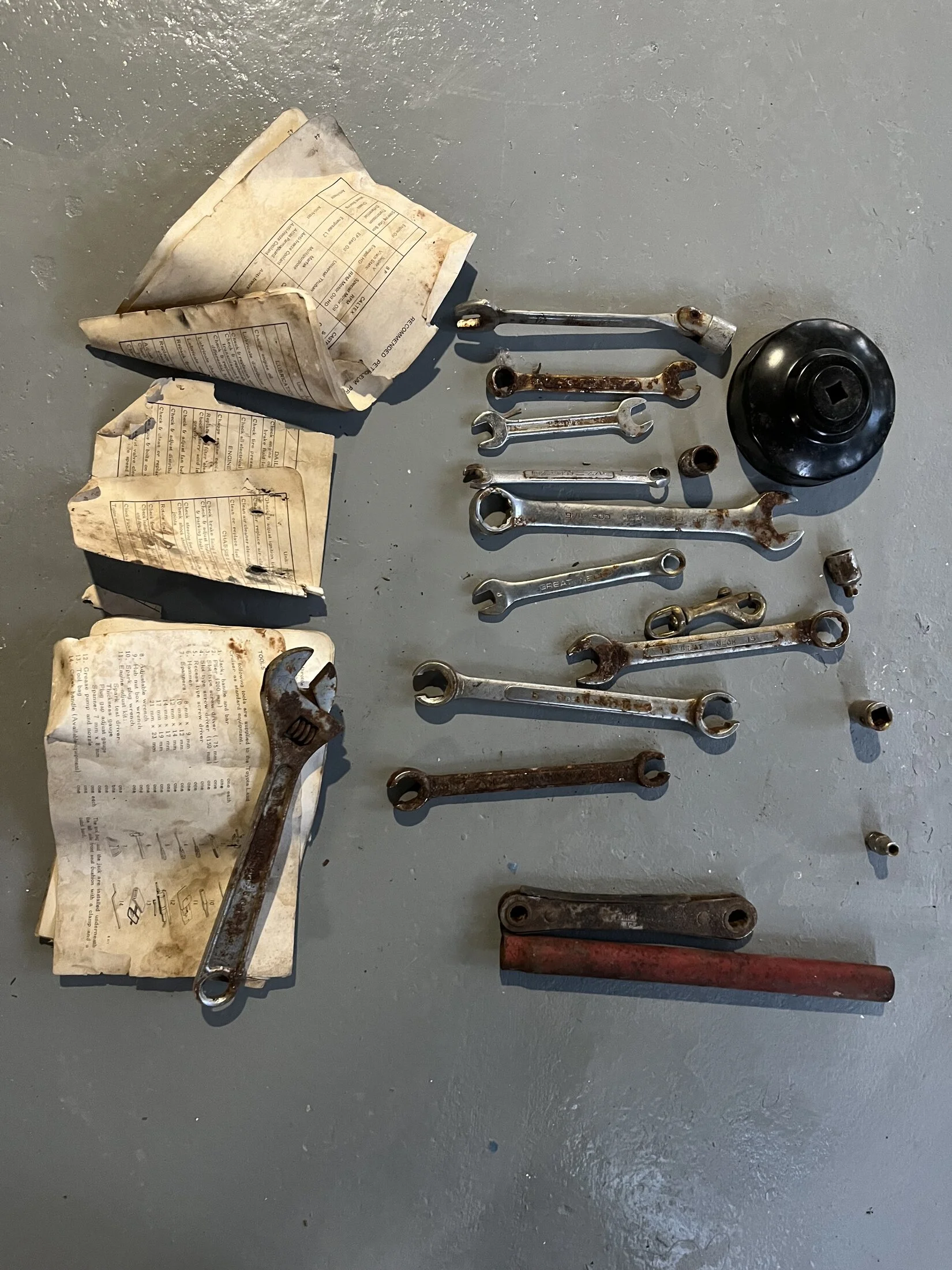

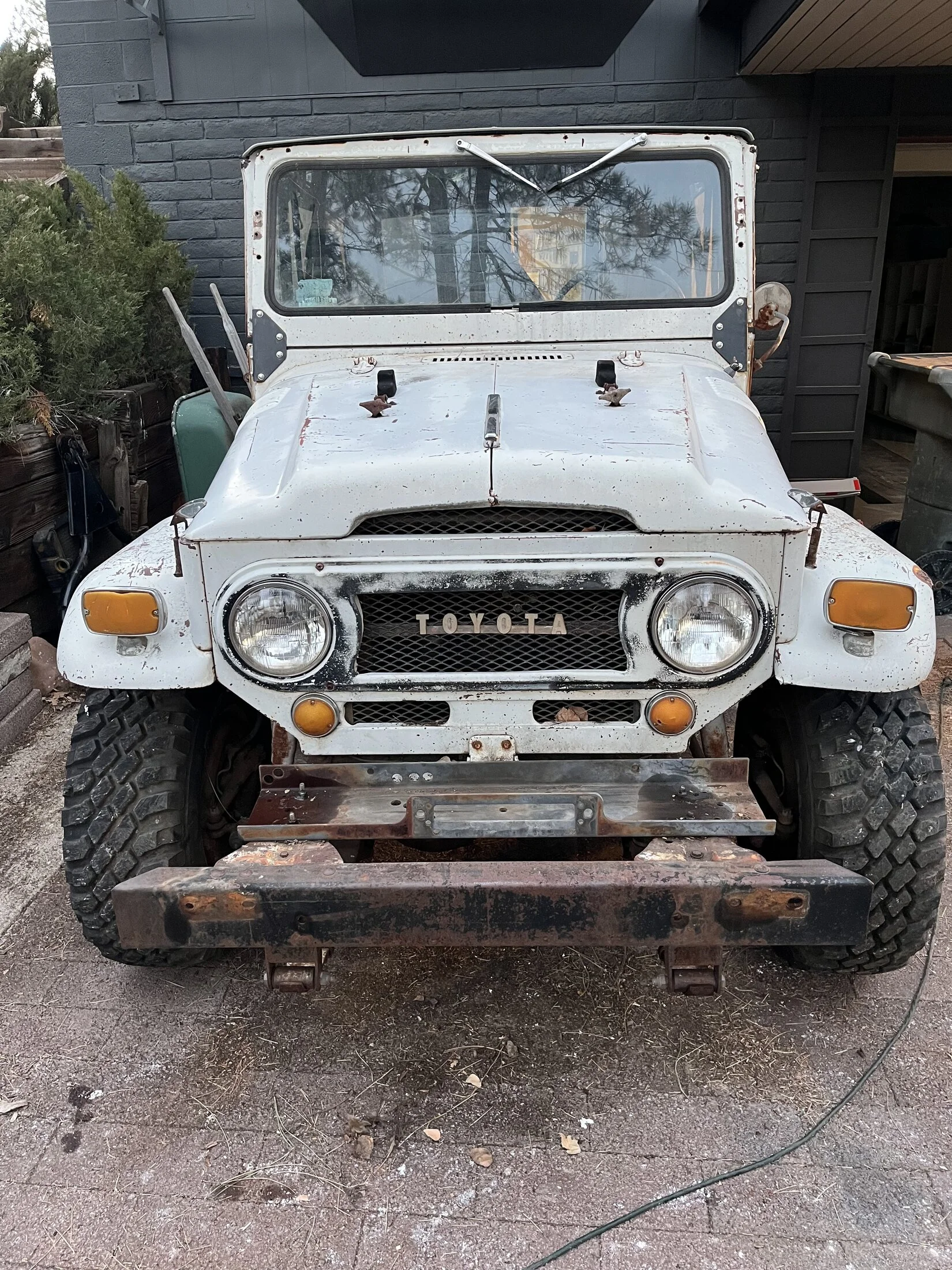

Some progress today: tow bar (Smittybilt) and cheap winch (Champion), A pillar lights (KC Daylighters) and brackets removed. Wiring cleaned up a bit, hard doors were test fit as well. Pounds of detritus removed, and a collection of old brass, and rusty tools were reclaimed from the floorboards. Probably a similar story from the Cruiser’s this group had rescued in the past.

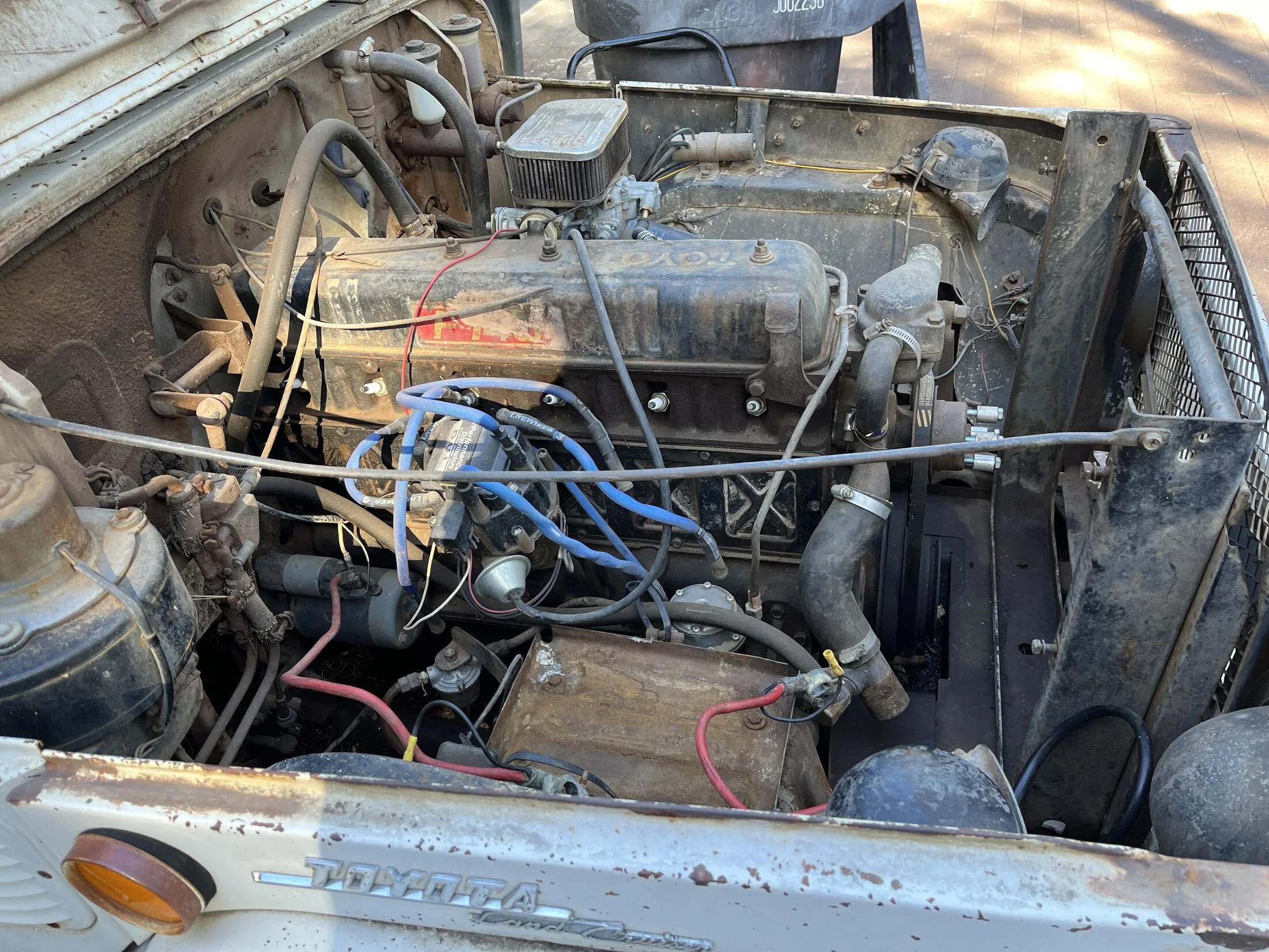

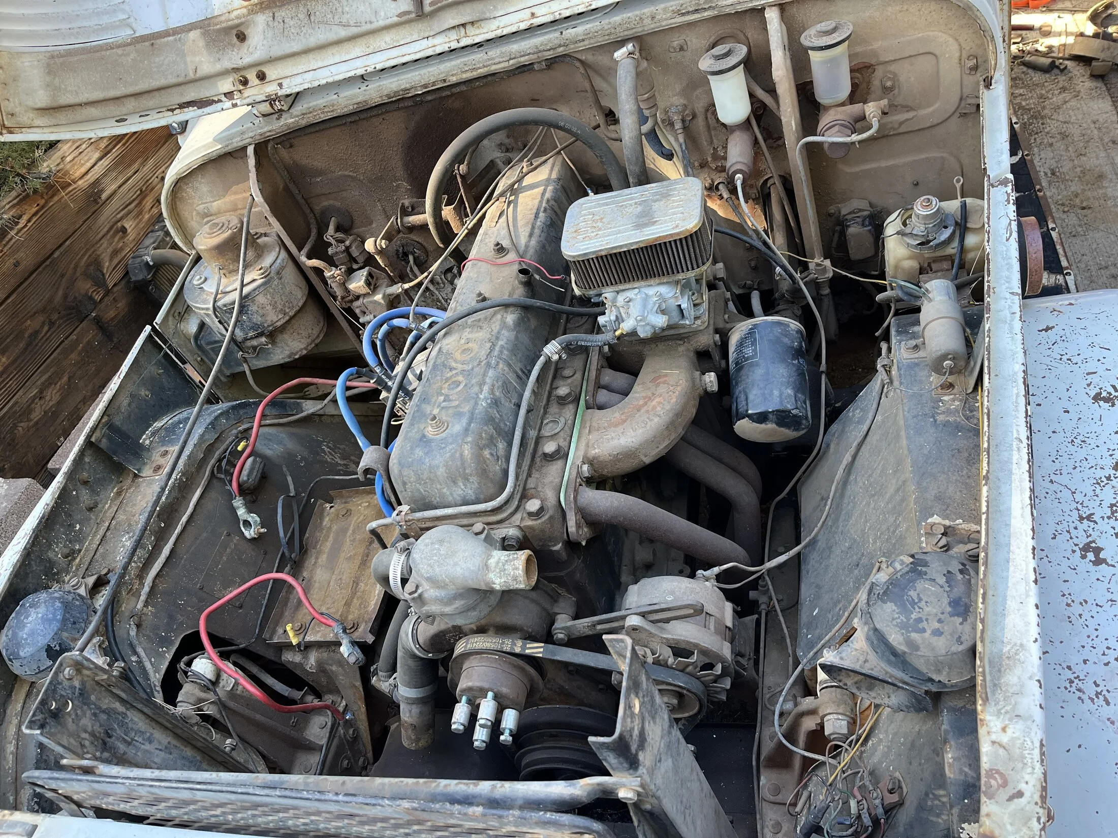

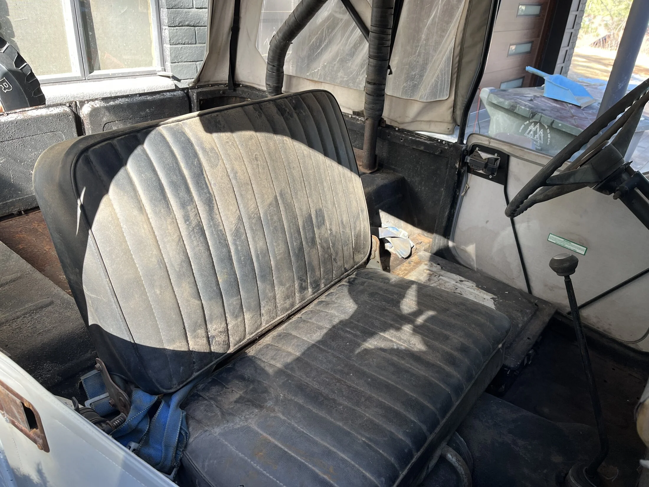

The F 145 has a Weber 2barrel that was fitted sometime in the 80s (?), and the driver’s seat (allegedly from a Corolla 🤣, was easy to remove, as it was merely sitting on the under seat storage box with nary a bolt to keep it secure.
6 plugs, plastic fan, the belt, and the radiator (CSF) were easy to remove, and MMO was deposited in the space formerly occupied by the Denso plugs. Hoping it can work its magic so this “seized” motor can be turned by hand in another week or so.
You might consider pulling the distributor and prime the oil pump too.
As expected, time has been in short supply. However, I did find time to get a cover to protect Inyo while she lingers outside, waiting to be fixed. I was able to secure a 46 mm/ 1 13/16 socket, not easy to find locally, and I had to resort to Amazon. Two days later, with my new socket, my suspicions were confirmed at the engine is seized. I spun the crank bolt off easily… and this prompted further investigation.

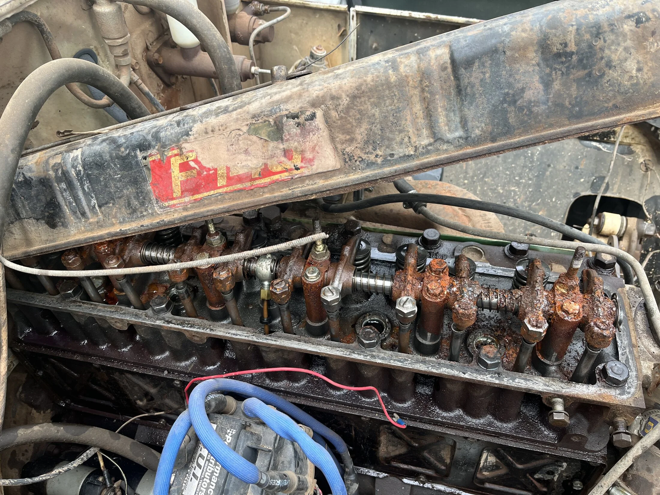

I pulled the valve cover, and found this mess: looks like the valve springs are still in good shape, but the rocker arms are pretty crusty. Penetrating oil applied, hood dropped back down and covered up in preparation for a snowstorm on the way. In two days I leave on vacation for a week with the family, but when I return, more work on the top end, likely pulling the head, and of course investigating the bottom end (pull oil pan to inspect) to see if any of this is even worthwhile.

Interesting. It will look totally different after you get some of that rust removed.

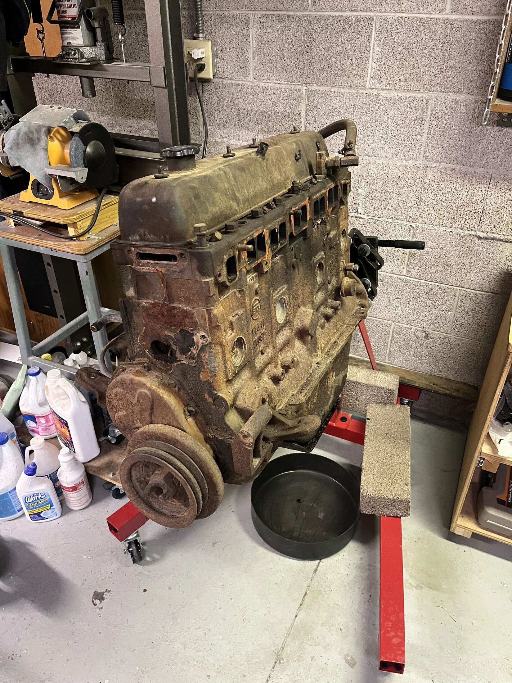

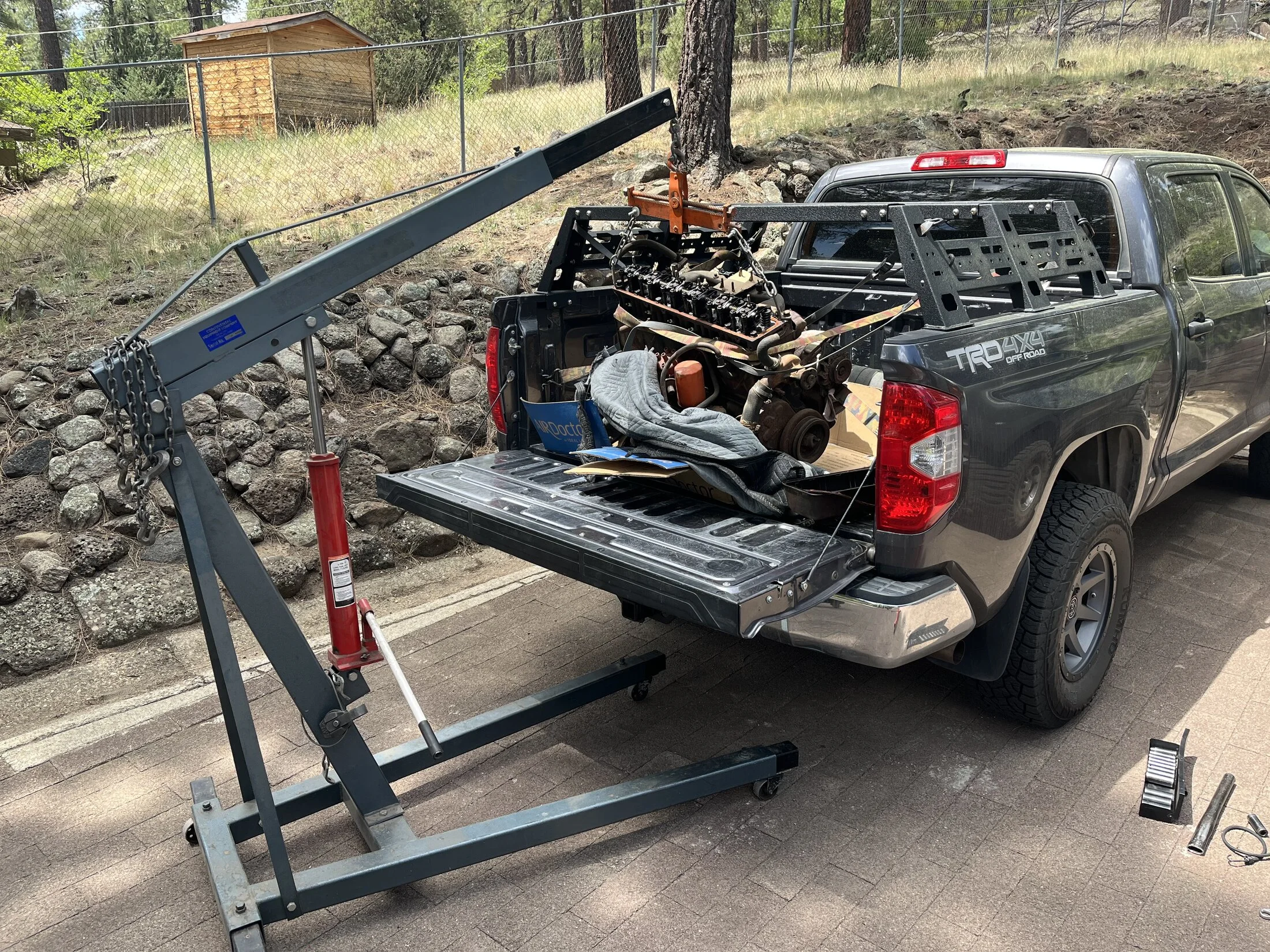

I also picked up a spare 1.5 F engine that was originally in an FJ 55. This one is plenty crusty on the outside, but is running. So, the plan is to do a quick cleanup and reseal, and install… While I properly rebuild the 1F that is currently under the hood. The engine hoist made quick work of getting it out of the Tundra, but my Harbor Freight engine stand was a little overtaxed… So some counterweights, and removal of the manifolds, alternator, water pump, etc. was necessary to get it to safely balance that heavy inline 6 on the brand new 2 ton HF stand.
An unexpected win came from the guy I purchased the replacement engine from… He threw in a two piece rocker arm assembly that should remedy the crusty one that is currently installed under the hood.🙏

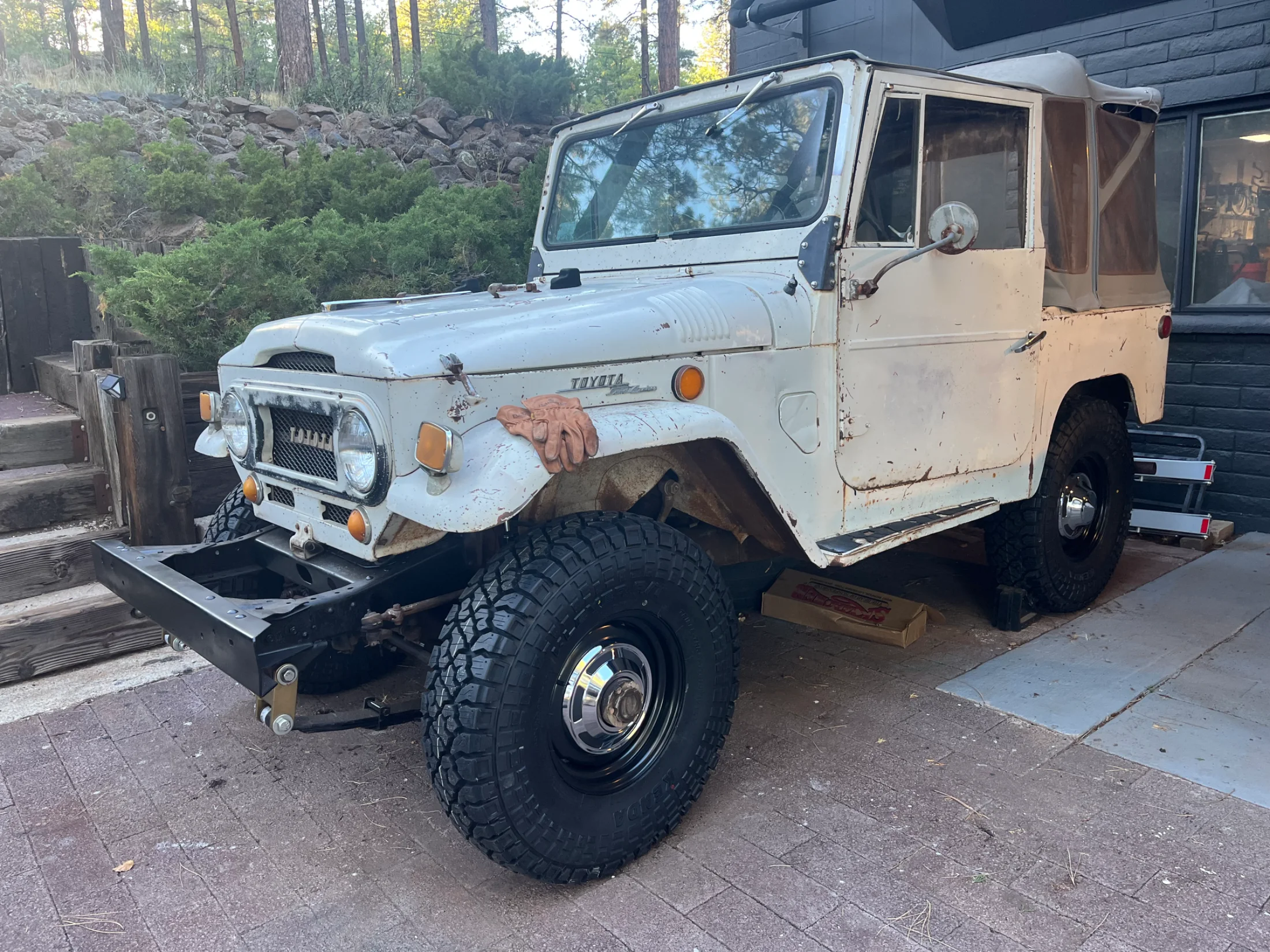

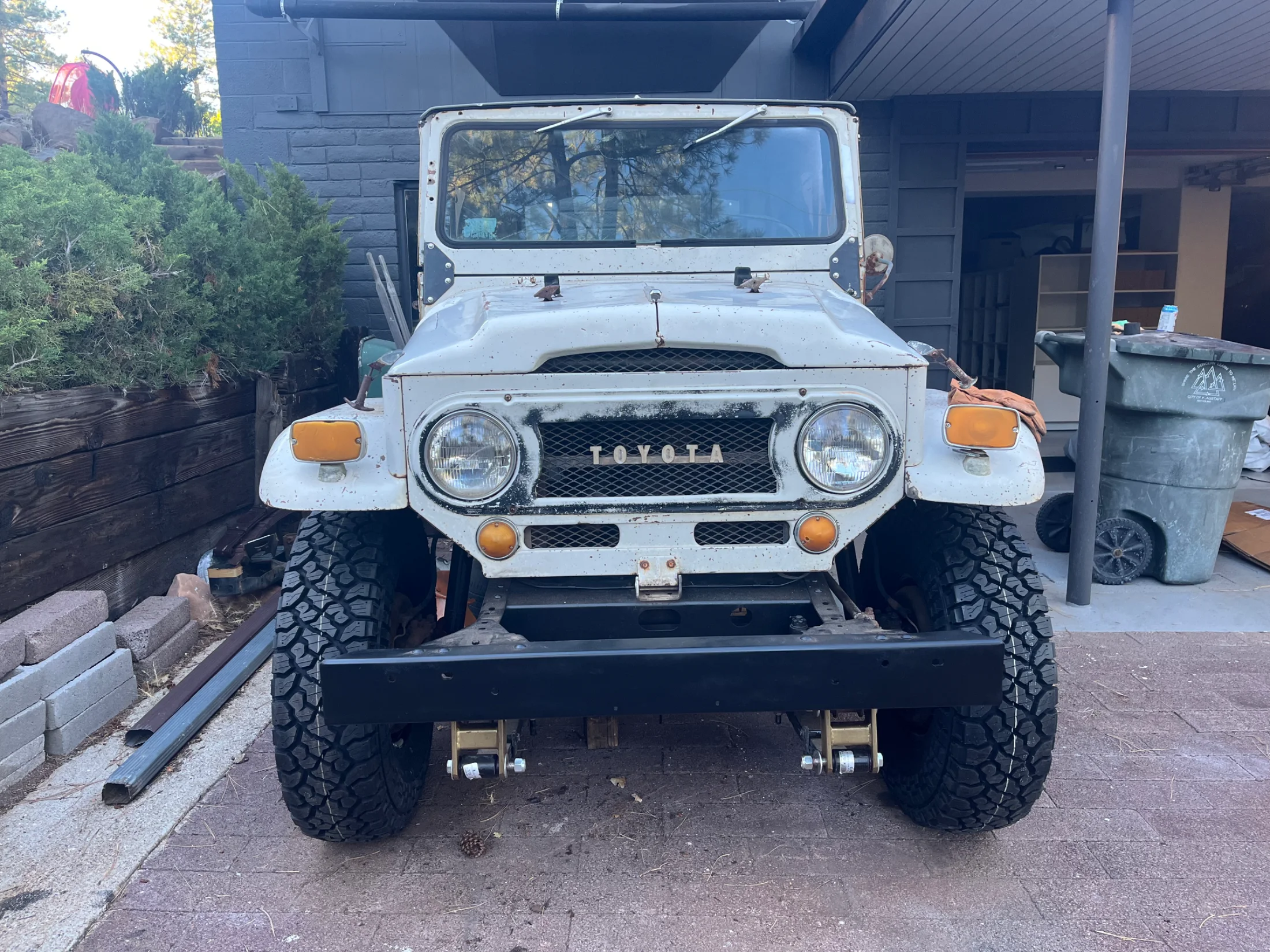

It has been quite a while since I have offered up any updates to the post, so today is the day! I went with Skyjacker 2.5 inch front and rear springs with their BlackMax shocks, and some hand-me-down Performance Accessories shackles that I got from at @peacesells63 . This should net me about 3 inches of total lift. I haven’t done the suspension upgrades on the rear yet, but I figured enough progress had been up front, to allow me to mount up the new wheels and tires. Kenda Klever R/T 33 x 9.50s on Toyota steelies, with crisp new hubcaps. Gives me an idea what my final ride height/stance will be. And I’m definitely encouraged! She will be a patina-queen when she’s done, but new shoes make everything look better!
