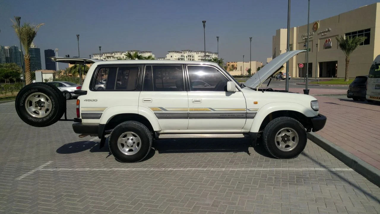

Today at 9am I met the seller at the Road and Transport Authority's testing station inside a shopping center parking lot for the pre-title transfer test. Coincidentally, he drove up just as I was arriving:
full
And here is the truck in the testing center:
full
The truck passed the inspection with no issues and we went upstairs for the title transfer, which took only about 20 minutes, including the time we were waiting for our number to come up. And I became the owner of El Wahsh. I had asked the seller if he didn't mind showing me a couple of the parts places he had talked about, and he had the time so we headed North, past the Burj Kalifa:

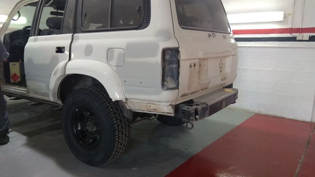

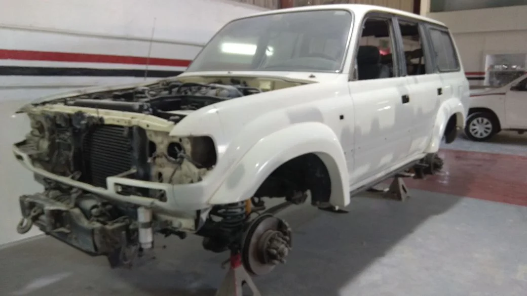

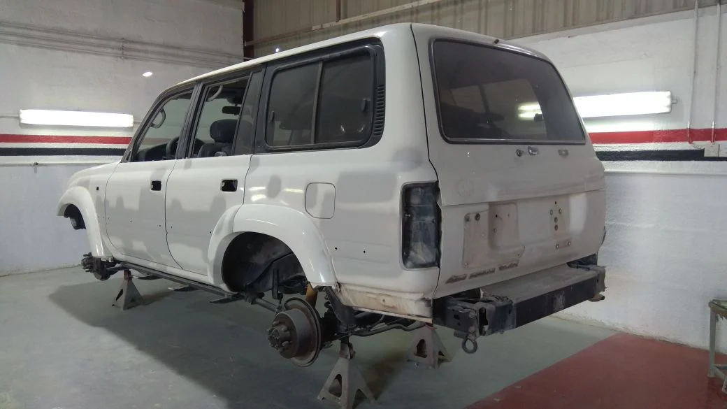

Hi all, El Wahsh is moving along. I ultimately decided to ditch the OEM decals which neither my son nor I liked. The truck is in the middle of a repaint as can be seen here:
full
full
Note the factory winch!
full
full
Not a speck of rust near as I can tell.
Repaint is the best solution for removing decals. I pulled the after market decals from my white 97 and it still left noticeable shadows in the paint. My solution was to spend lots of time driving thru the bush in Arizona deserts. Now my paint is well blended.

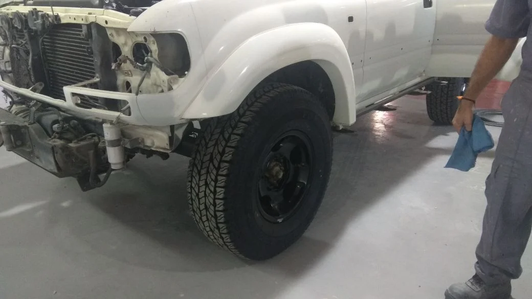

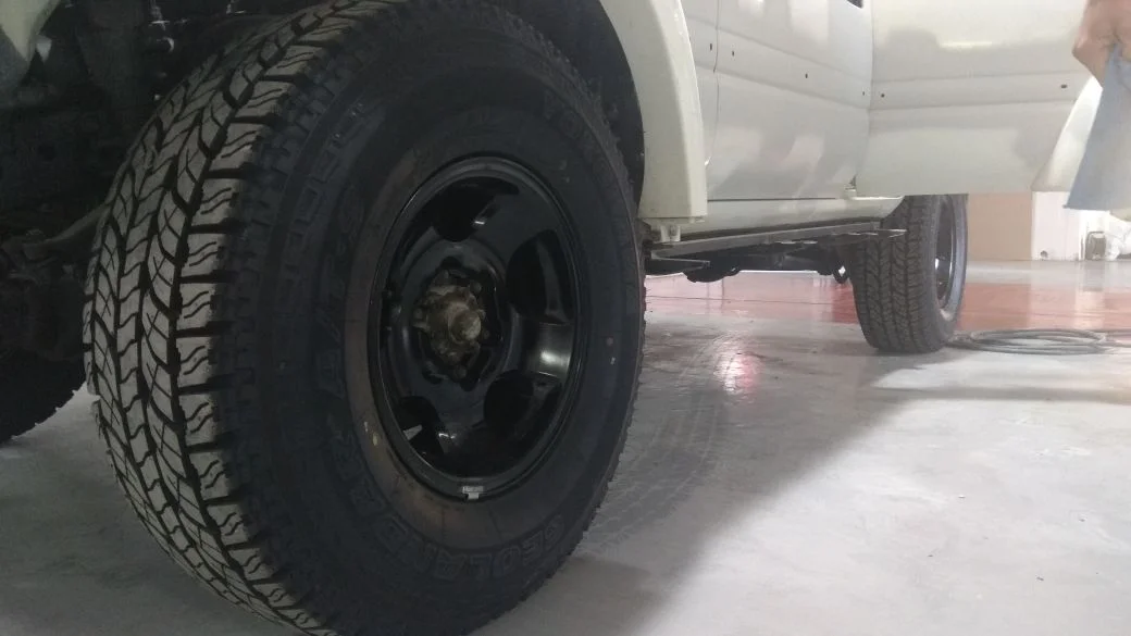

So the wheels are back, repainted and with new Geolander tires as well! Slightly oversized. I went with 285/75 R16's

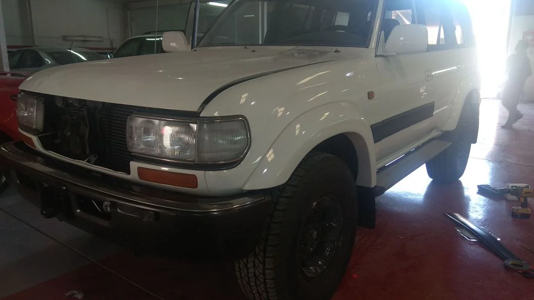

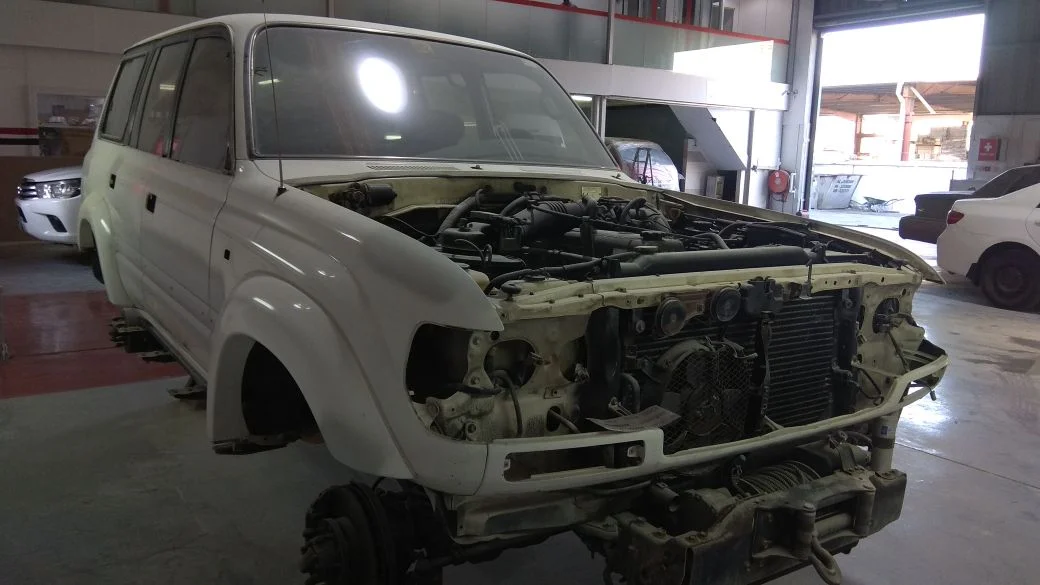

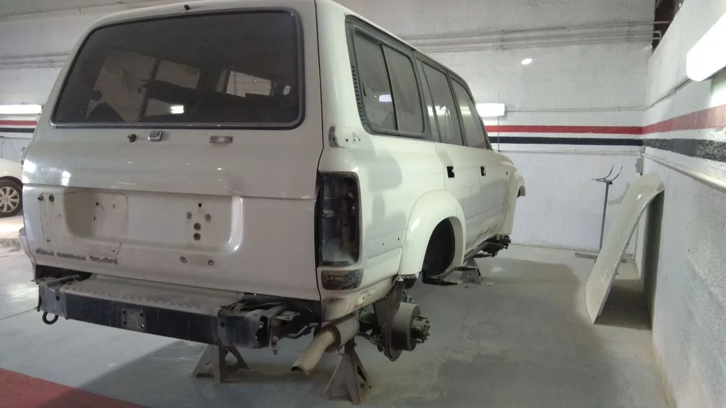

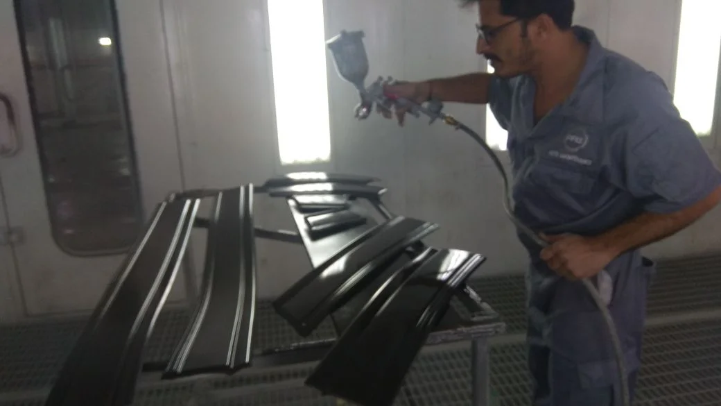

The repaint and other repairs are rolling along. Here are a few photos:
full
full
full

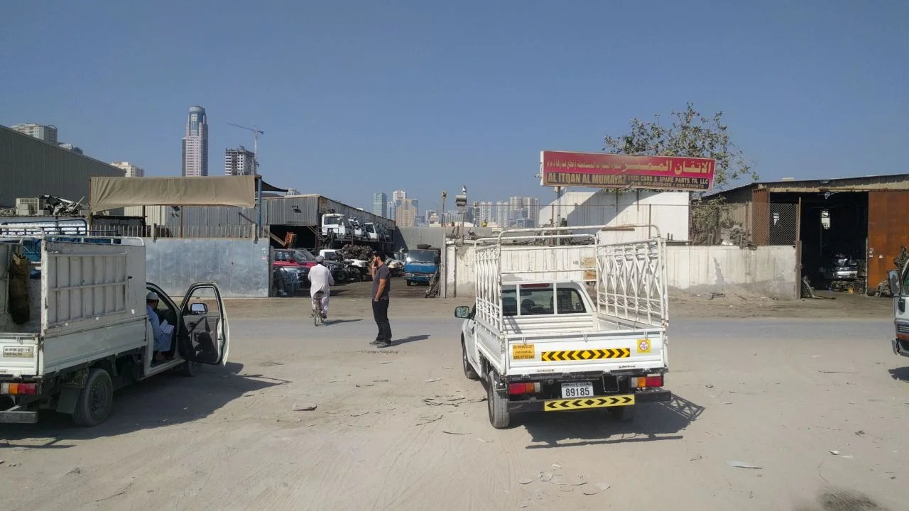

Also went to the salvage yard today for some trim and nicer turn indicator fixtures.

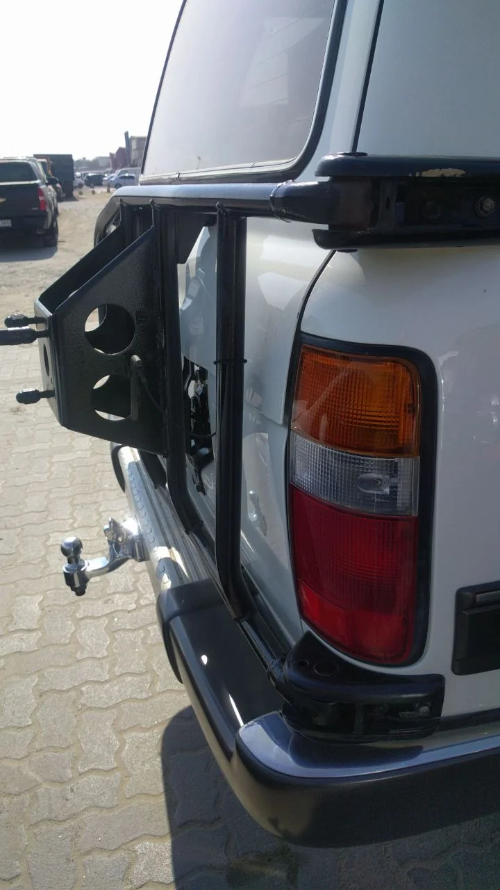

And finally a mystery:
full
This looks to be in the rear hatch, but I can't find any mention of a knob in any of the manuals. Does anyone know anything about this? I'd think it would be a standard size. It's busted as you can see. If anyone knows the size or what I can use as a substitute that would be stellar!

When I had my 60, it was a standard golf tee looking knob. My European spec'd 80 doesn't have that.

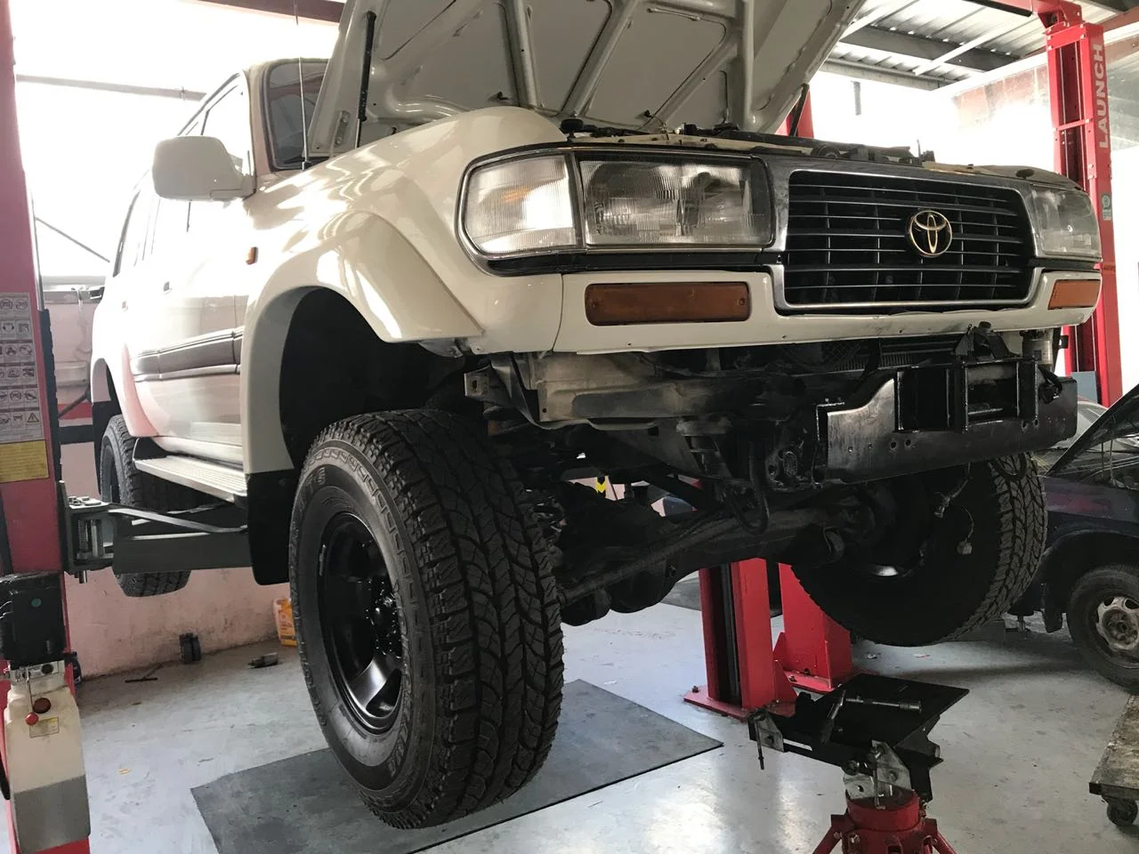

We are getting close, oh so close, to getting El Wahsh out of the garage and able to drive around for a while to shake it out.

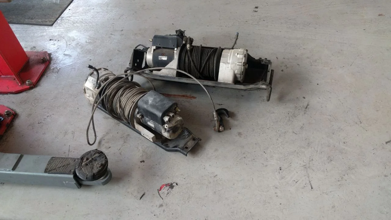

Lots of little problems. For example, the truck came with a factory winch, but not the factory control wand for the winch. I found a Toyota control wand as discussed here. But when it was plugged into El Wahsh it did not work. Fortunately I had acquired another toyota factory winch with the intention of putting it on my American spec 1998, so I had a spare at hand to give to my mechanics.
full
full
The cleaner one came from the salvage yard in Sharja. When they told me that the winch was not working I suspected it was an electrical problem. The winch itself had not been used much since the truck was new. The first owner was a British expat, and the second was also someone who commuted in it and used it for desert fun. Anyhoo, PAB Auto Maintenance fooled with it for a while can came back with the message that they had fixed El Wahsh's original winch. All this taking a couple of weeks, which is fine.

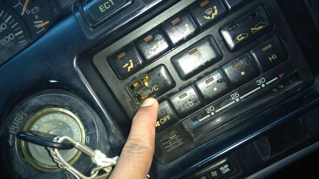

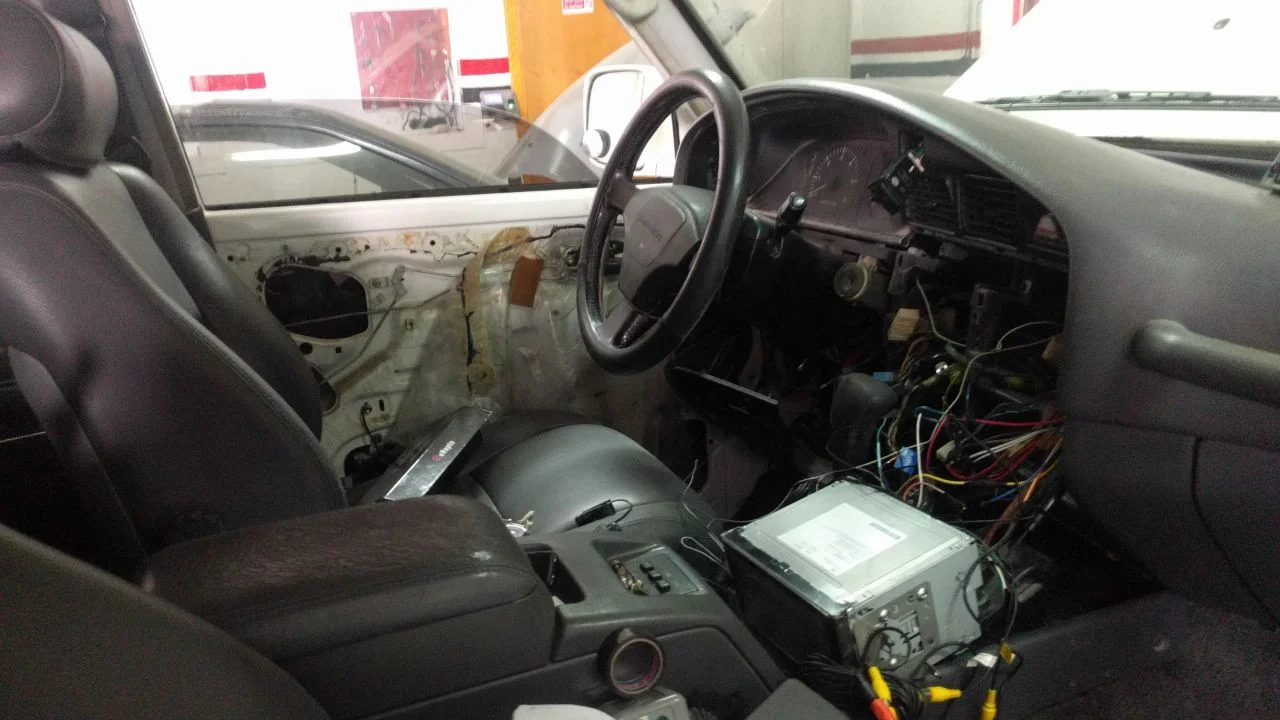

That taken care of, it was down to a bunch of dashboard issues, including busted switches.
full
Ugly, right?

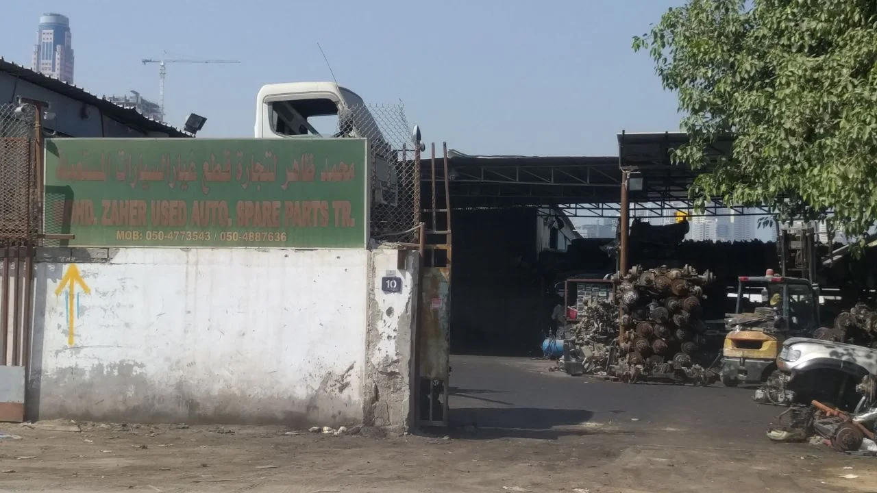

So back to the salvage yard for a bunch of less disgusting switch gear, which I cleaned up and PAB Auto has now installed. At this point I have become anxious to drive my truck. I actually sold my gulf spec 2001 because shuffling 3 land cruisers around Dubai is a bit excessive, even for me, and I want to play with my new toy. I had intended to install myself a new 2-DIN JVC unit which I had bought in the US, but at the last moment I decided to let the guys do it for me and also install the camera and more importantly the wiring to the camera.
full

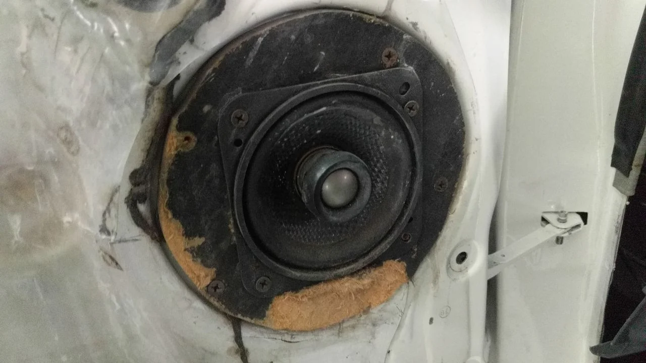

When the guys got the head unit in they discovered that two of the four speakers were dead. Not too surprised when I took a look at the butchery done in the past:
full
So night before last I ran off to Dragon Mart and got the best couple of speakers I could find that will fit the space in the front doors. Basic Kenwoods sold for 25 USD per pair on Amazon, just to get El Wahsh up and running. Today I will go back to the salvage yard and see if I can get the rear speakers.
That knob is the lock/unlock knob for the rear hatch. It allows you to unlock and open the hatch from inside if needed.
