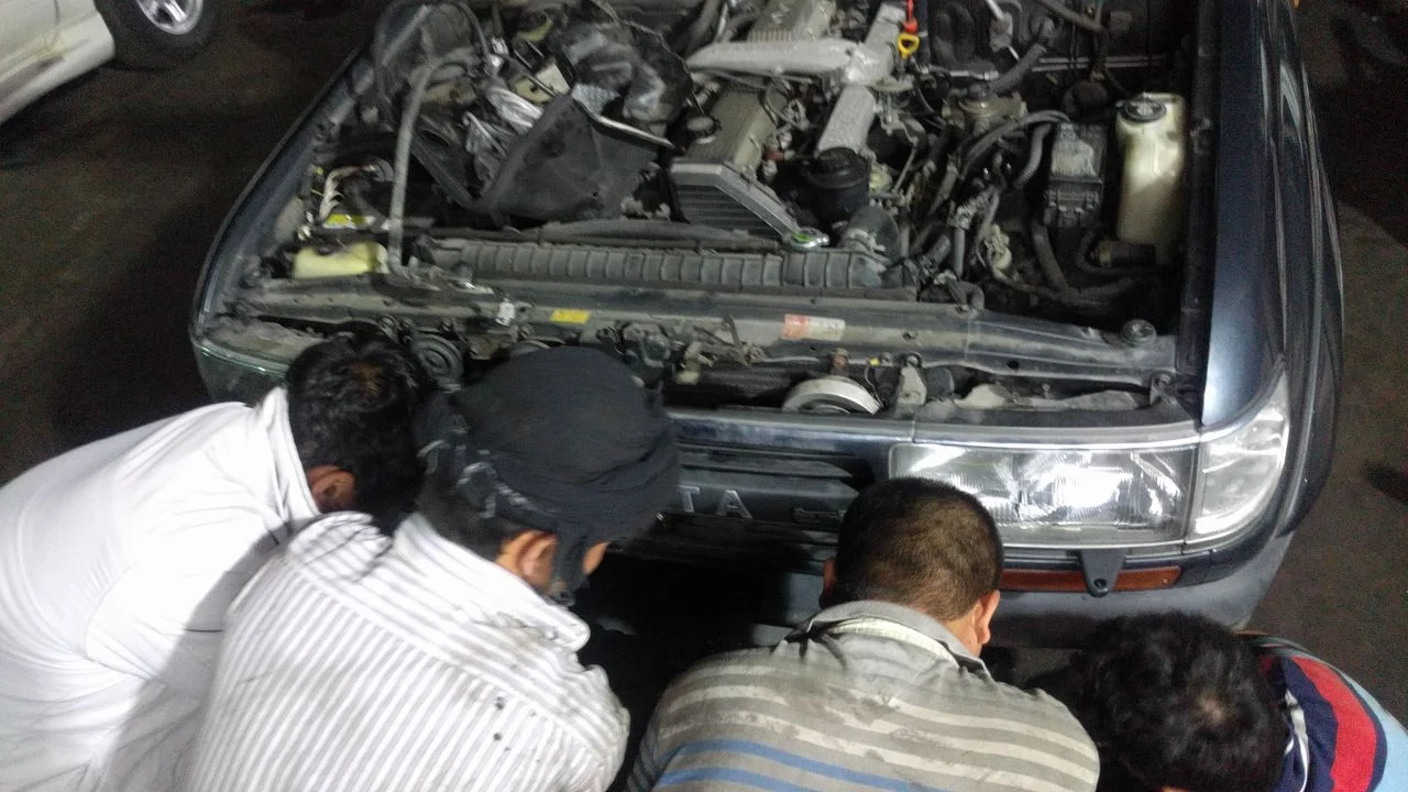

That is a diesel right-hand drive from Japan most likely. Wish I could swap engines, but then I could never import El Wahsh to the US. Good clean truck being parted out. Just came in to the scrap yard. Engine ran very well--they turned it on while I was testing that beautiful winch!

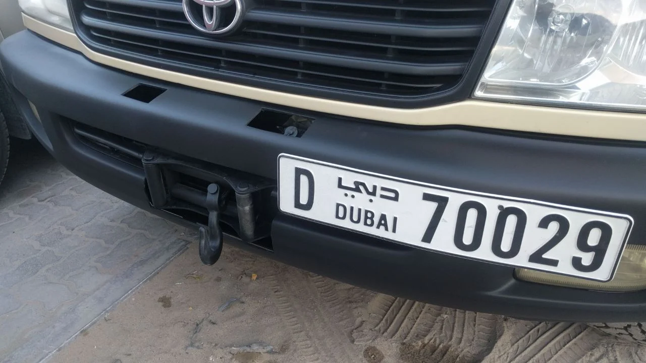

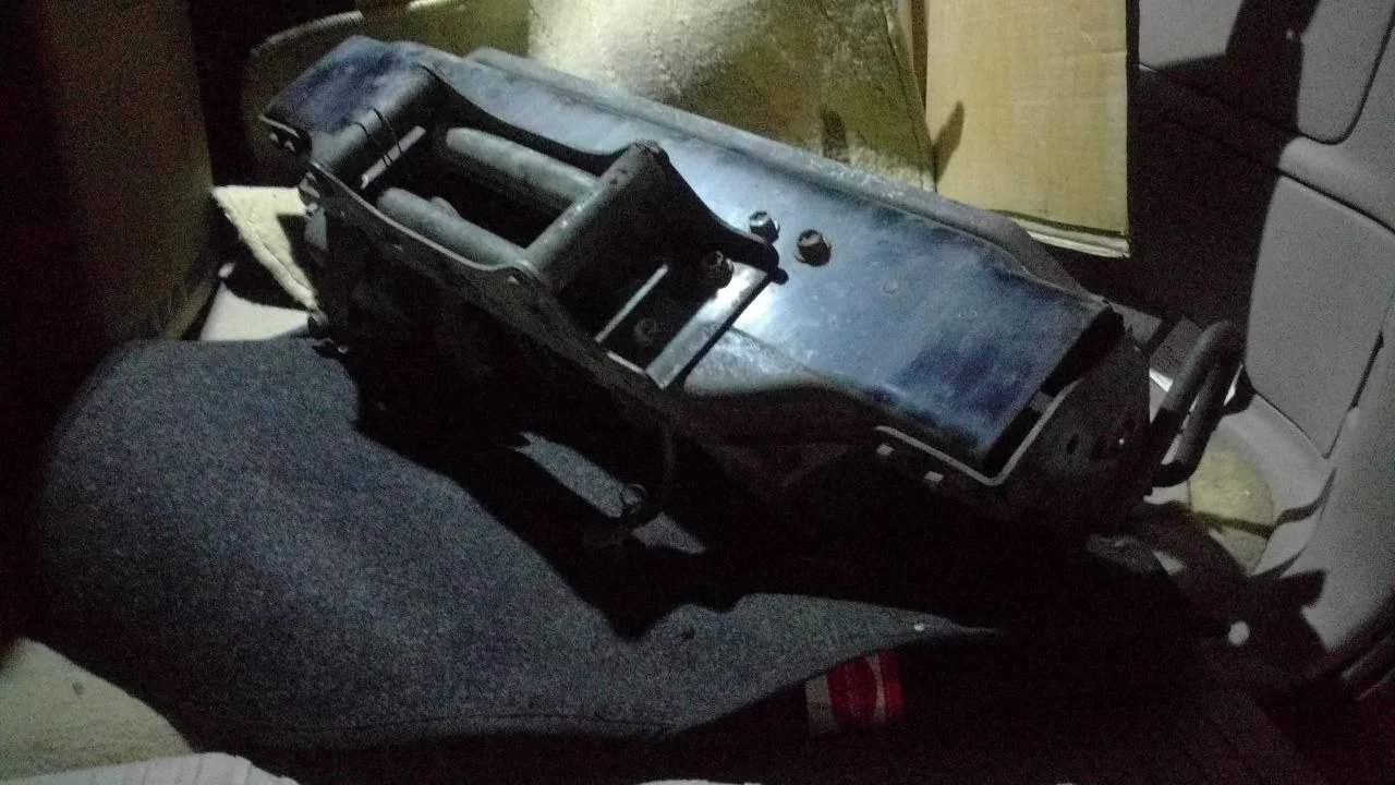

Here is the winch in the back of my 1998 model 100:
full
full
So here's my question submitted to your collective wisdom: Does anyone know of a mounting plate for a model 80 factory winch for use on a model 100 frame? I want to use this really nice winch my my 1998 but obviously the distance between the rails is different on the 80 and the 100.

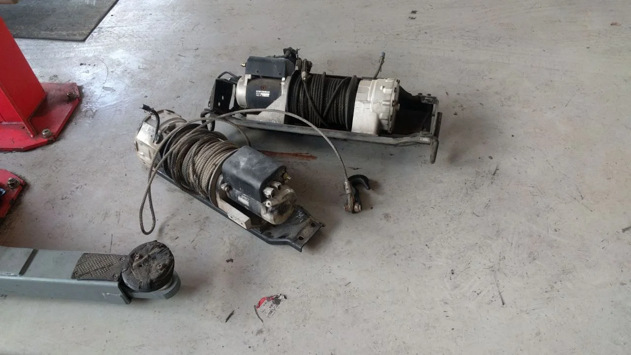

Pair of OEM winches--one that was originally on my model 80, the other from the scrap yard.

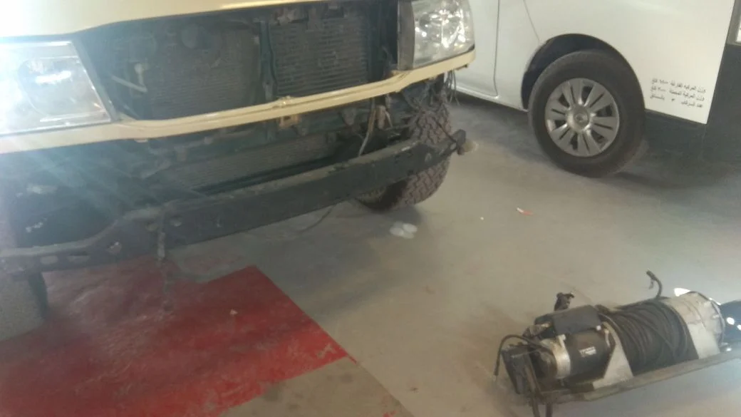

Getting ready for the install.
full
Modifying the Model 80 bracket for a model 100. The model 80 was wider as I recall.
full

I will go back and check, but I don't think so. However, once the weather warms I will be taking the plastic bumper off to put it back in the clips and will take some photos then. The truck is now in Northern Virginia where it is quite cold and the plastic is pretty inflexible. Here is the only shot I have while the guys were working on it in Dubai, already posted above:
