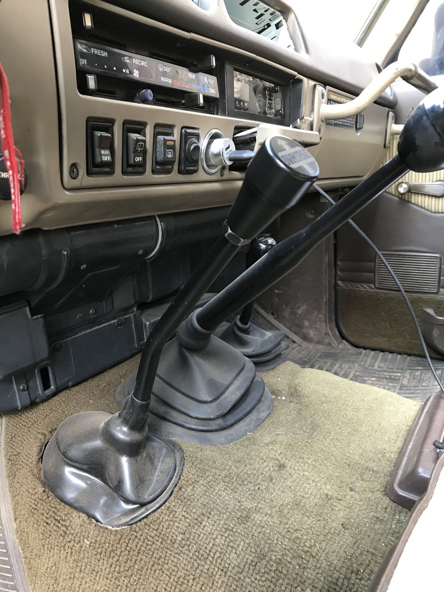

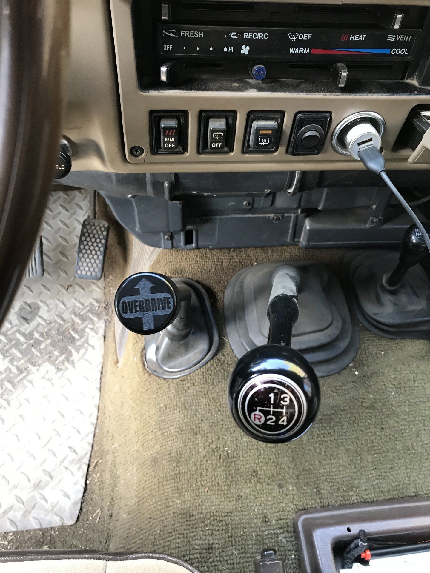

My Ranger shifter is on a bracket off the tranny, it comes up next to the 4-speed shifter and uses a rod to actuate the Ranger.

cut a hole just south west of my stock shifter. Give up on trying to make the handle a straight shot off the splitter, you’ll need some made linkage otherwise it’s gonna land in your hvac ducts.
just a short piece of metal and bushings will work for linkage

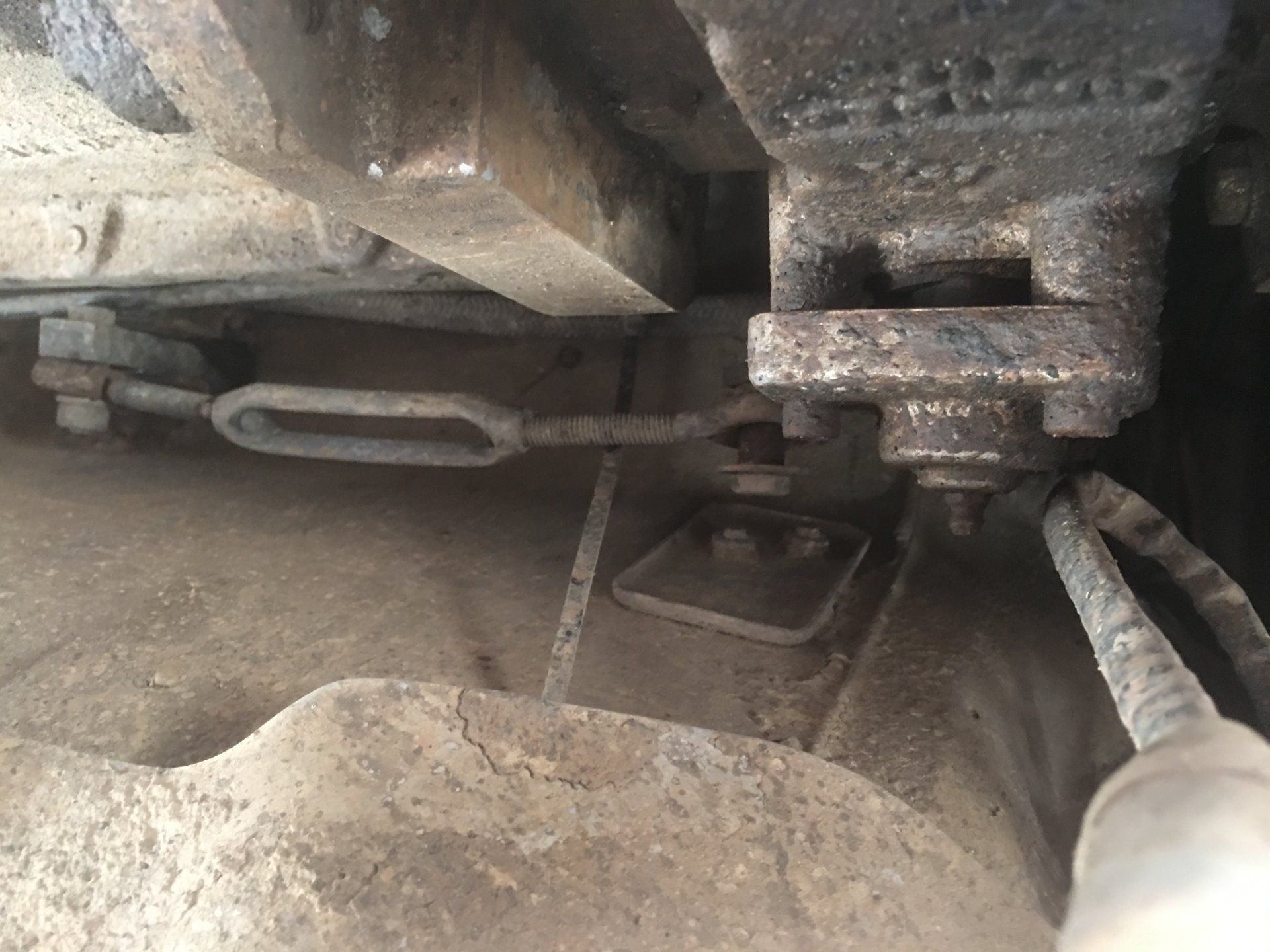

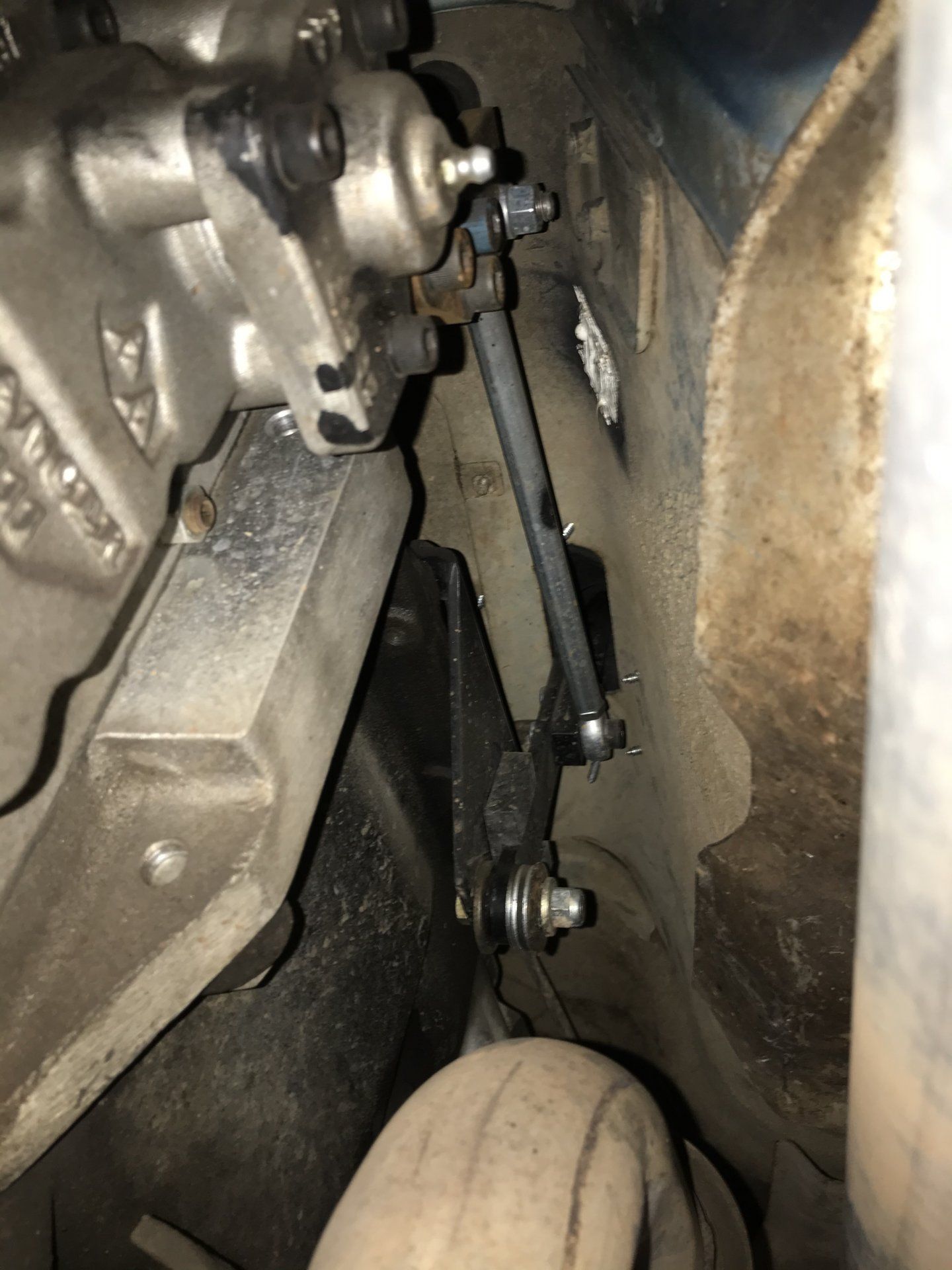

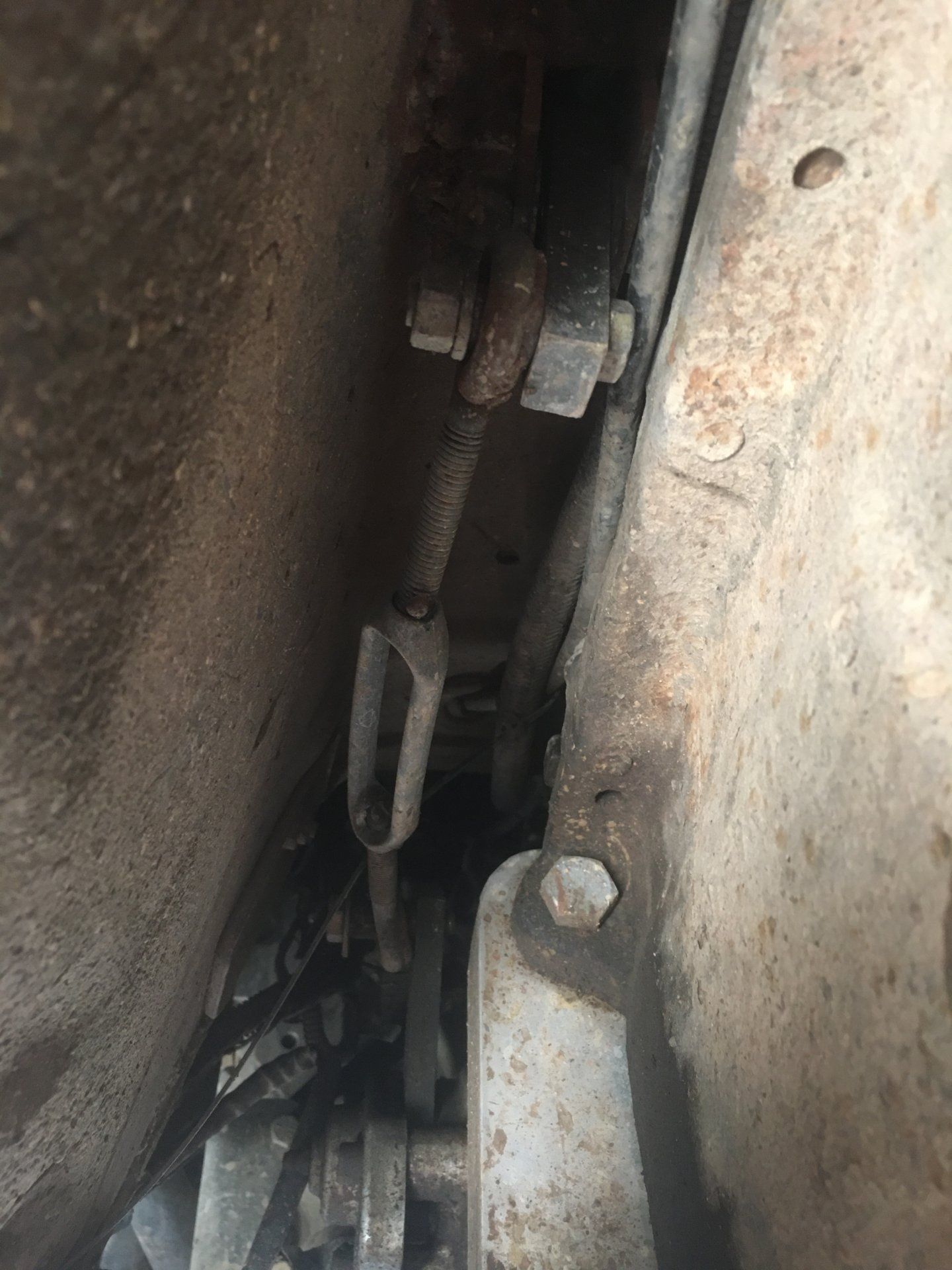

made a bracket on the body for the shifter to pivot on
been on there a solid 60k miles now, could be better And will redo later in life but it works. Needs a Beefier turn buckle
put a bushing inside the eyelet for the turn buckle so you can tighten it all down tight and still have a clean pivot points.
turn buckles works great, they are adjustable and can adjust the slack or lever to wherever you want it

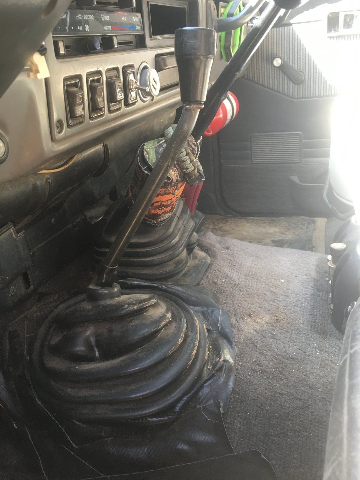

Don’t mind the tape, never got around to mounting the boot. One of those here’s something quick to do a test run and make sure it works and well it did..... one of these days
Thanks for the pictures. Did you add a bracket on top under the boot to keep it from falling through?
