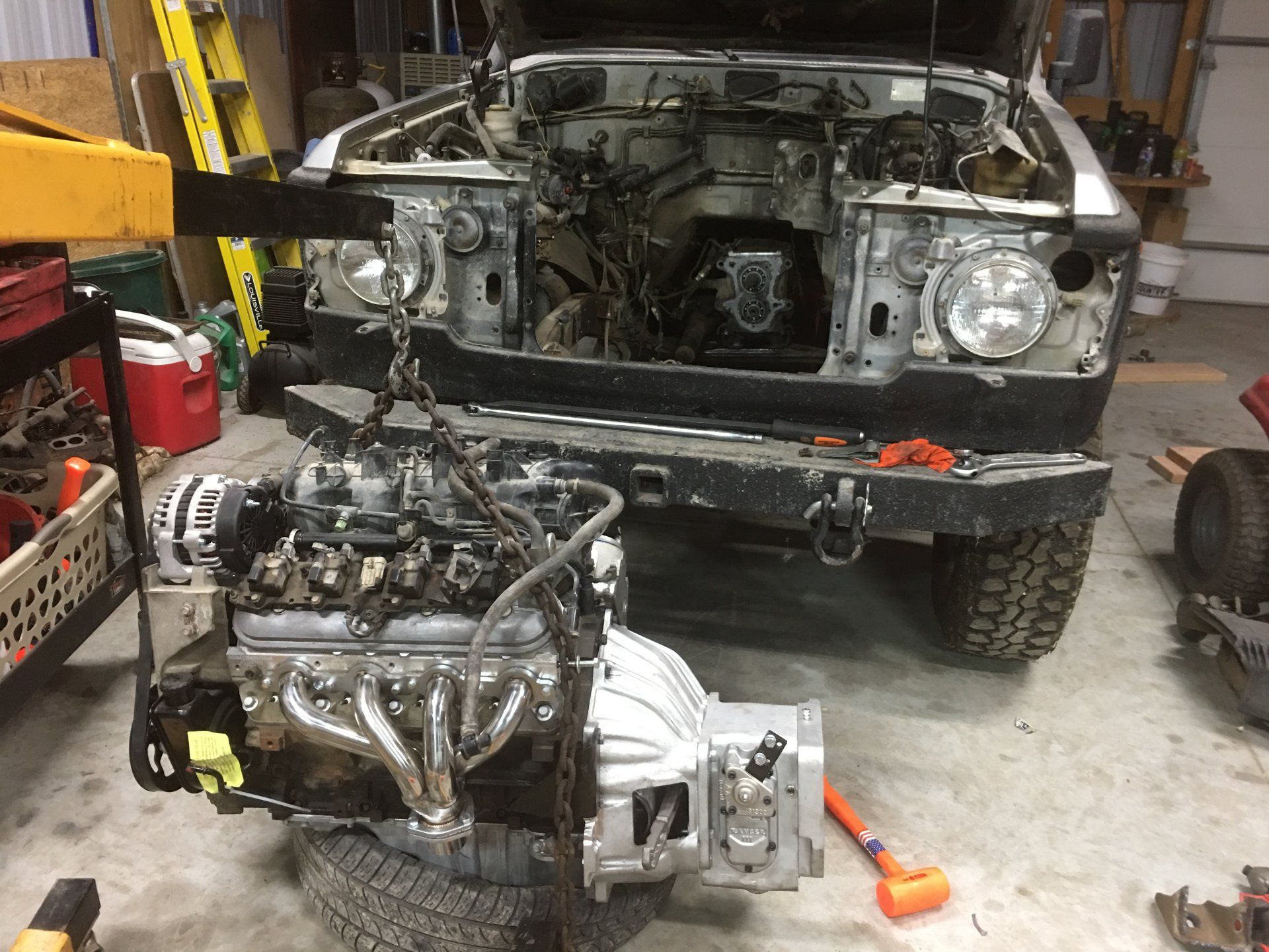

That body looks Sweet!! I’m in ‘burque also and crawling through an 83 fj60 tbi v8 swap. Would dig seeing yours. What trans and adapter?
Its down in Peralta at my buddies right now. I may have to invest in a car hauler. I'm sure this wont be my last project.
The Trans adapter is an Advanced adapters/ Ranger Torque Splitter mated to a Rebuilt stock 4speed trans. Also a 4.8 Liter power plant. I don't know much about the Ranger, but I'll get some pictures of it this weekend. My google fu has not produced much by way of how tie them together.

SBC bell housing is all you need to tie the 4.8 to the Ranger. I used an LQ4 flywheel and clutch.

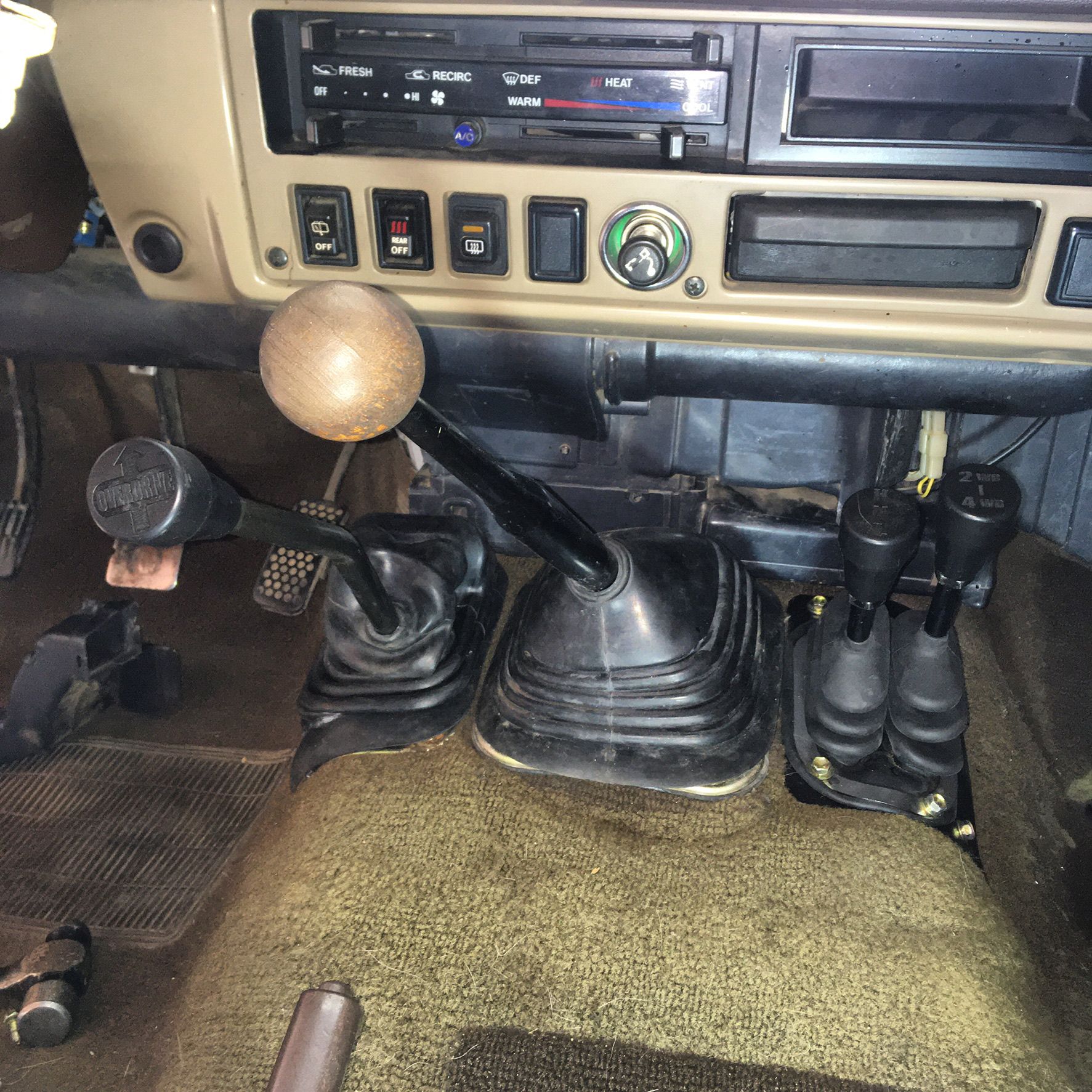

Sorry for the miss statement, it is mated now with what i believe is an advanced adapters set up. It appears I'll need to add a path for it to actuate. and have 3 sticks in the truck. Never seen this in action so will be interesting.

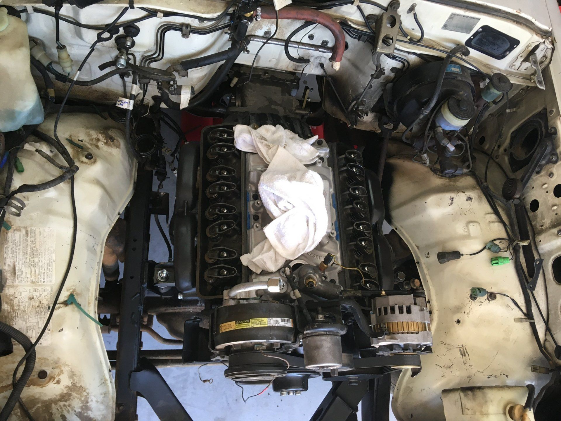

Crazy! Mine is also LC 4speed, a ranger to the Chevy bellhousing, supposedly 88 blazer, twin sticks. 1983... apparently this year’s crossmember is further forward which mashes my water pump up to the radiator. I’d dig seeing where your ranger sits, if it’s mounted up.
Crazy! Mine is also LC 4speed, a ranger to the Chevy bellhousing, supposedly 88 blazer, twin sticks. 1983... apparently this year’s crossmember is further forward which mashes my water pump up to the radiator. I’d dig seeing where your ranger sits, if it’s mounted up.l

Crazy! Mine is also LC 4speed, a ranger to the Chevy bellhousing, supposedly 88 blazer, twin sticks. 1983... apparently this year’s crossmember is further forward which mashes my water pump up to the radiator. I’d dig seeing where your ranger sits, if it’s mounted up.View attachment 2624783View attachment 2624784
Yup, I had to go with electric fans and the oil pan is wicked close to the front pumpkin.
was going to say i was jealous of your shop, still very cool of your buddy. the body seems to be in very reasonable shape, good score
Yeah that shop is insane. He's very generous to let me use it.
Are the electric fans triggered by a thermostat?
Yes, by the factory ecm.
I've been through your posts but don't recall now - do you use the Taurus fans or which?
I have all of 2 1/4" from the nose of the waterpump to the radiator core
4.8 and a ranger splitter
will put your motor smack dab in the middle of your engine bay.
plenty of room for fans.
I went electric and glad I did.... saved me a rad and still mobile after I hit an elk
next swap is a 6.0 and i will be moving the cross memeber so it sits all the way back in the engine bay

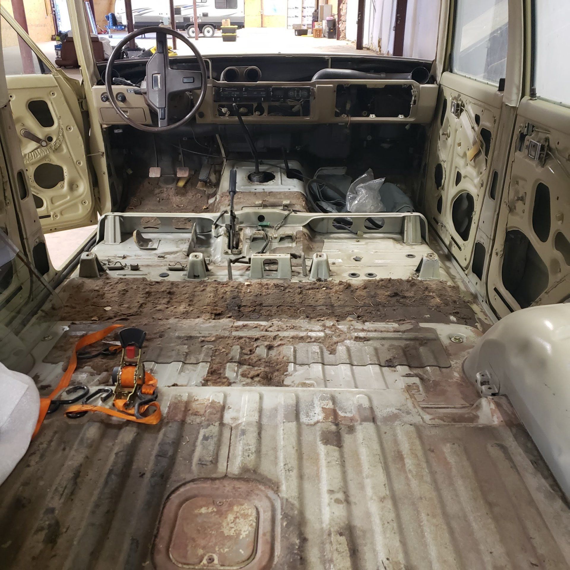

Where did you Cut for the Ranger to come through. Electric fans could be the ticket appears I may be short on space, and I do like that the Electric fans have their own shrouds.

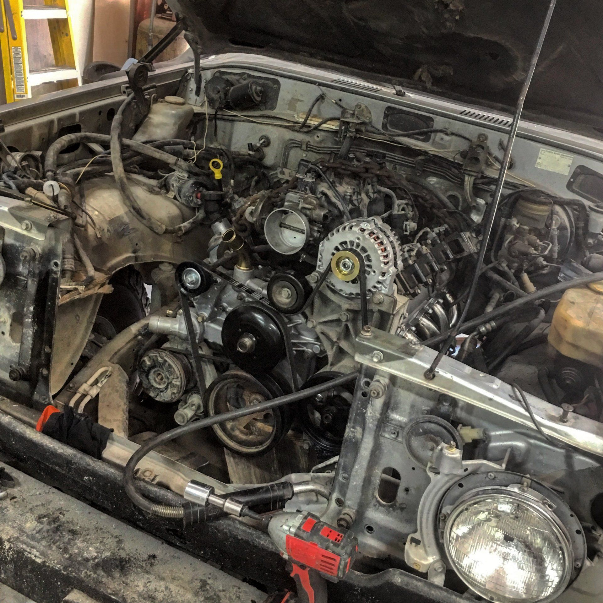

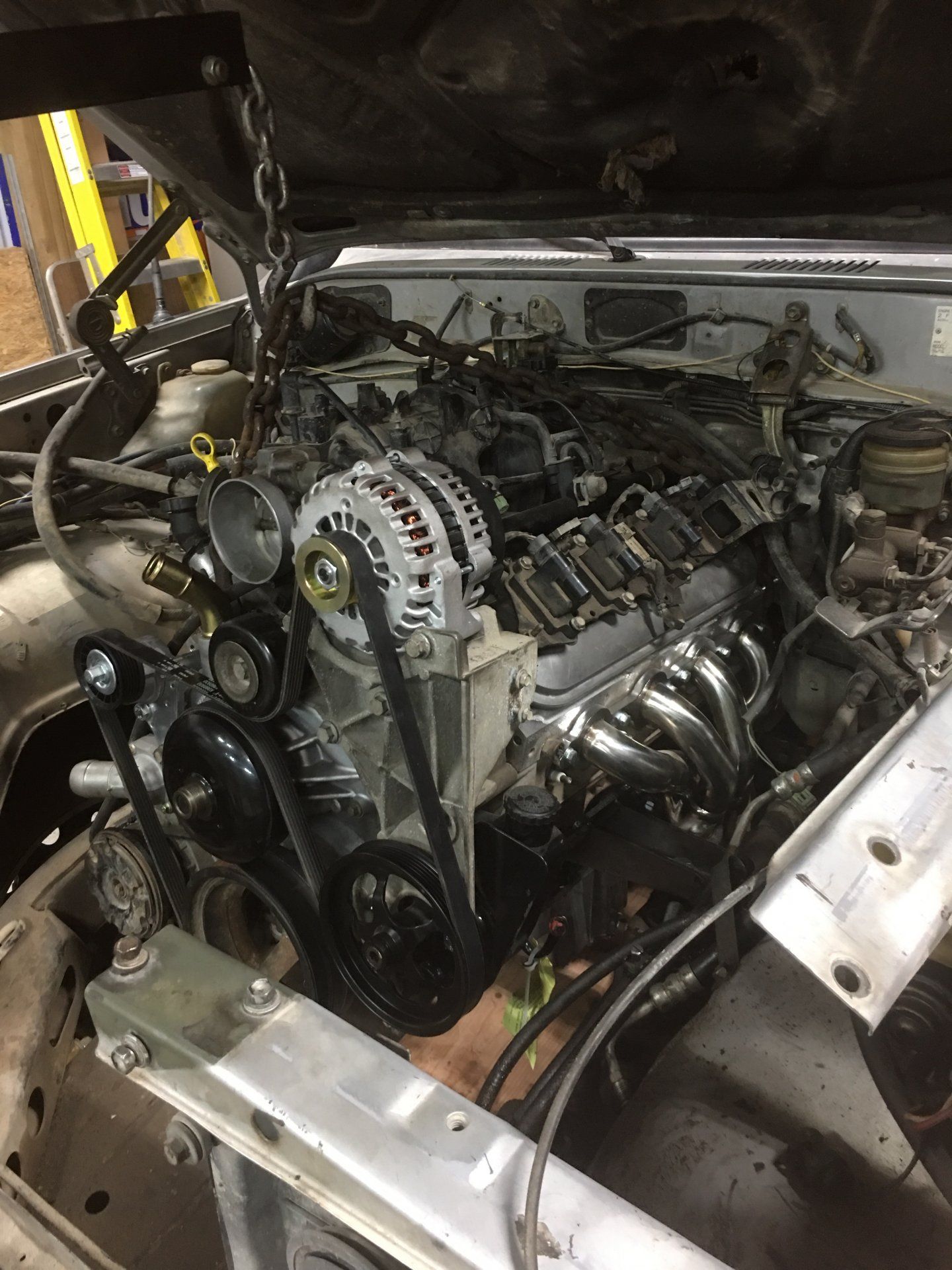

I went to take some more pictures yesterday and determine where the Ranger Shifter will enter the cab. I also went through some of the inventory to see what bits I'll need to order.
I have not come up with a plan of action yet but these pictures will give you an idea where the project is at.
